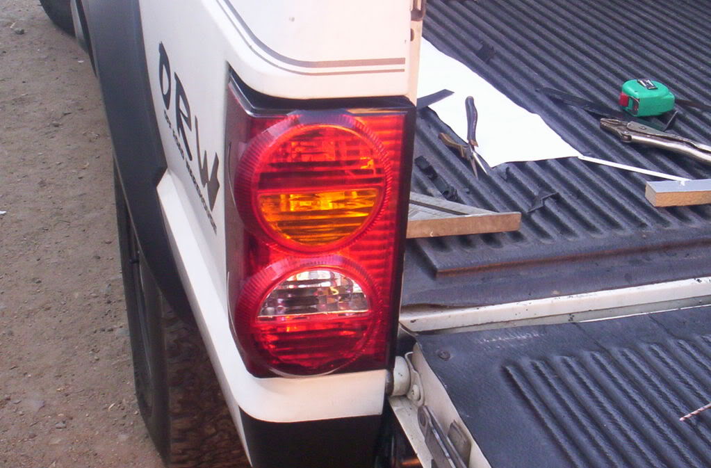

The moment we have all been waiting for...here is Cooreman's Ram lights in a Dakota!
If the lens is easily separable then possibly an aftermarket Ram tail light lens on a Dakota reflector/deflector housing would work!

yea the majority of those fixtures are smaller. that silver edge piece thats hitting the tail gate would probably be inward on a euro light.
now im having an issue finding the euro lights for his 1990 dodge ram
