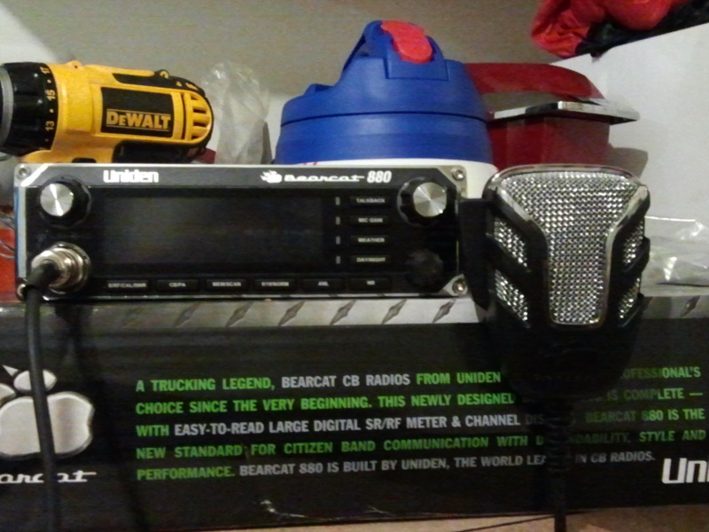

here are the pics you asked for
i removed my ashtray and made a bracket using the old rail guard for the top of the tailgate that was on the truck when i bought it using the same holes and screws that the ashtray mounted to
the radio is a uniden bear cat 880 its a cool radio its got 40 channels to talk on and 7 weather channels all digital display scan feature and norm 9/19 were it bounces back and forth between channel 9 for emergancy or 19 for the truckers i have day and night display and 7 colors to choose from and it wasnt badly priced either about 120 from amazon.com
