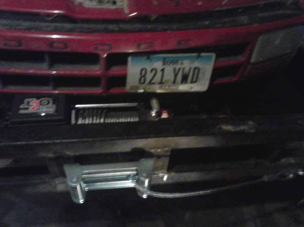

well i managed to get the winch "mounted" i would say its ready for use yet as i need to finish some welding for the brace beams and such on my bumper and clean up some other welds as well. and hopefully get the steel all cleaned up so i can get it painted! ( the steel was gave to me and was poorly painted prior) ill get pictures too when i finish all the wiring
