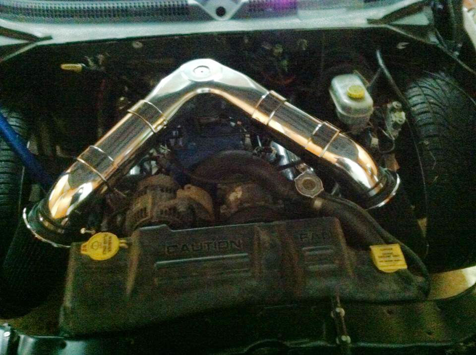

pinkfloydeffect's Avatar
pinkfloydeffect
Joined: Jun 2011
Posts: 858
From: Pinellas County, FL
Old Sep 14, 2013 | 04:45 AM
  #24
AZ 360 Dakota's Avatar
AZ 360 Dakota
Joined: Nov 2011
Posts: 285
From: Mesa, AZ
Nice design but your sucking hot engine compartment air with metal tubes absorbing engine compartment heat. Hook up a scan tool to see what the intake air temp is compared to a stock intake system parked next to it at the same time with the same ambient air temp.

I understand, not my setup just posted it for "ideas" I think I would prefer a boxed in setup.
