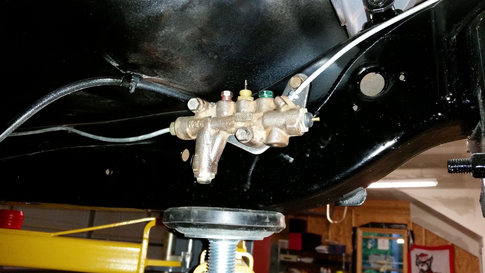

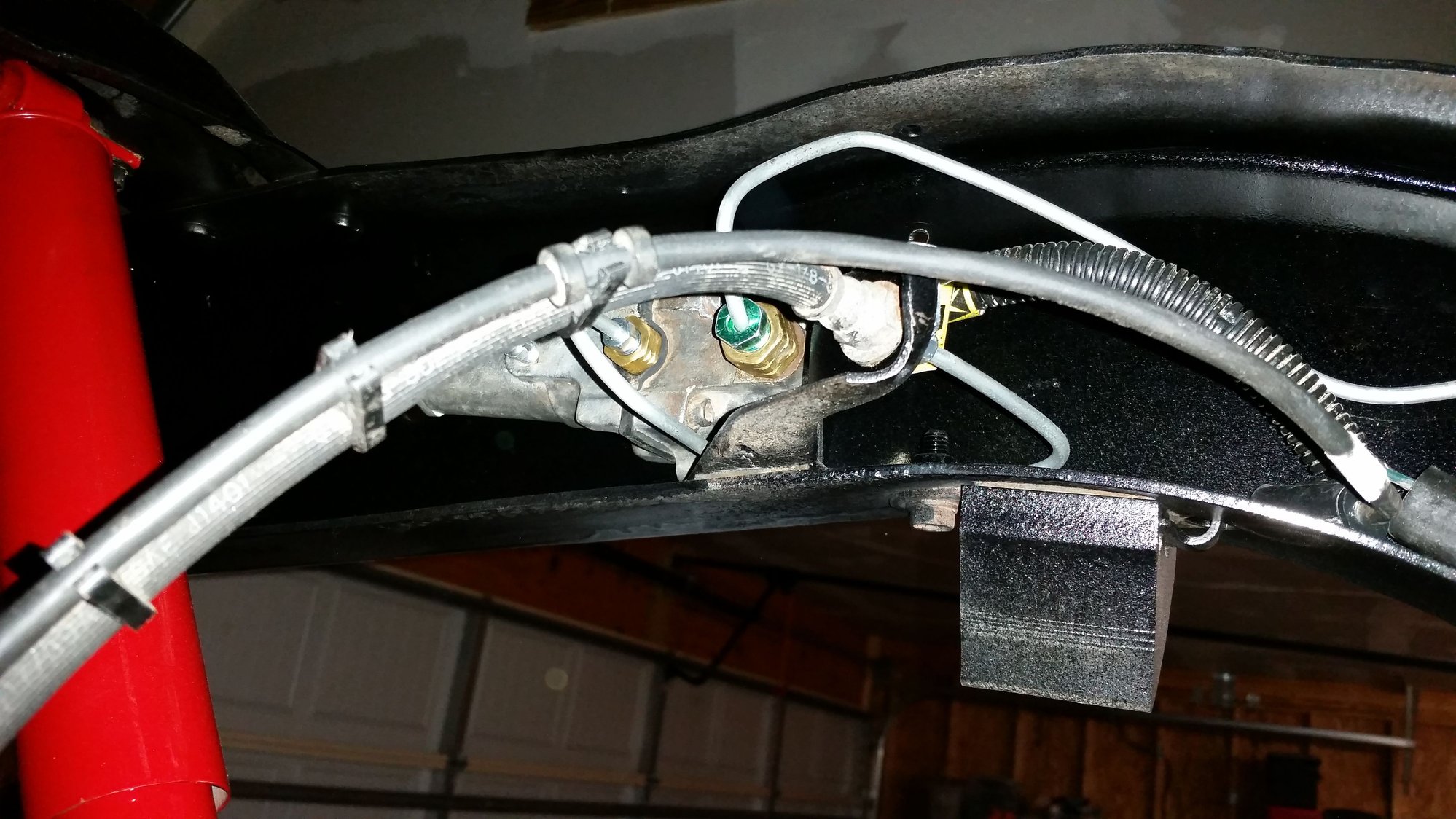

Time for some updates....Nothing too sexy, but what the hell...might as well post some boring pictures for posterity.
Rebuilt/Cleaned the ABS and Proportioning valve and ran all new brake lines (except to master cylinder...will wait to drop motor)

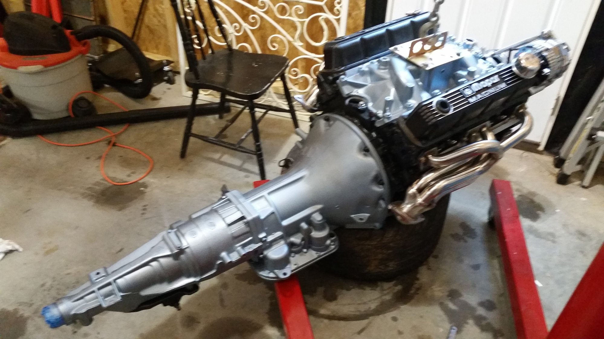

Posts: 1,033
And rebuilt transmission....I put in a high performance kit for the A500...new sprags, kolene steels, reds clutches, transgo shift kit...rebuilt the valve body. Currently painting as you see it on my cart. Not bad for rattle can engine paint.

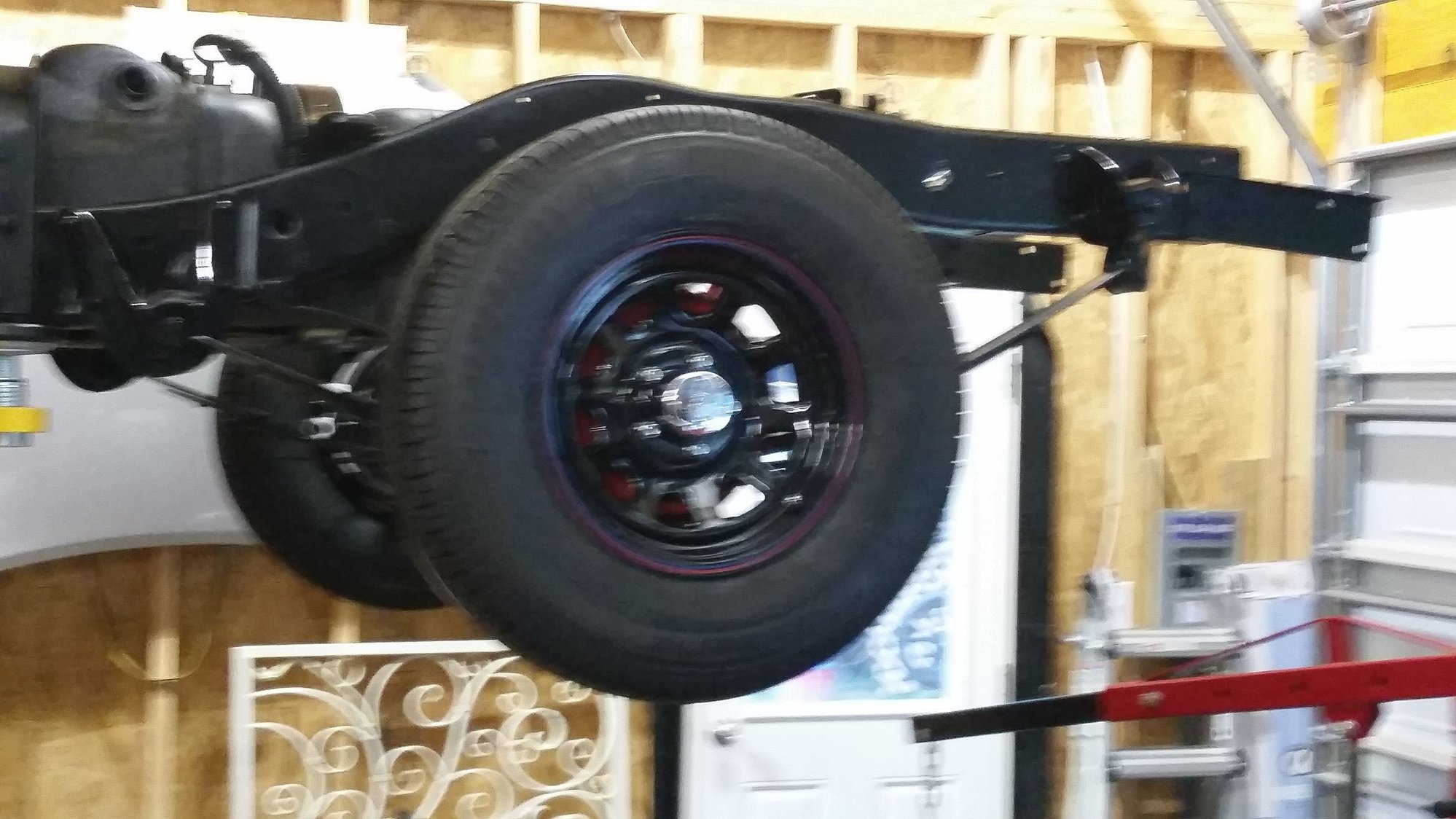

Posts: 1,033
Put some new shoes on her....Pacer Daytona's. I went with the larger tire that fits 235/75 but I'm not sure I like the look. I got a great deal on the rims (brand new), so It'll have to do for now...Once the fenders are surrounding it, maybe they won't look so plump

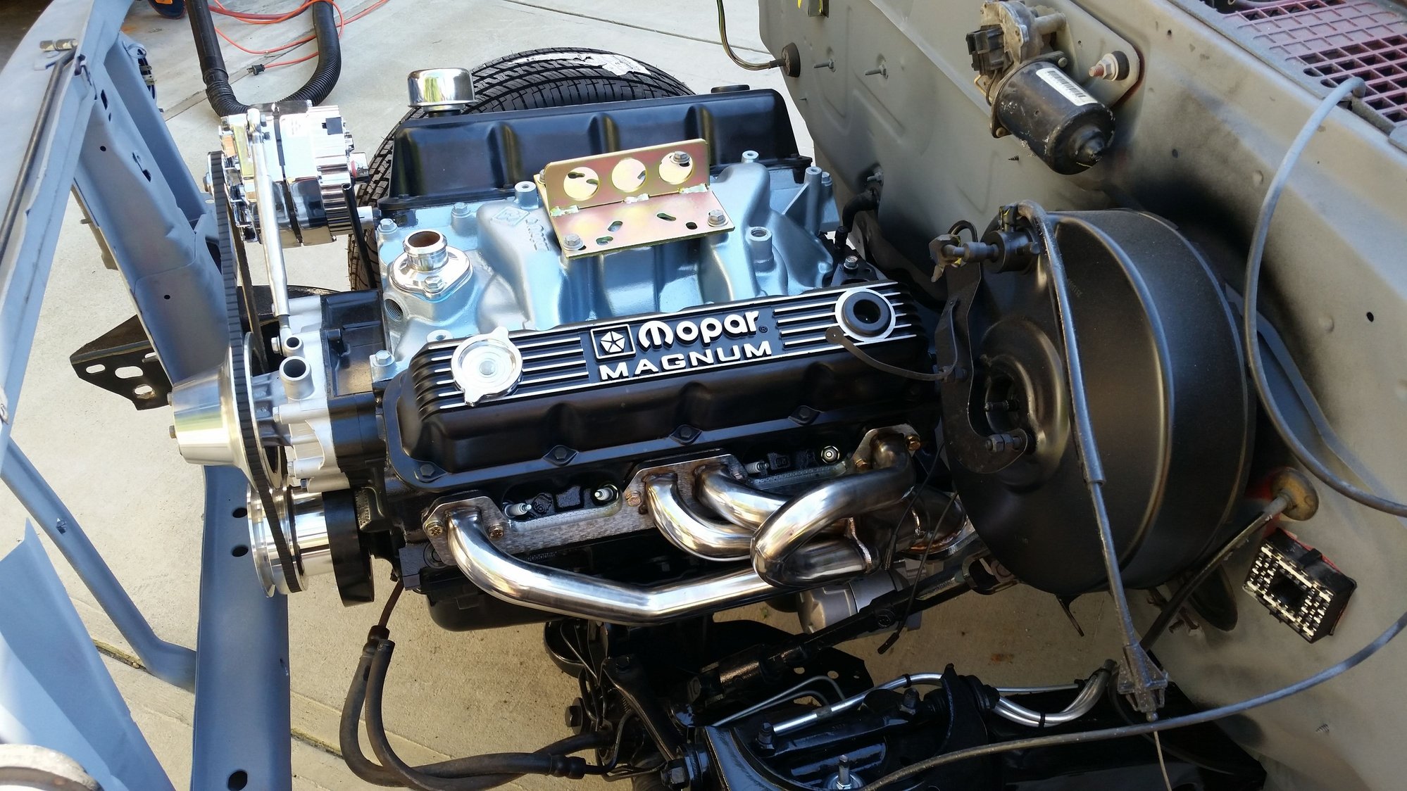

Posts: 1,033
Getting close....Hoping to drop this in tomorrow!!!!

Posts: 1,033
And we have touchdown! Save for one small interference (see new topic)
