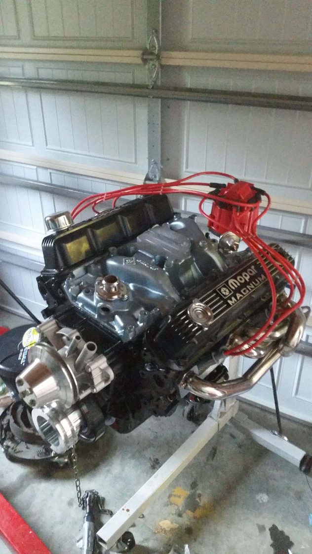

Engine, sans carb (edelbrock performer), Alternator and Power Steering

Looking real good!
Are you doing anything to the original motor mounts?

Originally Posted by ragged89
Looking real good!
Nope....they were in great shape. Don't know if they'll hold up to the added weight or torque but I'm going to start with them.
Actually, by the time you subtract the weight of headers vs cast iron exhaust manifolds, an aluminum intake vs. cast iron, and no AC vs AC, that 5.9 probably isn't going to be all that different in weight than the old V6! Those V6 motor mounts may be just fine, likewise with the original torsion bars.
I was thinking the same thing, but I know pushing that thing around on the engine stand, she's a heavy beast. And that's sans alternator and power steering.
Speaking of which, the original alternator that was on this crate was bad. It was a denso design with the holes opposite 180 degrees. One hole on the motor with a long sleeve, the top hole using a turnbuckle mounted to the center hole above the timing cover. I want to go with a standard alternator that has the one large hole, and two small holes like this: http://www.summitracing.com/parts/pw.../make/chrysler
Any ideas on mounting? I still have the old V6 brackets somewhere, but when I bought the truck the alternator was already removed and gone...I found the brackets loose in the back of the truck. I can't seem to orient the bracket to mount this alternator.
