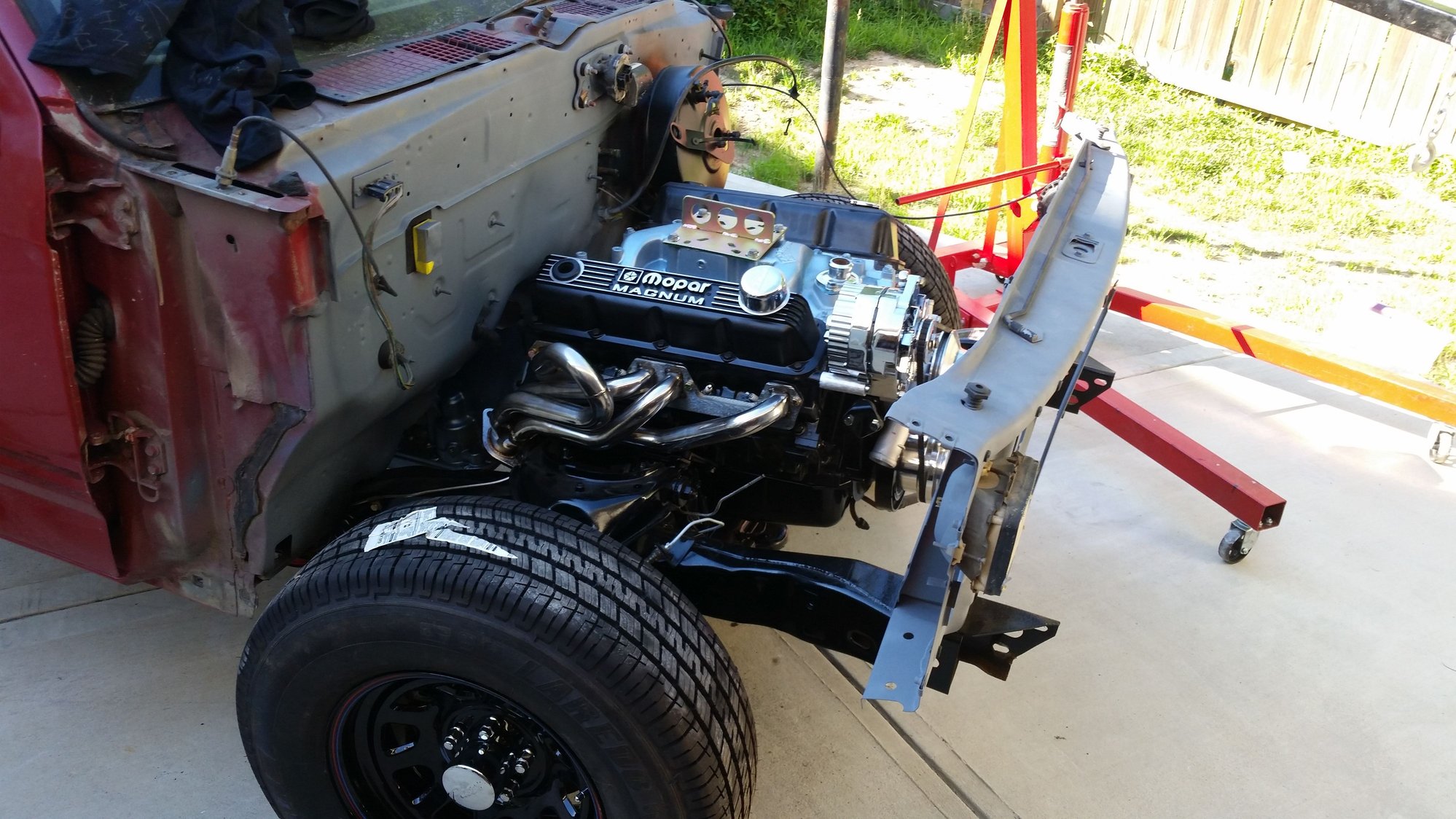

Actually I think if they cut the flange off they could extend the collector past the frame and weld the flange back on. Either way from a logistics standpoint kind of sucks. The last thing I was going to do was drive it to the exhaust shop. Won't do that now with it like this. I'm thinking I can probably just cut the flange off with a die grinder and let the exhaust shop put it back together later.

1) The passenger side header hits the frame. I guess not the manuf fault completely as I bought this header for a V8 89 Shelby, and now seeing that the V8 shelby blocks were shifted back, I can see if my engine was shifted back it would clear because there's a notch in the frame for the original 90 cast iron manifolds. So will have to figure out how to gain about 1/2" of clearance there.
2) The water pump hits the radiator fan. Again, because this is a crate motor V-belt setup, it uses the LA style water pump which is longer than many previous swaps that used a magnum pump and serpentine setup. The options here are move the motor back (I guess that would solve the header too), or go with a custom recessed radiator. Having one of those quoted tomorrow.
3) Because I bought this truck partially disassembled from a divorcee, I'm now finding I'm missing a lot of important little things that are exceedingly hard to source. There are enough differences in Gen 1 Daks from year to year, that not everything fits even if I find a different year Gen I in the yard. So far, finding a 90 Auto in a yard has been impossible.
