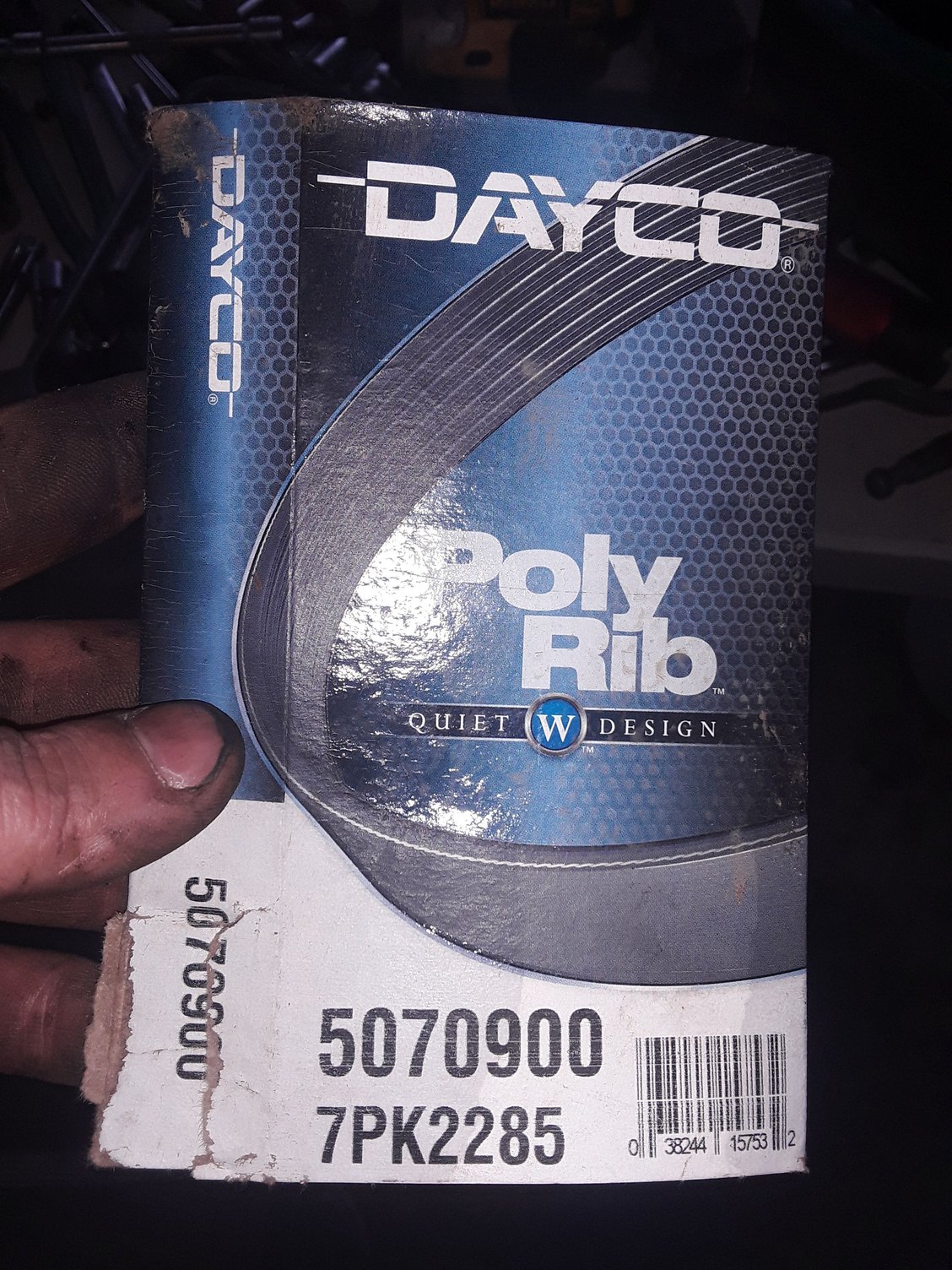

Originally Posted by scottyspades
My ac has a blown o-ring and im planning to remove it. Can i cheat and buy a belt for a non AC equipped 5.2 or do i have to fabricate/buy an idler pully/AC delete kit?
With no modification besides removing a/c compressor and hounestly i dont think you even have to do that

could be help to others doing same thing.
