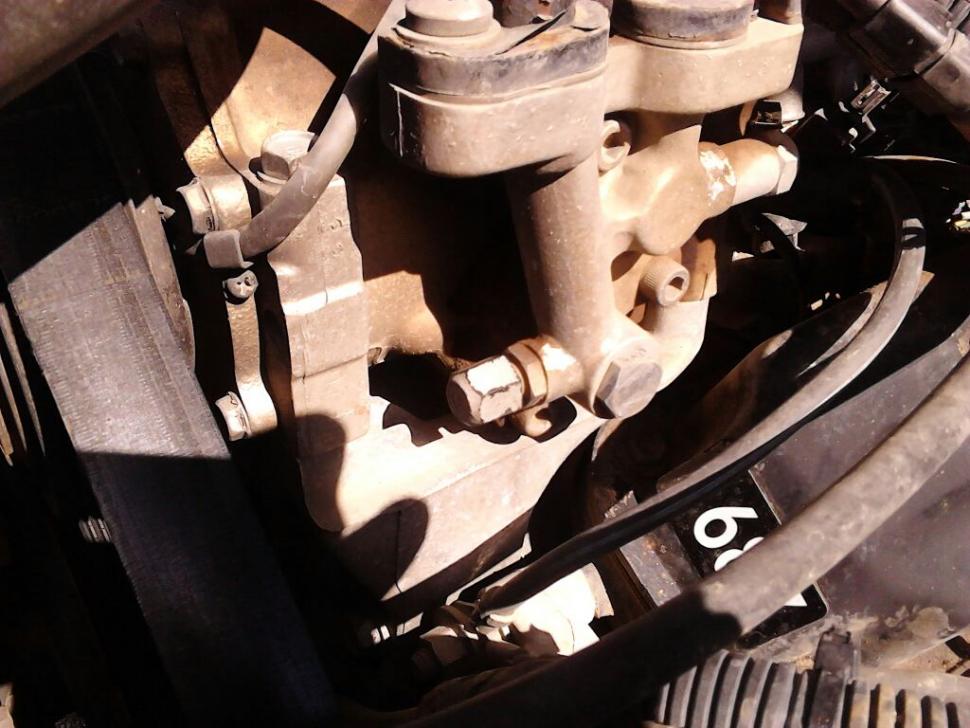

Specifically, which are the high and low side ports? I believe I have located the high side on the hose going to the condensor near the right fenderwell and the low on the compressor itself. Is this accurate?
low side is compressor... this is one i used to charge mine,... my 92 was r12 i just used the kits from walmart it comes with quick fittings for changing the R12 to a quick connect fitting and all... worked fine and nothing else was changed cept the bad condenser (reason it failed in the first place)

Low pressure is on the compressor, high pressure is the other one, yes.
