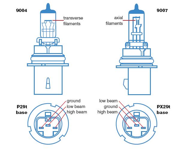

Either the relay isn't hooked up right, it isn't wired right, or there's an upstream problem.
Check the voltage at the old headlight socket on both low beam and high beam, does it change?
If so, then time to double-check the wiring of the Putco harness to the truck.
Note: The 9004 and 9007 can use the same harness, but two wires MUST be swapped to transition between them - notice the wiring of the two sockets below.
RwP

I'm thinking now that this Putco wire harness is a conversion kit, to convert wiring from using a 9004 bulb, to a 9007 bulb, and if I'm thinking correctly, all I have to do is buy 2, 9007 bulbs and it should work correctly, right ? I was just trying to get my lights to work all the time, not to convert them, but if it works all the time with a 9007 bulb, I'll be happy ! Can I do this ?
