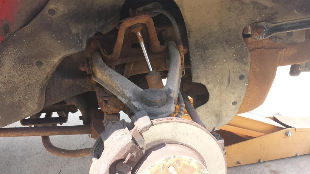

IMO if you are not able to do the repairs yourself, considering the truck has 300,000 miles on it, I would really look into replacing the truck with another truck. That shock mount also mounts the upper control arm. Again, IMO to make that would take a lot of time and talent, and that equals money. FWIW here is a picture of the mount on my truck before I cleaned it up.
