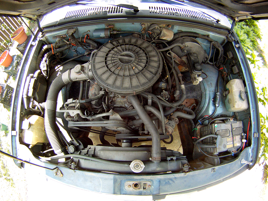

This was the engine bay when I first got it:
Then I removed the emissions right down to the vac solenoids and this is about as good as its going to get for me with this pos TBI 238ci, only other thing I will do is move the computer from the fender to the passenger firewall and move the battery to under the bed where the gas tank is...and the gas tank to where the spare tire was...

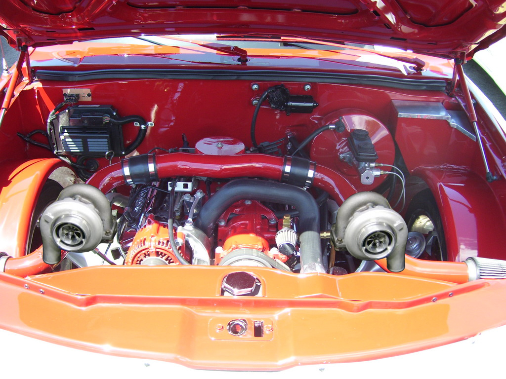

This was a Dakota that already had a Magnum engine that they cleaned up exactly how I am doing my engine bay minus the tubs, I already have tons of room around my LA engine and with the Magnum the accessory rack becomes tighter and centered creating even more room. However with my 87-90 front end the core support leaves no room after a full size radiator, AC rad and electric fan with a small block V8 behind it. I photoshopped in twin manifold top-mounted turbos where the dual cold air intake tubes were, they will fit perfectly and cleanly here under my hood being symmetrical...but it only leaves one challenge; the intercooler for the turbos.

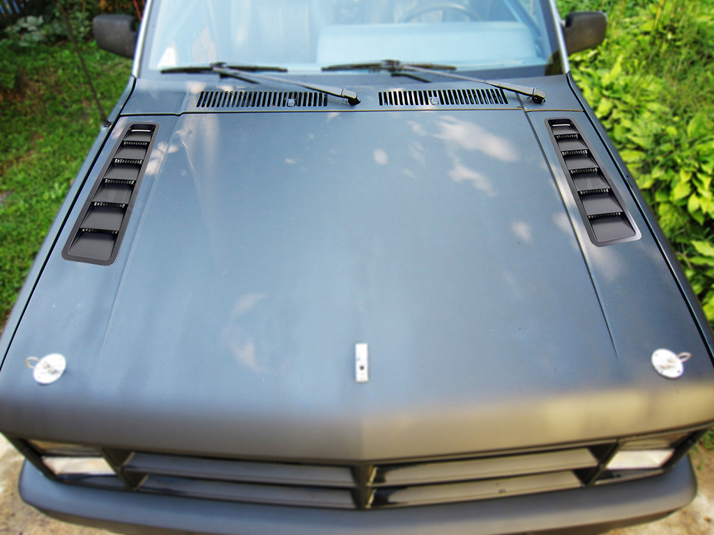

I have absolutely no room on either side of my core support for an intercooler but I don't think that is a problem if I were to split it up and run two smaller intercoolers one on each side horizontally against my hood. I don't want a scoop or cowl induction but I have always wanted to do dual louver pods, they will grab air and force it through two small intercoolers and then down into the engine compartment from there (or in reverse at high speeds) I know without a low enough chin spoiler the air goes up through your engine bay and creates drag against the bottom side of the hood. When all said and done after the tubes curl from the turbos toward the firewall up against the hood > across the intercoolers > toward the front they can come back down with a cone air filter on each side basically where they are in the photo above behind the headlights where the most (pos/neg?) pressure is for intake system filters to be located. If I did the custom plumbing and had the manifolds made would this system work much better than a NA 408 Magnum stroker?? Can I potentially run this twin turbo setup down the line on a stroker if I built one now?
