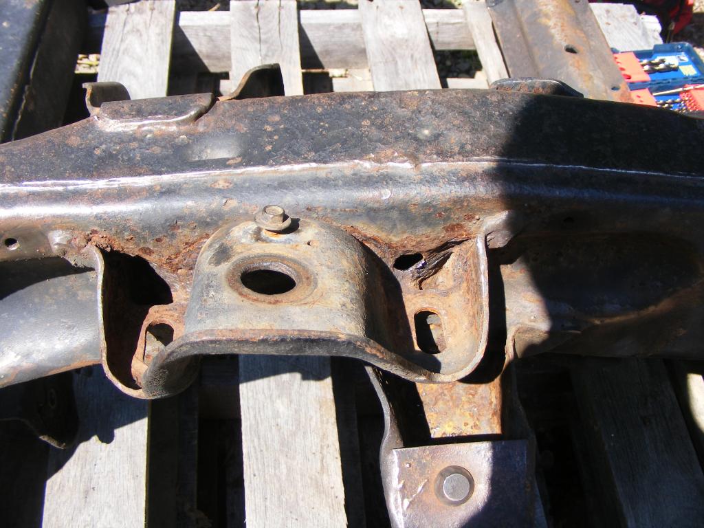

- Behind upper control arms - similar to the front leaf spring hanger, the control arm mounts have undersized drains which rapidly fill with crap. I have a frame that's in beautiful shape, but there was still small rust holes in the frame, as you can see in this picture. Nothing structural.

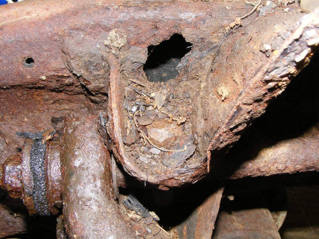

THIS, on the other hand, is STRUCTURAL AS F***.
Look closely at the sides, bottom, and much of the top as you can!!! Take a big screwdriver and poke it everywhere that looks a little suspect. Just because it looks good in some areas doesn't mean it isn't perforated in others. I cannot stress this enough.
