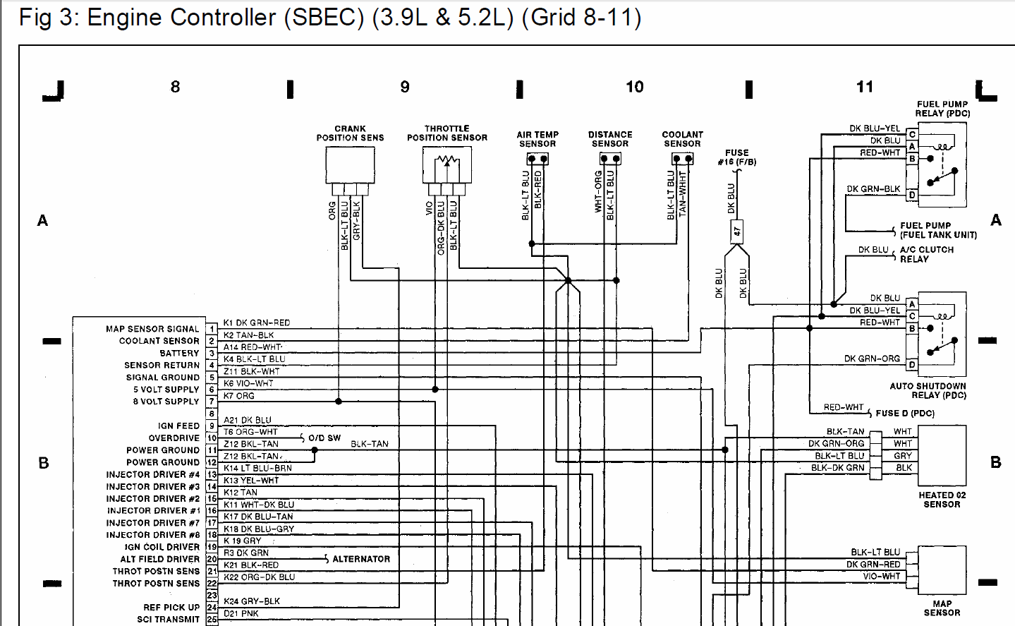

I would first check the coolant temp sensor.
Purchase a Multimeter and backprobes. (or any sharp conductive item, such as a needle) that you can insert into the back of the plug, where the wires go in.)
Then, check the voltage across the two wires while the engine is cold. Then periodically check it as the engine warms up. You should see a steady change in voltage as the engine warms. Or if you only have a multimeter you can unplug the sensor and measure the resistance. But this will trigger a check engine light and might stall the engine.
Another thing I noticed is that power for all the sensors first goes through the throttle position sensor. I think it is unlikely, but its easy to check. With the ignition off, unplug the TPS and measure the resistance were power goes in and comes out. Should read almost no resistance.
Good luck and keep us posted
