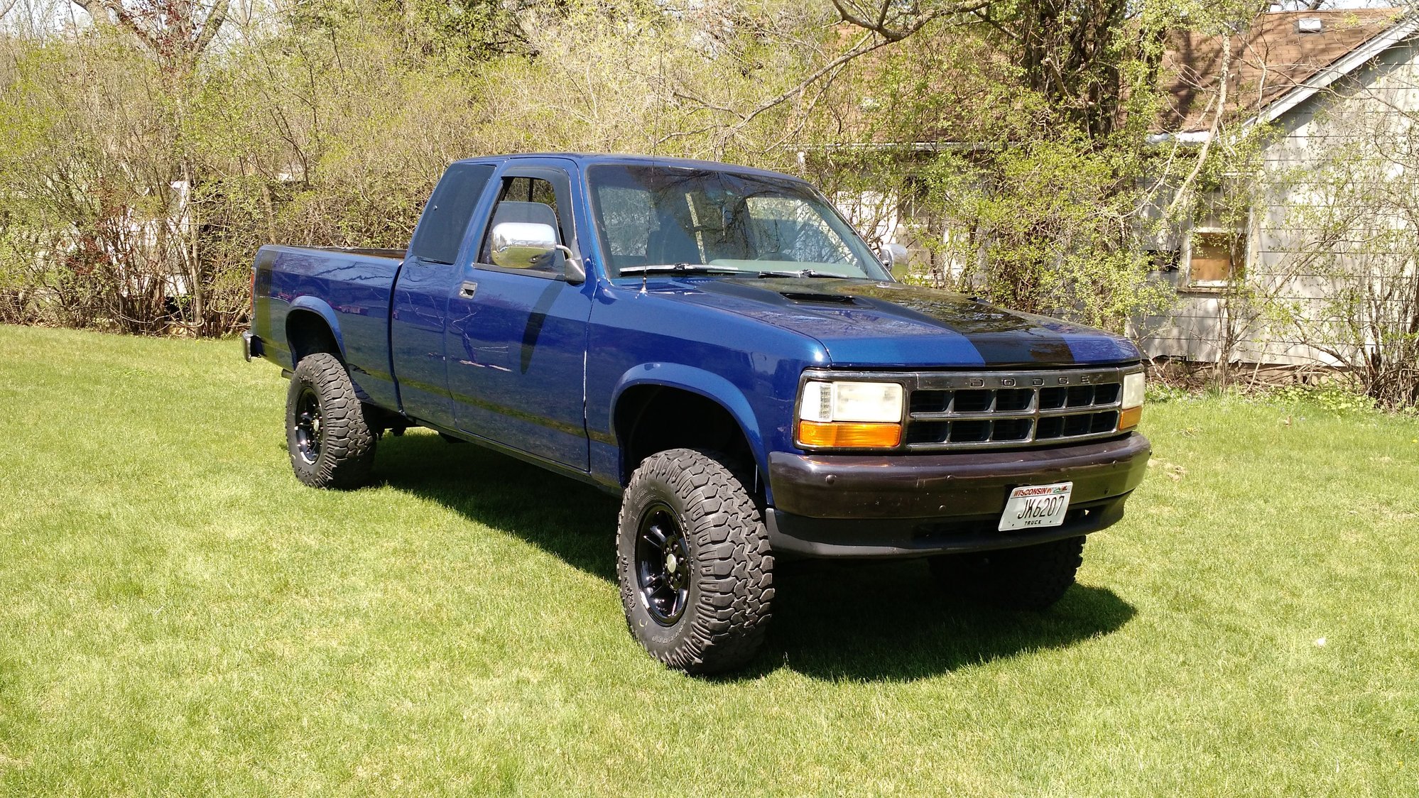

I finished this over the last 8 months well still driving it most of the time only laying it up for 2 weeks while I sprayed it. All new metal and I did a 5 speed conversion I was able to complete in 12 hours and have the truck back on the road. Couldn't figure out how to post pics to my profile.

That really looks nice!! Would like to hear more details. example, did you build that hood yourself? What 5 speed did you use, ie. year and was it from a Dakota? The pictures really do look nice.

Thanks. The hood is an AAR hood I found on Craigslist. The transmission I used was an ax15 I believe. It was the v6 one but I got it with everything I needed for $200 and its been holding up just fine and shifts great behind my 5.2. I powder coated a bunch of stuff myself. The bumpers are black chrome. I sprayed the plastic grill with Dupont chrome black out. The wheels are off a 98 I striped and powder coated those with a metallic black and I changed the calipers over to the 98 ones and coated those also (15" wheels) as far as the engine its still the original 5.2 with 210,000 and it runs great I have some stuff I'm cleaning up for it and maybe a few upgrades bit I'm going to see how long she'll go. Last compression check was 150-155 on all cylinders. The only engine work I've had to do were valve seals and distributer drive gear and bushing. Not too bad for how many miles I've got.

I've got the whole underside cleaned up also. The cross member was pretty rotted from the doaner truck so I had to weld new metal in.
