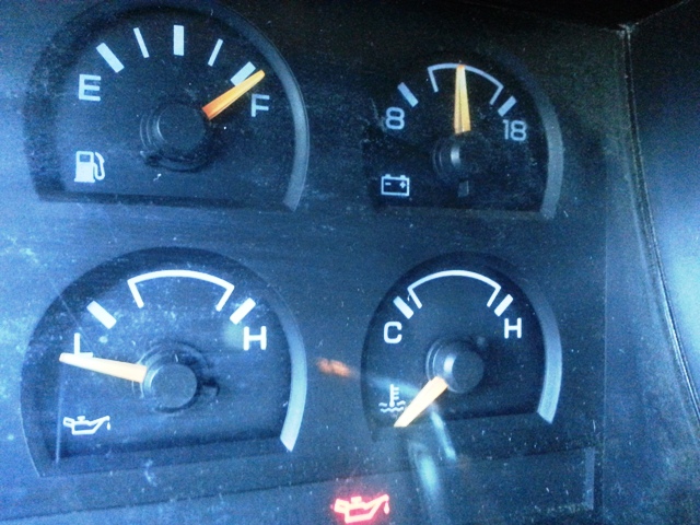

My temp gauge just died and I'm not sure what to check. It just dropped all the way to the bottom left and makes no difference key on or off.

I would start by pulling the wire loose from the sensor. Have someone sit in the truck and turn the key to on. The guage should read cold. Then with the key on, touch the sensor wire to the engine (ground) guage should go to hot. If it does, the sensor is bad.

OK. I grounded that wire from the sending unit and the gauge never moved. Guess I'll have to start tracing wires or install an aftermarket gauge. I have cooling issues with this truck already and I don't want to cook the engine. Thanks for the help.

Test the gauge, and when you get done, be sure to put the needle at the half way mark (half way between C and H). There's a chance that something happened that drove the needle out of its normal range and just tweaking it enough to get it back into range may fix it.

That was the ticket. I disassembled today and as soon as I touched the needle it jumped right back up where it's supposed to be.
