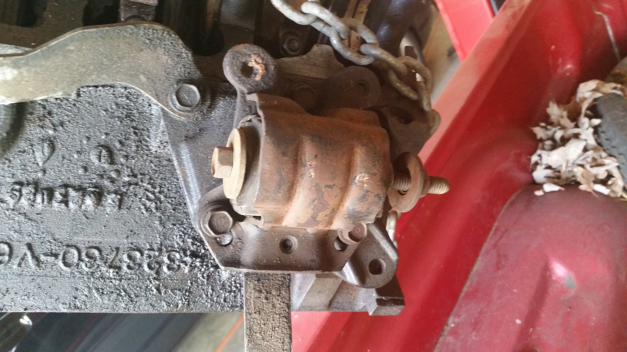

Oh, I do have this picture of the engine mount on my truck. And FWIW I guess its possible, but I would not have thought that Shelby would have moved the frame perch. Its welded.

Thanks for the pic 93, but if my previous post is true, Shelby didn't use the mid mounts....They used the front mounts and a special cross member, hence the different mount part numbers.

Robert, not sure if yours mounts like mine, but if so, would it be possible to take the upper portion of the mount, cut the part off that bolts to the block, Then take a 1/4 in. steel plate, drill the engine mounting holes, then weld it back together, but moving the motor back an inch or so?
It would be beyond my abilities, but I feel sure it could be fabricated.

My mounts are different....they are the barrel type...I'd have to move the entire perch.
