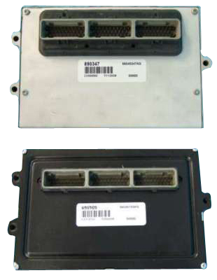

94 was using the SBEC, looks like this:
To go with the change to OBDII, 1996 picked up the JTEC, which looks like this:
(The 1987 used a Electronic Spark Control, or ESC, module; 1988 and 1989, and possibly 1990 used the SMEC, which looks like a SBEC but has an extra connector; 1991 to 1995 used the SBEC; and 1996 picked up the JTEC.)

Oh okay, I didn't know if they where the same computer module or not, but I guess you learn something new everyday.
