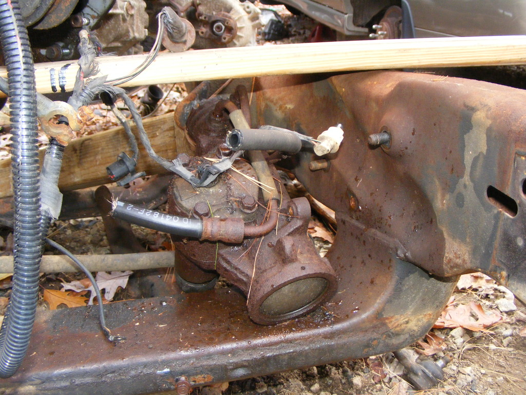

You don't have a rack & pinion. But you should inspect the steering gear bolted to the drivers side frame rail for any obvious issues. Power steering hard lines can rust through over time so check those. Not a bad time to change the P/S fluid at this time as well.

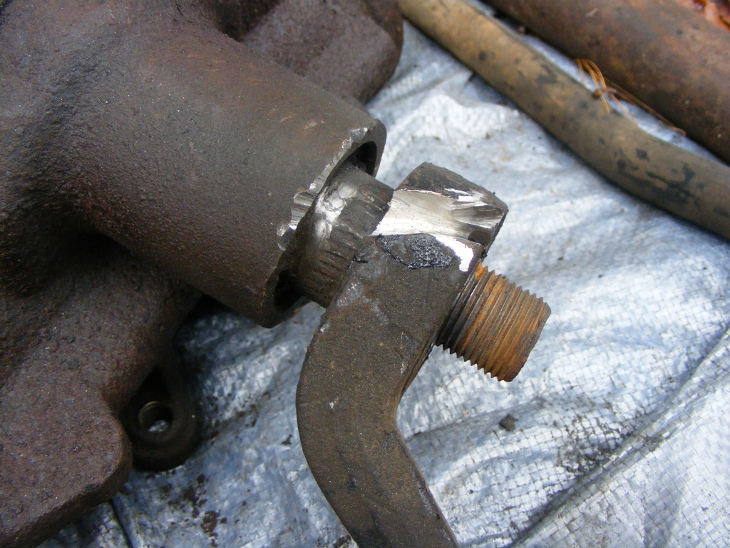

Idler arm is easy, it's bolted to the passenger frame rail and pressed into the steering link. The pitman arm you need a pitman arm puller to replace, or just very carefully cut a notch all the way through the pitman arm and whack it off. I do not recommend this approach but it is how I did it. Note I replaced the pitman arm with the steering gear off the truck. No idea how easy it is to replace it with the steering gear still bolted up. EDIT: oh yeah the pitman arm must be installed in the same spline orientation it came off, I BELIEVE the Dakota arm can go on only one way, but I do not remember for sure.

Steering gear. Was not happy with the condition of the hardlines so I replaced lines & hoses

This was just a bad idea but it worked to get the pitman arm off...
