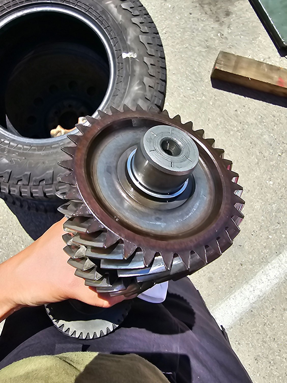

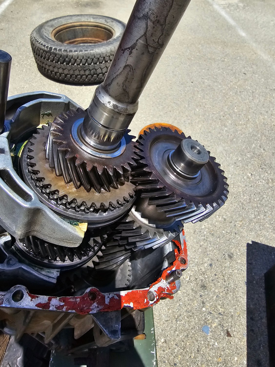

I have used penzoil synchromesh exclusively since I got my truck 30k miles ago. But I am definately not a fan, I use it because it's the only MTF that my local parts stores carry in person. That being said, last year I burned up my input shaft gear and the meshing gear on my countershaft which both chipped pieces that caused damage to all my other gears and left my transmission whinning like a straight cut racing trans. I 100% blame it on the oil, the transmission was serviced up the fill port. I was being pretty aggressive on the gas while climbing up to 4k feet just outside of Yuma on my way to San Diego. It was definately a hot day likely around 90F and I had been running the truck at 75mph for hours as I was on a road trip. I understand the transmission was likely heat soaked, but my engine is stock and I was in 3rd gear around 3500 rpm with not more than 500lbs of stuff in the bed. I'm assuming my oil thinned out and stopped lubricating from the excess heat. In my mind any decent oil should be able to handle stock engine power on a 90F day without completely breaking down.
I have since learned from my lesson and installed a simple temp guage through a hole I drilled in the fill plug. And while driving under similar conditions I have seen oil temp as high as 210F after hours of 5th gear driving at 75mph on a hot day on flat land. Dropping to 4th gear drastically drops the temp (as you might imagine) after 5-10 minutes down to 190F. The coloration on the gear teeth suggest that they got up to around 530F that day. I'm sure the oil at that point was basically useless.
my point in all this is to say that I don't think penzoil synchromesh is up to the task if you plan to WORK your truck or tow heavy at low speeds. Ironically enough if you tow heavy on the freeway you likely do it in 4th gear which means the transmission is basically generating no heat. I will running various oils and putting my truck through the paces to get real life temp indications and will post my findings. All too often people talk about different oils based on how they "feel" it works but I want to get some numbers down. And a transmission cooler is definately in the works. I included pictures of my burned up gears below.
