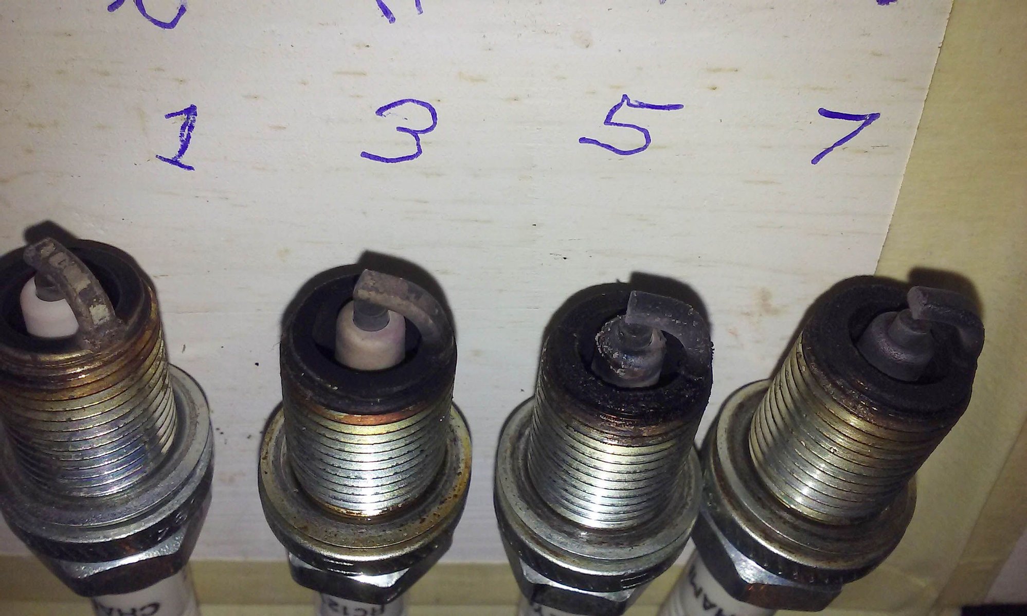

OK, so I pulled the plugs yesterday to see if I could tell anything. On the passenger side, the two rear-most plugs (cylinders 6 and 8) look like they’re varnished with shellac, but otherwise clean. They’re too clean looking, like they’ve barely been used. I’m not losing any coolant, and my oil isn’t showing any foam at all, so I don’t think there’s an issue with water in the cylinders. Is this an indicator that injectors are plugged and combustion isn’t taking place? Is this related to the manifold leak (not my bet)?. Or do I have a stuck valve? None of these makes sense, given that the engine starts so easily and runs so smooth. I will say that when I assembled everything I flushed the fuel lines, but not the fuel rails, and I’m wondering if some scale didn’t clog those rear injectors because the motor sat a couple years before being installed.
I’ve looked at plugs many times over the years, but I’ve never seen plugs look quite like this. They’re telling me something, I just don’t know what it is. I’m hoping one of you smart folks has seen this or can figure something that can point me in the right direction. There’s always something new to learn.

Did you put the v8 computer in? Or are you sure they put the v8 computer in? Looks like those two cylinders aren't doing squat which would explain the lack of power and unburned fuel coming out the pipe.

I agree ragged that 8 and 6 plug do not look used. Have you tried pulling them one at a time and cranking it to see if they are getting spark? You have given me an idea for why my 4 banger Ram50 has so much soot coming out the exhaust and MPG's worse than the V6.

If you've got spark then I guess I would try to see if the injectors are firing in those cylinders? Maybe switch an injector from one of the cylinders that look good? I have no idea how one might check an injector.. Maybe with a 9v battery and some wire?

I can try the metal-rod-held-against-the-injector method to see if those 2 injectors are clicking, but if the injector's screen is clogged with sediment, it can click away and still maybe not deliver fuel, or a decent spray pattern.
I think I'm going to replace the ICT sensor. The one that's in it is new, but that doesn't mean its good. Seems like a good place to start, at least it might account for the rich running, if not the clean plugs.

Im probably not much help here, but if it was mine, I would check compression to verify its ok. The other thing I would like to check would be to verify the timing chain is not 1 tooth off. I know on a chevy, it will run 1 tooth off. (with a new chain) It will be down on power, but otherwise not run that bad.
Also, I would switch the plugs to different cylinders and see if the problem follows the plugs or not. After that, swap wires to diferent cylinders.
One last thought, any chance the injector wiring is mixed up?. ie: cylinders swapped?
