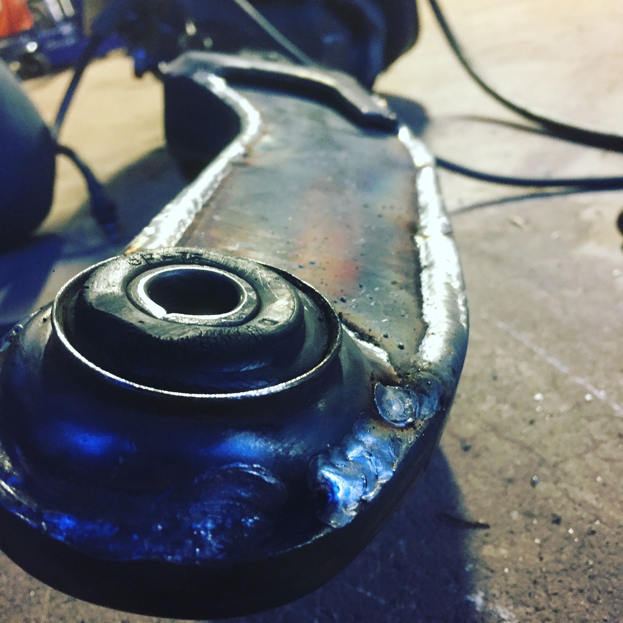

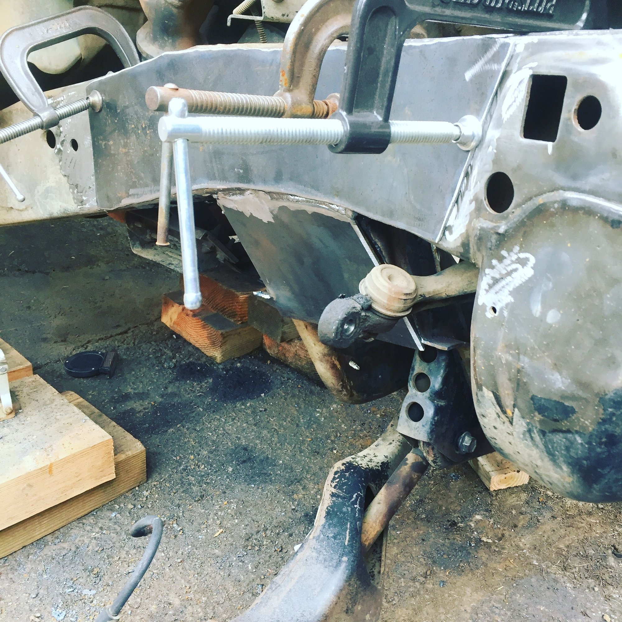

Basically cut out a ford crossmember got the axels at the same height and measured with string lines to get it senterd and tacked the crossmember in
Lots of droop
Plating/ bracing
Covering up the ugly crossmember ends and strengthening

Driver side hoop
Boxing this in
TTB axel boxing it in

Dang...not knowing much about welding besides my very amateur ability with a FC...those look like damn nice welds. And a sweet project. Hope he comes back to post.
