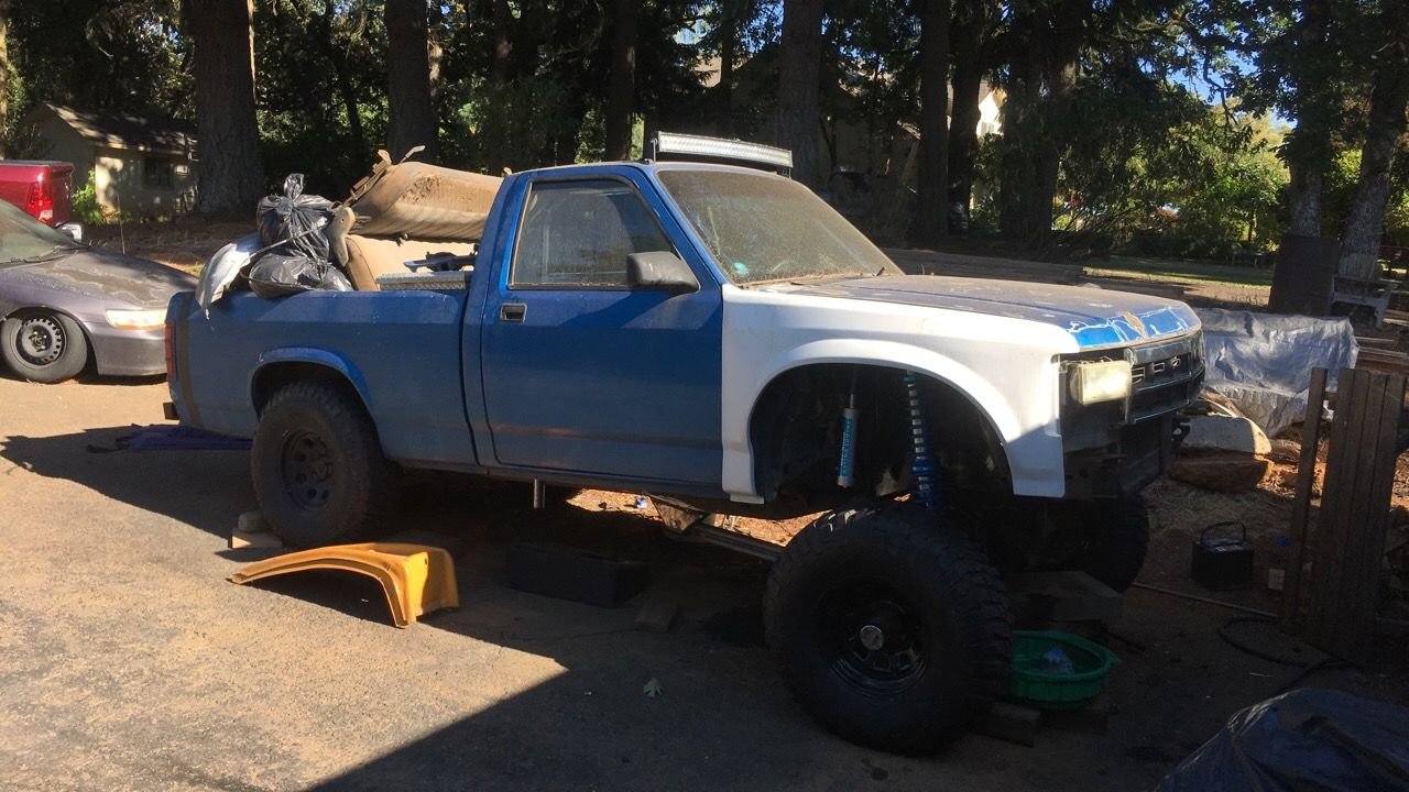

I got the fenders from advanced fiberglass online and the d44 ttb is out of a 1993 same year as my Dakota lol not on purpose things are at a stand still went through a break up and partied pretty hard but time to get the ball rooling again getting die for 1.75 for my bender and start bending up the cage I hate the way I attached the crossmember to the Dakota I wanna yank it and just build my own it's limittiing up travel some:/

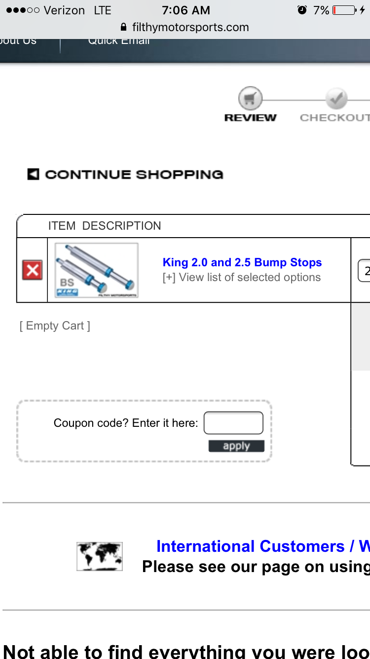

Just ordered bumps measuring for my coilovers today and welding up lower mounts

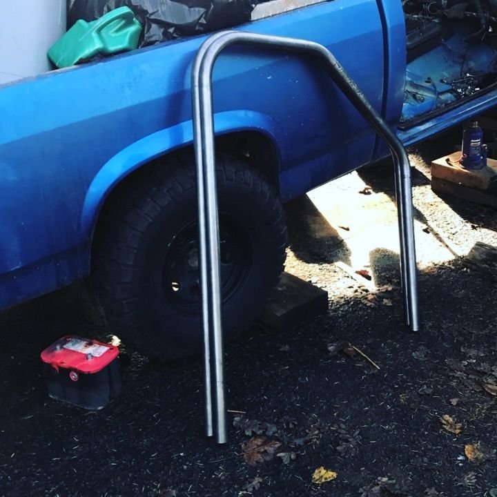

Orderd coil overs for the front started bending my cage anyone have good ideas for seats never got any and harnesses I make long trips wanna be comfy and held in tight but don't wanna blow big$$ on seats I won't like going to redo the crossmember too it's annoying me will also be building a custom dash with plate cage will be welded to frame will be sitting on 16" king coilovers should have 18" of useable travel 34" ride height eye to eye on my coilovers gives me 7 inches up travel with 4 inches of that being assisted by the bumps so 3 inches no bump but I don't think it will be any were near the 3 inches unless breaking super hard when I'm on the gass I will be at like 38" front high and if it's a 16 " travel coil over I'm only 1" away from it being 50%up 50% downtravel I think I nailed it? Hah IDk if you guys know this but it was originally a v6 truck I swapped a 318 in a year or two ago also so 5 speed small block powerd
