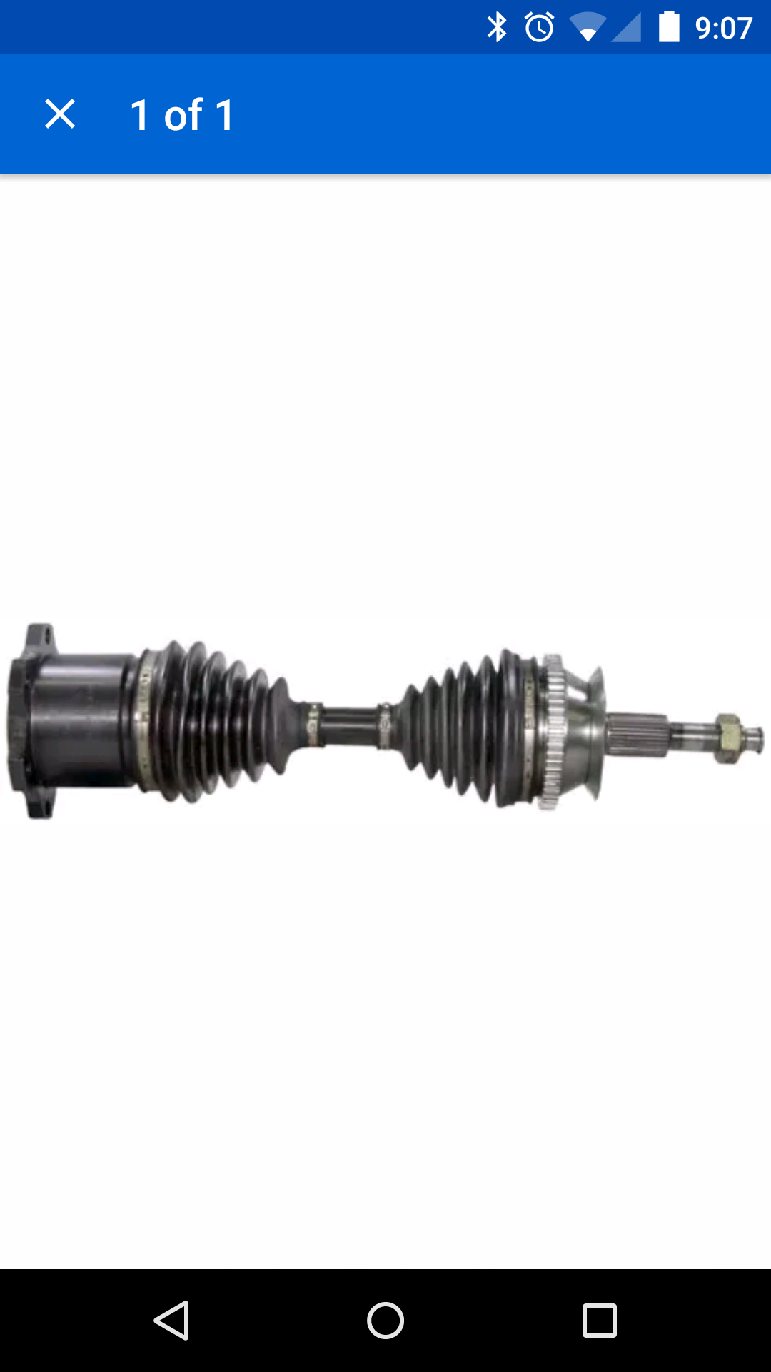

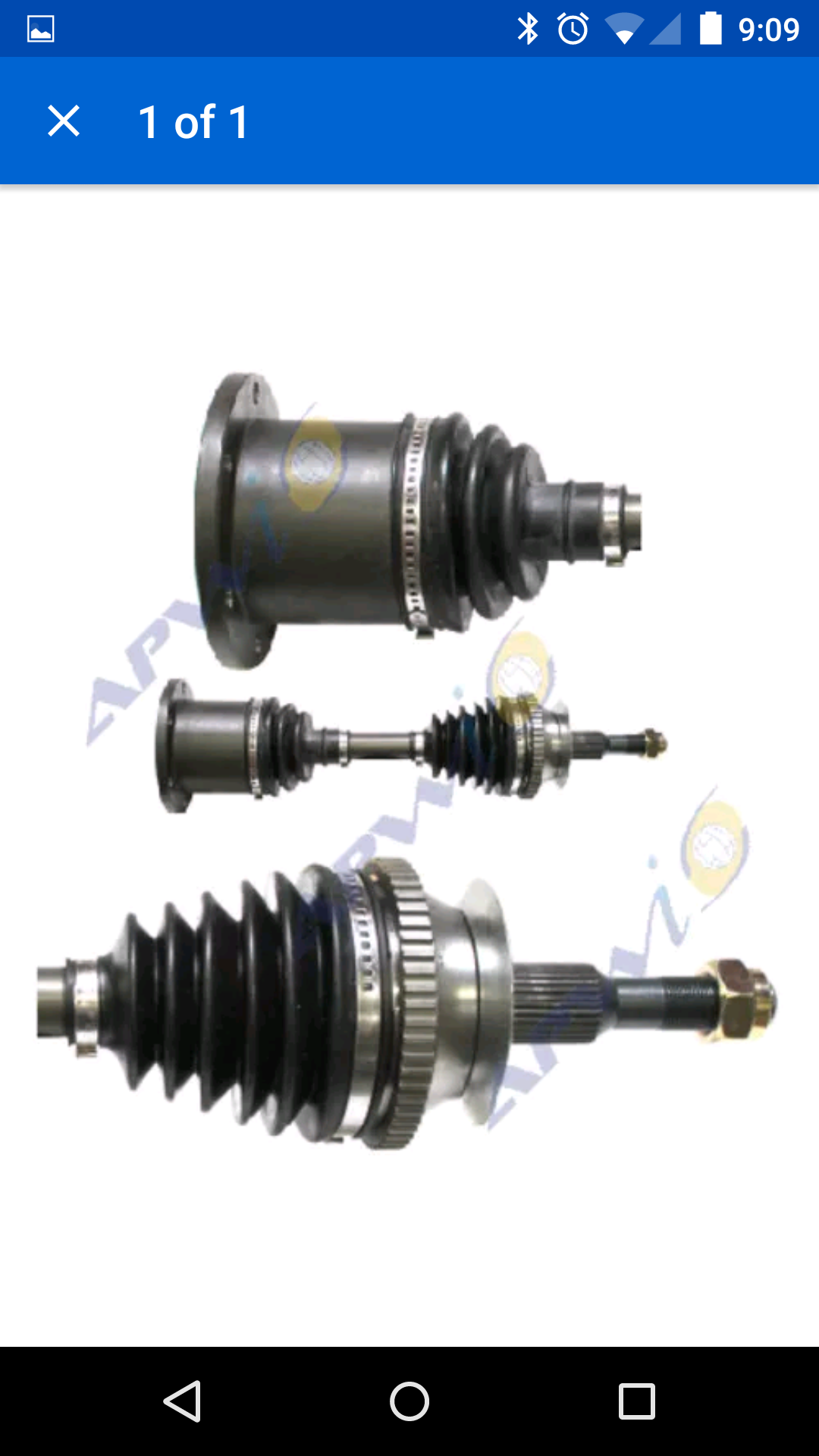

Mine are also lifetime warranty. It makes a big mess when they tare. I'd say your probably better off replacing the inside boots before you even install them if they're the 2 rib design
This one has the good boot on both ends
The inside boot will more than likely rip on this style on a torsion key lift(this is like the lifetime warranty ones I bought from O'Reilly and they tore after a few hundred miles. They did warranty them but the new ones ripped again)
This one has the weaker boot on the outside and will also tare with a torsion key lift. ( There is not enough flexibility with less ribbing for the increased angle.
