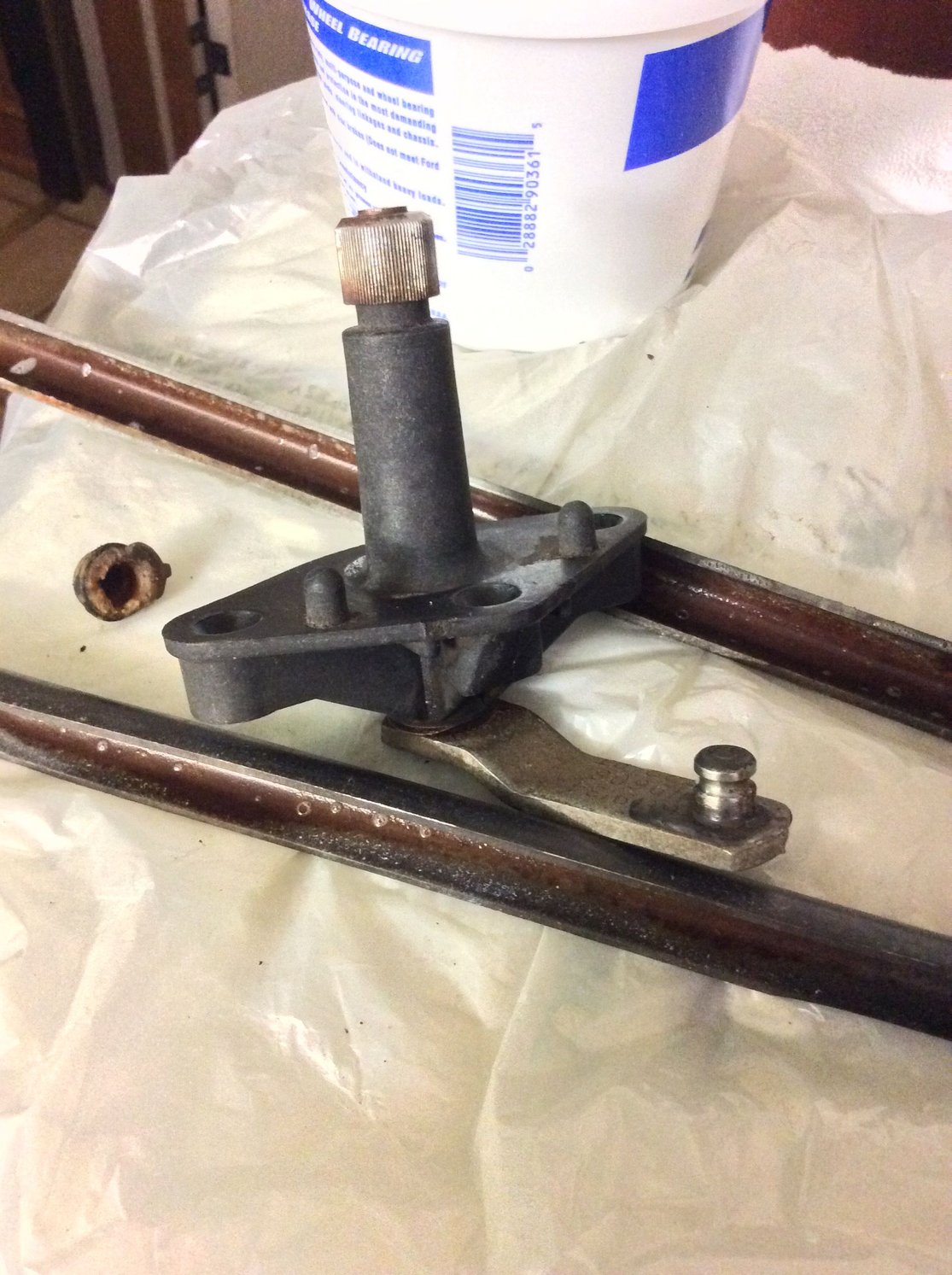

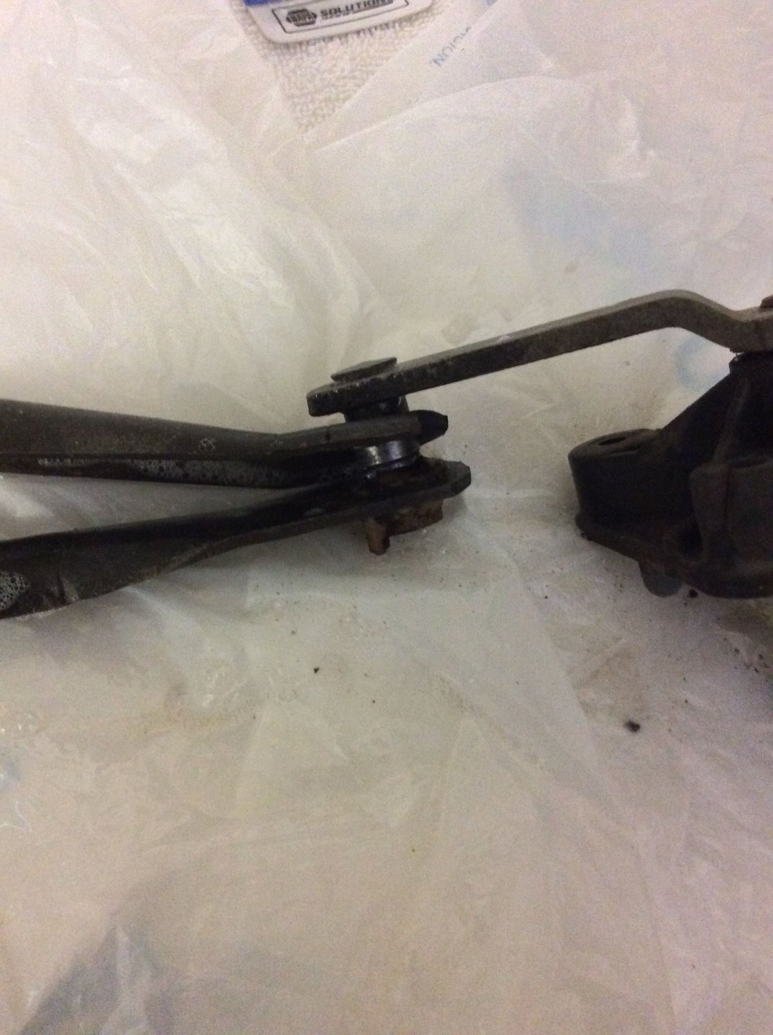

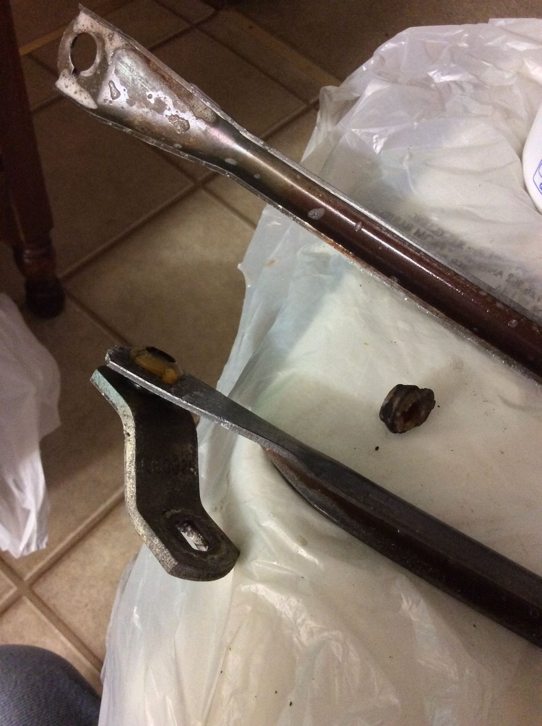

I took the wiper arms off and out(no problem to remove). I cleaned all of these parts the best I could when I took off the old bushings. When I get back to work tomorrow morning, I will install the new bushings with the use of a vice and some other tools & tips that RalphP recommended! I will post pics tomorrow of the new bushings pressed in. Here are some pics of where I am currently at:

I used a combination of grease, sockets, and a vise. Big thing to do is make sure to keep everything in order.

It helps if you take a pic of it before you take it out ... and be sure to get them stacked right, and turned the right way!
One thing that's caught me once is ... run the wiper motor around one time, and start the final attachment with the blades down. (I bolted the arm back onto the motor; once you get it lined up, you can run it around by hand to get it easier to tighten.)
I also used some Loctite Blue on the stud and nut to keep it from working loose.
