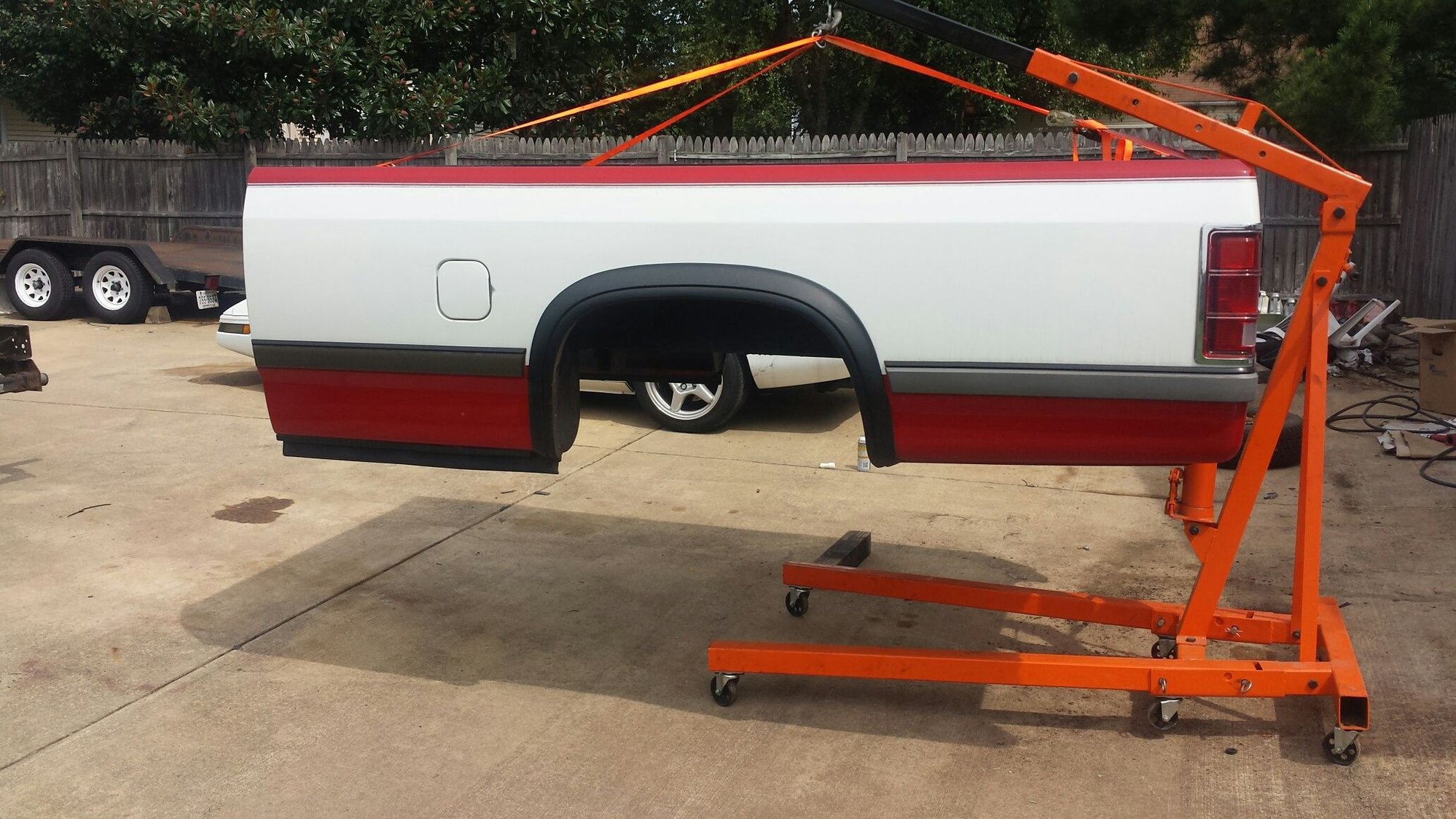

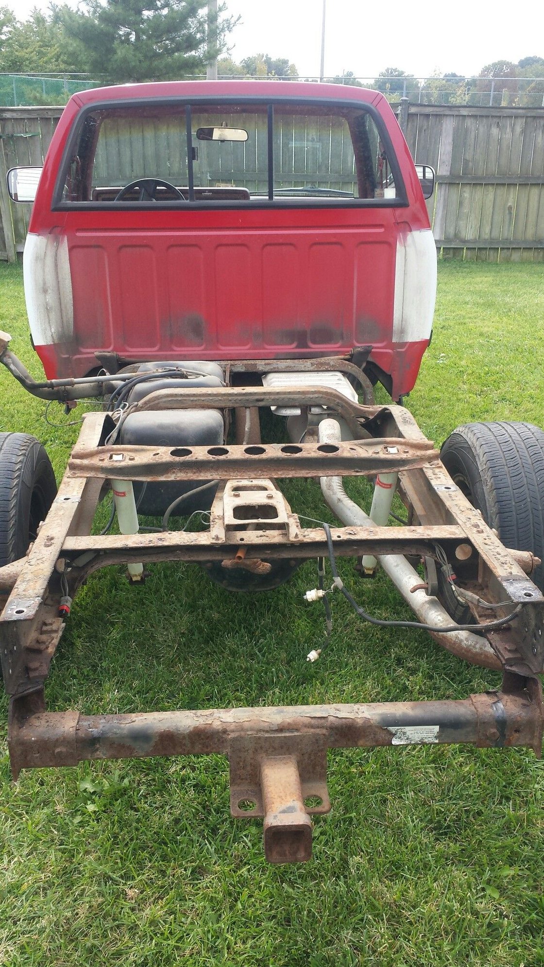

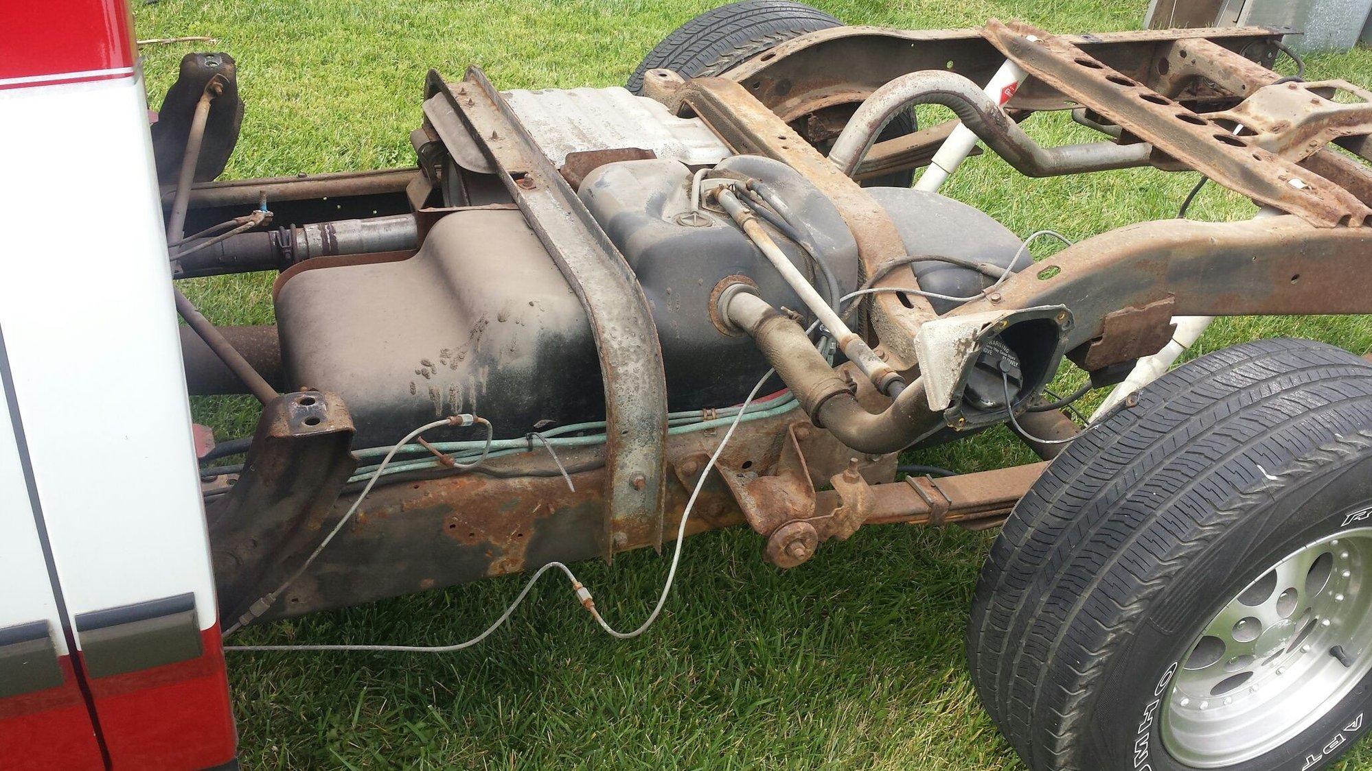

I got started by taking the bumper off, and then lifting the bed off of the truck. FWIW that was not as bad as I expected. 6 bolts for the bumper braces, unplug wiring harness, 4 screws on the gas tank nozzle, and then 9 bolts holding the bed.. I then removed the tailgate and ran 2, 1in straps from corner to corner, used my engine lift to raise the bed, and drove the truck out from under it.
Here is a picture of the truck without the bed.

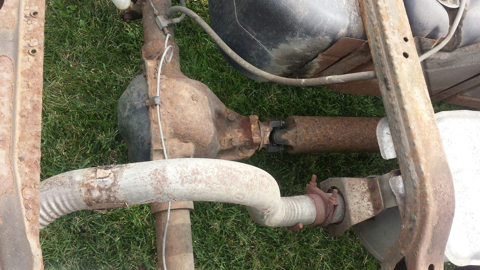

Here are a few more showing its 31 years of dirt and rust!!

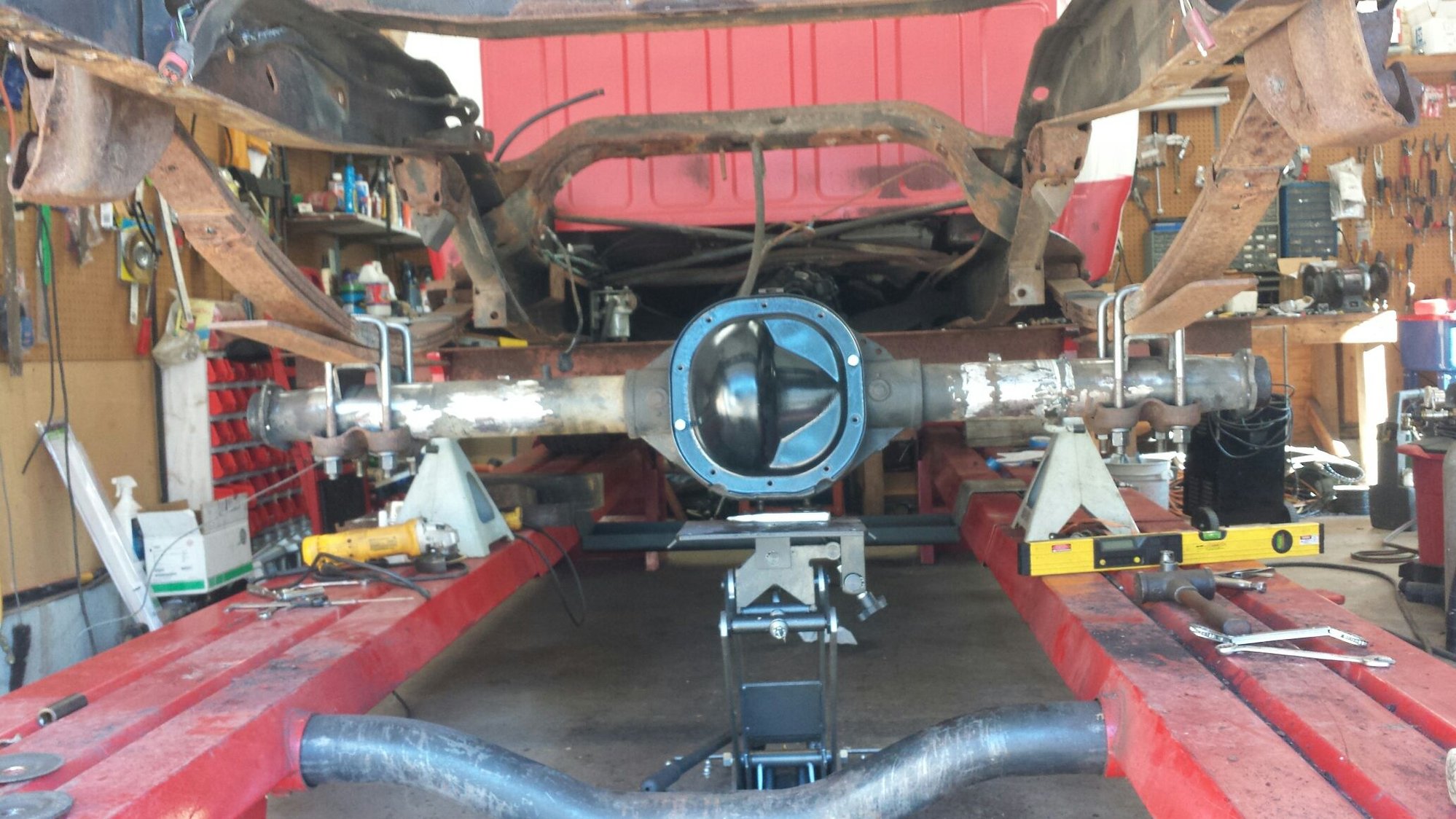

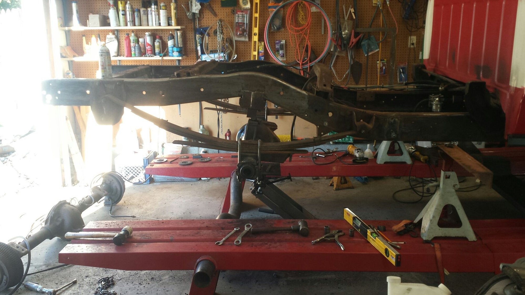

Moved the truck back into the garage, pulled out the 8.25 and hung the 8.8 to the springs.
If you notice in the next picture, I tried to use a set of orig. style, semi round u-bolts and the dodge bottom plates to mount the rear end. But with the difference of the axle tubes, 3in vs 3.25, it just would not work well. I ended up using a different set of plates and bolts, that I will show you latter.
Also, I had planned to try and use the explorer sway bar, but it turned out that the sway bar mounts were where the shock mounts need to be. I considered moving the shock mounts, but decided to scrap the sway bar idea, and just cut the mounts off. Besides, I was unable to find a bigger sway bar for the front, and without changing it, I felt the truck would be out of balance.

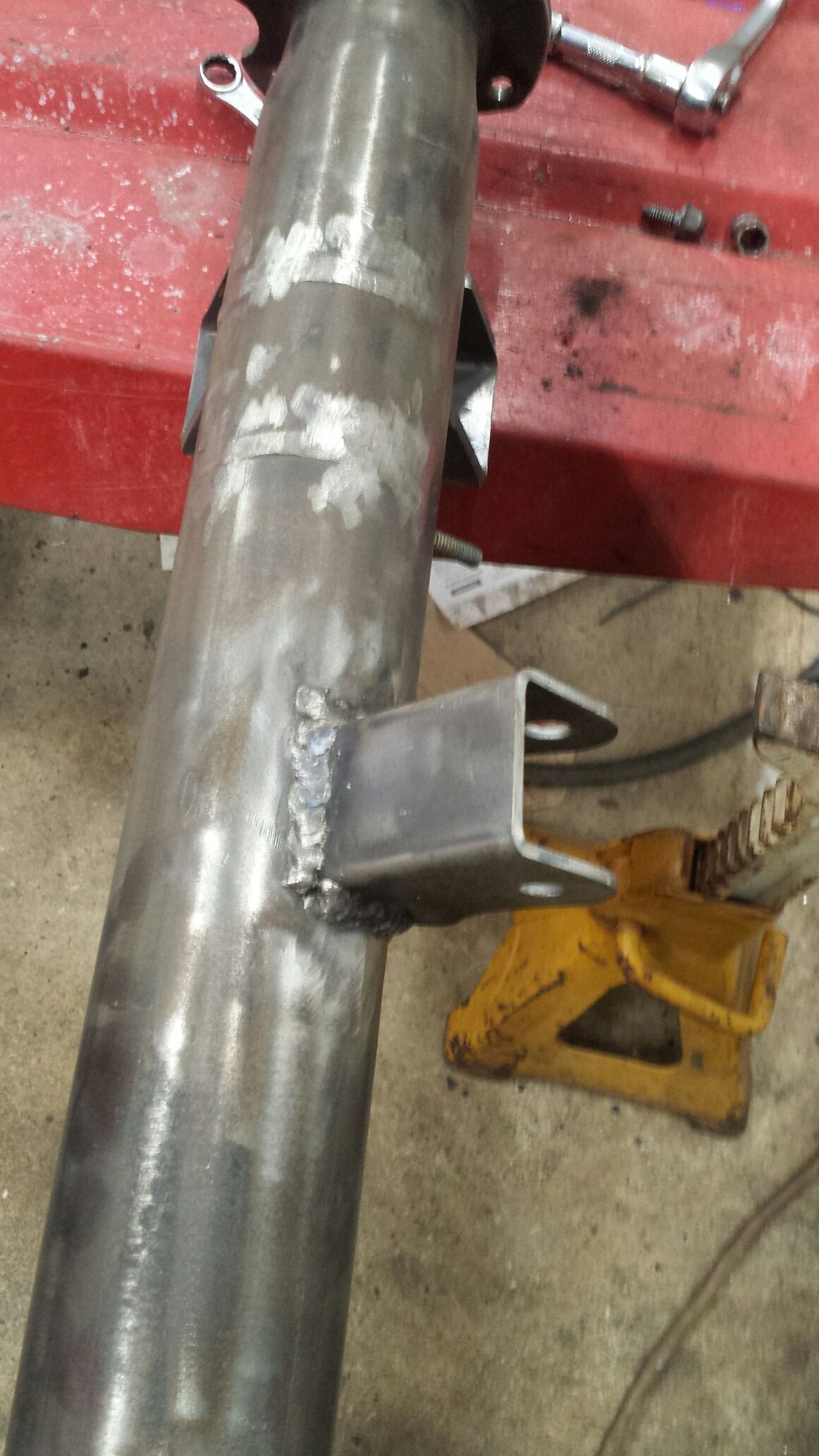

I read up on how to set pinion angle. Ended up scrapping all of those plans and did it this way.
With the orig. 8.25 hanging, no shocks, driveshaft, attached, I use a digital level again the back side of the axle, ( where the cover mounts) wrote down that measurement,
Then I set the 8.8 under the truck with the spring perches in place, and snugged up the u-bolts.
I then took measurements from side to side to make sure it was centered.
I then took the level and placed on the back of the 8.8 rear and twisted till the angle was the same as the 8.25
Double checked my measurements and then tacked the perches in place.
I then measured and clamped my shock mounts in place.
Then I tack welded them on.
Dropped the rear end down and welded the spring perches and shock mounts.

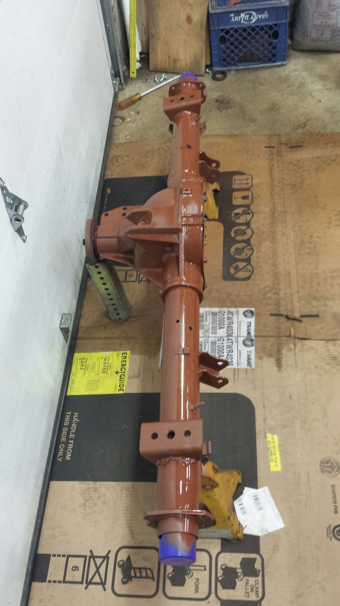

Final cleaning of rear end and painted.

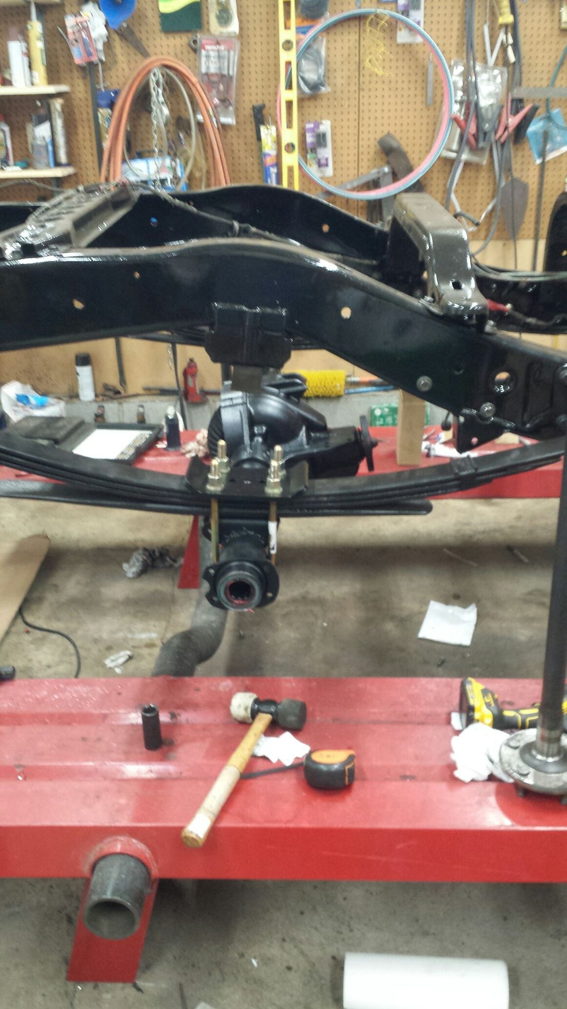

Here are some pictures of the new u-bolts and mounts.
The u-bolts are for a f-150 truck, and the mounts were universal.

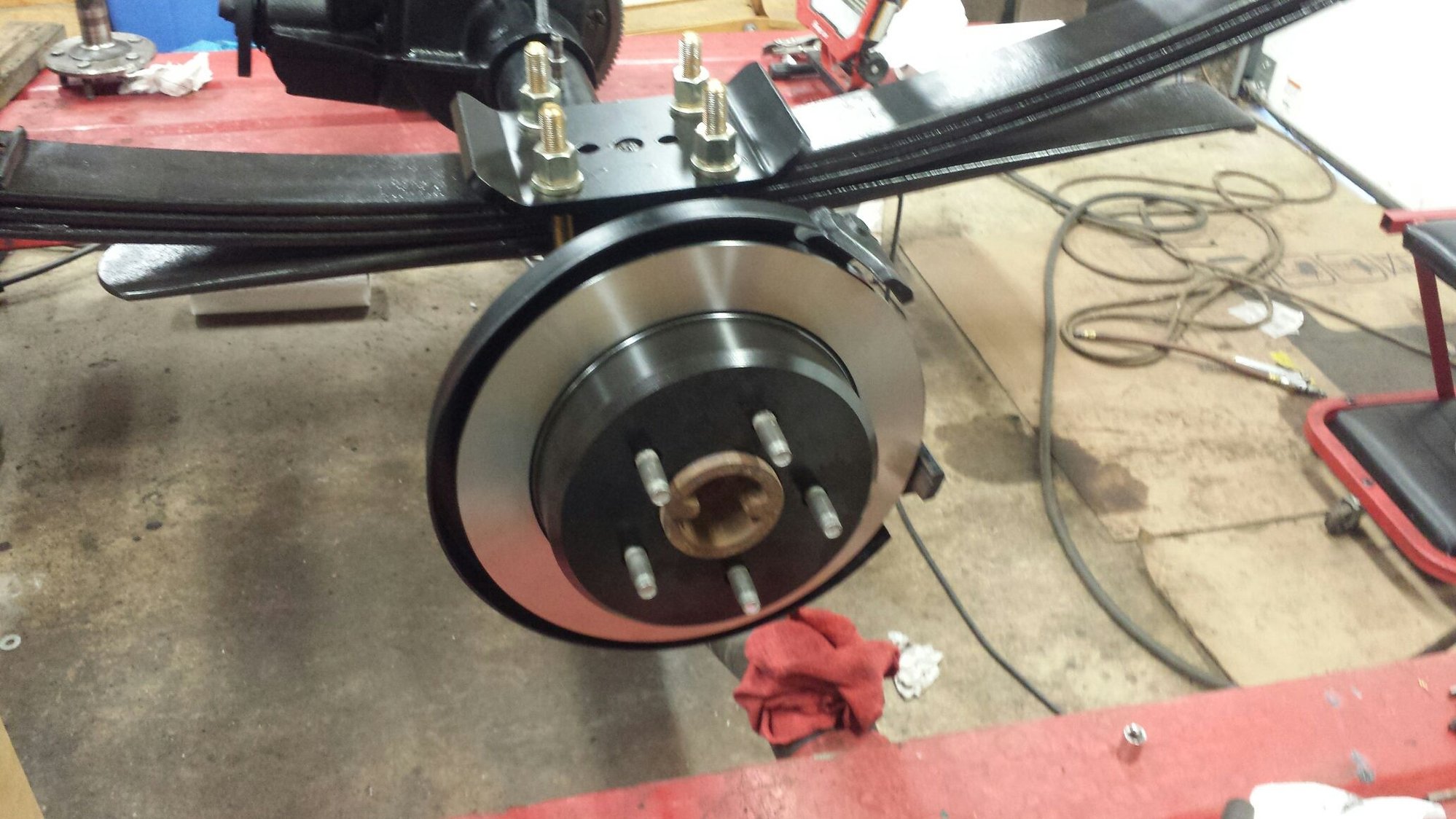

Here are the brakes. This part is pretty straight forward.
This picture shows the backing plate cleaned up and new emergency brake shoes.
Old Jan 18, 2018 | 08:28 AM
93 ragtop's Avatar
93 ragtop
Joined: Jan 2014
Posts: 1,852
Likes: 109
From: Va
Here is with the rotor and axle installed.
Old Jan 18, 2018 | 08:33 AM
93 ragtop's Avatar
93 ragtop
Joined: Jan 2014
Posts: 1,852
Likes: 109
From: Va
And here is with the wheel spacer I had to use to get back to the correct width. I dont like spacers, but it was this, or a different axle. On a positive note, I can still use 15 in. wheels with these disc!!
