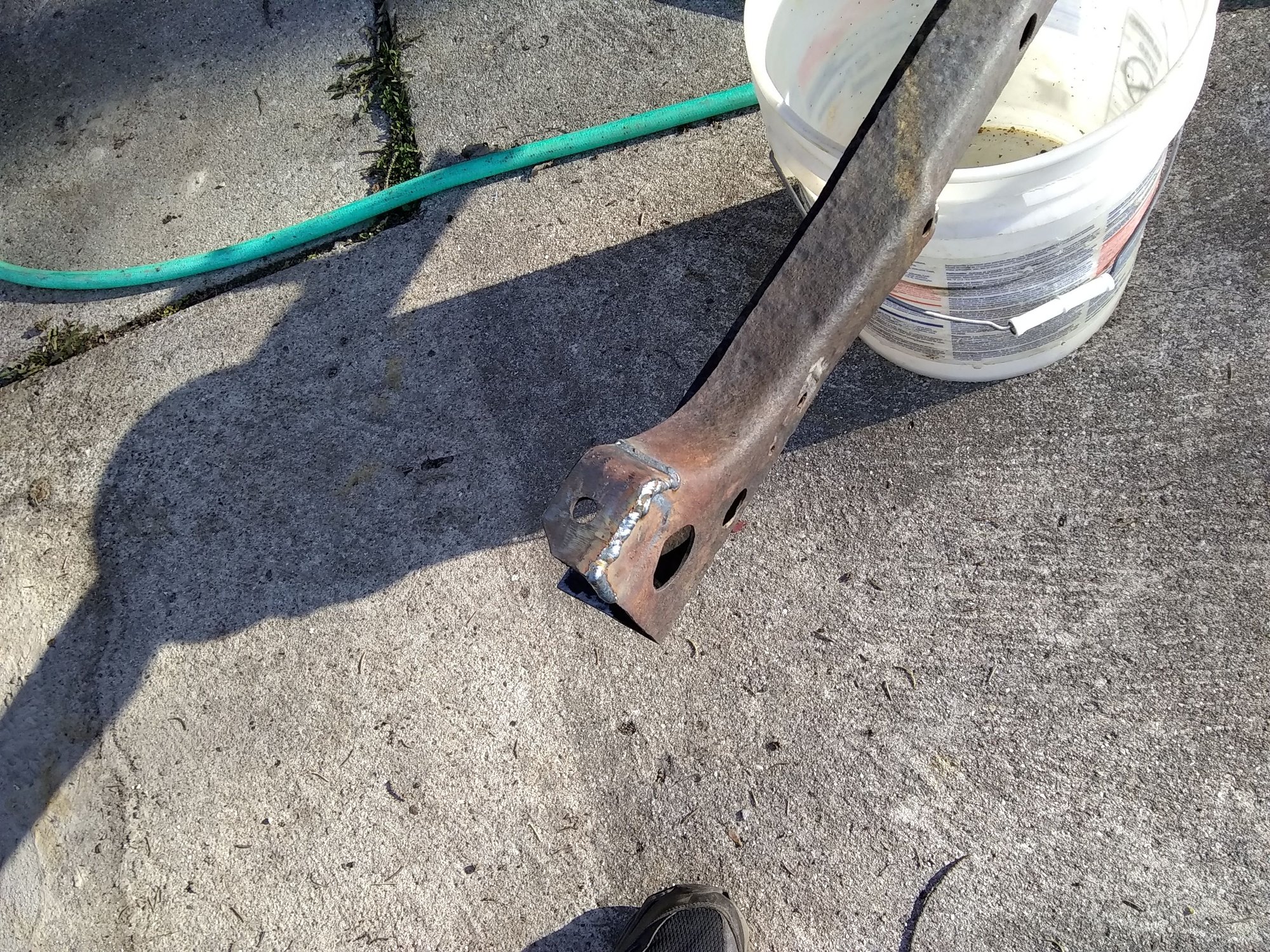

Built an electrolysis tank. Using it to do all the rear frame cross members. Here's a pic of the setup

So far it's been 8.5 hours. I pull the electrodes about every 2 hours and hit them with a wire brush real quick. Part was ridiculously rusty. Here's a pic after 8 hours

Go to your local hobby shops or look around online for some pure zinc bars or sheets, then do the electrolysis in reverse. If you use the link bar as your negative then your carpart as the positive you can actually zinc plate your part

Dang tank is working great. Had to go pick up some more washing soda from Ace hardware. I've got the last crossmember in the tank now. Here's the first crossmember I did, this is after tanking it, and repairing the bad spots.
