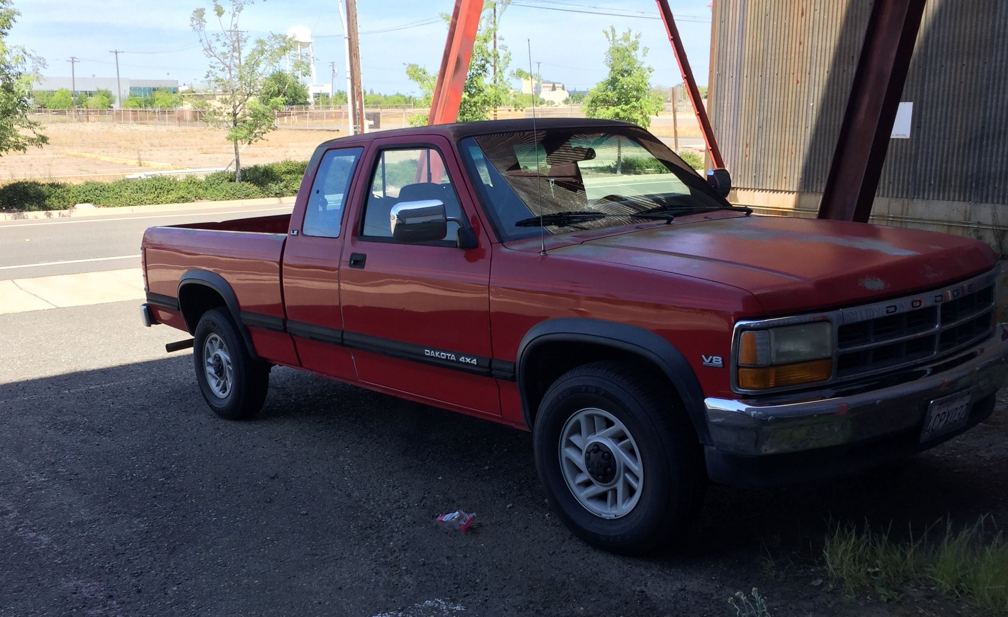

So I bought a 1993 Dodge Dakota 4x4 LE 5.2 L magnum took it to my mechanic and had it tuned up. Recently when I’m driving on the freeway The RPMs start to surge when I reach 60 mph. It goes from 2000 rpms to 3000 rpms then drops down again with no obvious reason. I can feel a pull when this happens. I am going to take it back to my mechanic but I also wanted to know if anyone had this issue? Also side note this truck has very low miles for its age 76,000.
