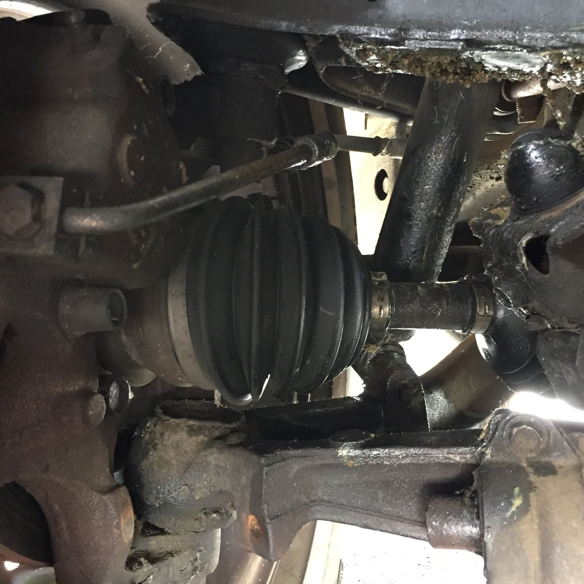

I own a 1993 Dodge Dakota 4x4 V8 and I started to hear grinding when I would apply breaks. I took off the tire and discovered that the top of caliper is rubbing on the inside of rim and grease has leaked out of a tear in the CV joint boot. I plan to replace the entire axle/CV outer and inner joint.

It hardly moves when I try to wiggle the tire.. but it does something weird while I jack it up. The more I jack it up the tire never seems to leave the ground. Yes I’m using a small 2 ton jack but it not the jack but the wheel hub/ suspension.. I’m going to borrow a shop jack and see if that does it. I was also thinking it might be a ball joint. * I checked the caliper and it isn’t loose or missing any bolts*

Default I took photos of driver side.

I'm working on it right now and the tire is leaning quite a bit (negative camber) so it seems to be the bearing and I surmise that because of the problem it has made the CV joint fail. I've checked upper and lower ball joints and they have no play in them. I also discovered that the rotor was cracked all the way through and break pads were wore uneven. Once I get it put back together again I will let you know if my repair worked.

Yes there is a matching wear mark on the top of caliper and the pads worn uneven also found the rotor to be cracked through. but even though the pads were worn they still had lot of pad left and not even close to the wear sensor. I'll post more photos of rim and caliper.
