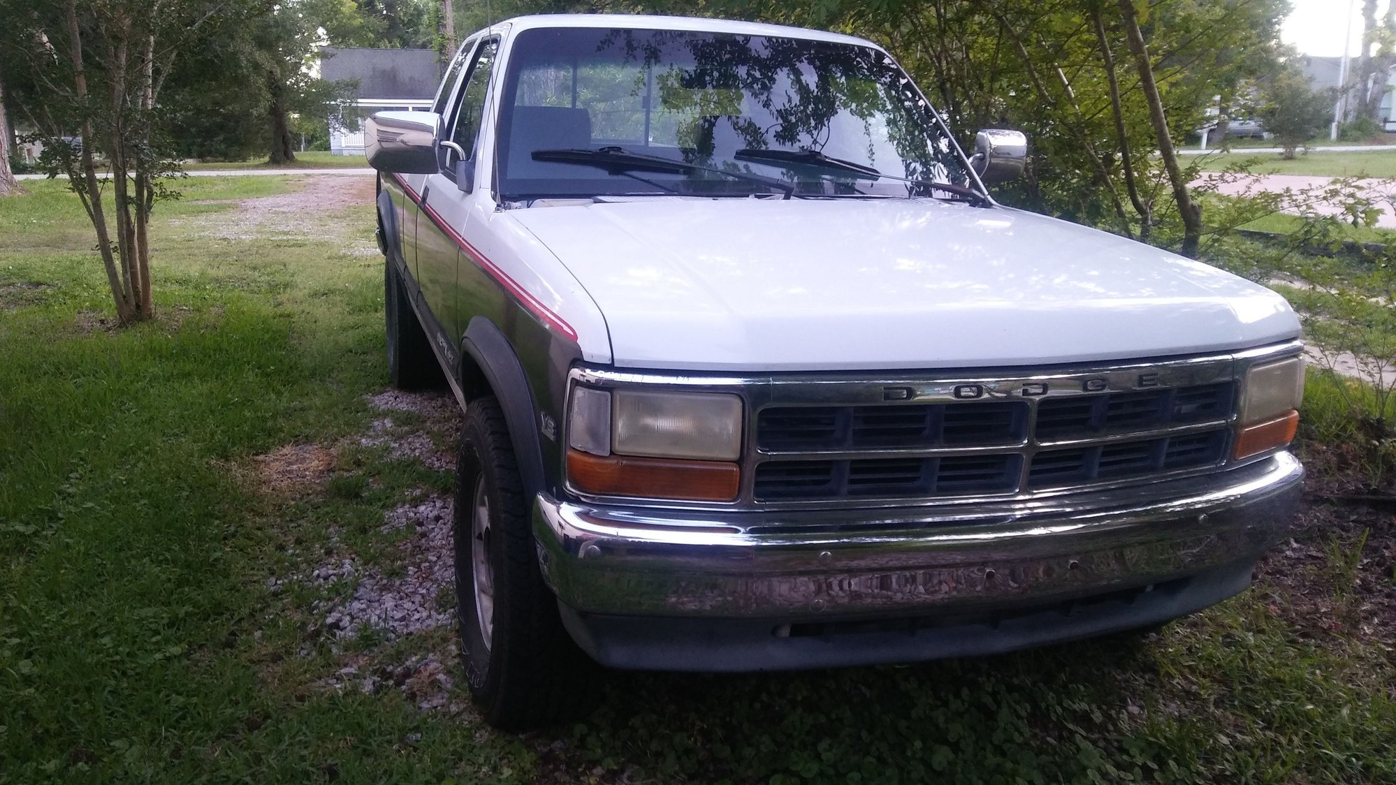

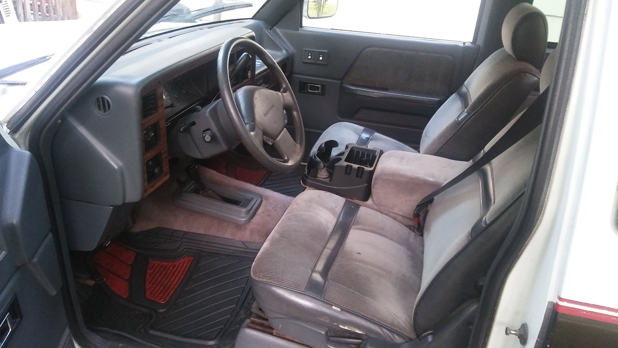

This is my 5.2l Dakota I bought a few months back for $1000 and just got it to my place about a week n a half ago and I thought it would be fun to upload my build progress and have yall help me along the way! the only things ive done to it so far is put in a new transmission, take out that annoying-*** buzzer, cleaned it out & gotten rid of the stains and installed a small center console but thats basically it. Some of the main things I want to do is put on a 3in lift on it, new paint job (thinking a dark silver would look nice), new wheels, and possibly a small tint and some performance parts (nothing too crazy) but yea let me know what yall think and your opinions on what to do and what not to do, im interested as to what you have to say, thanks for checking it out!

Thats a nice looking truck!! FWIW we love build threads!!
For the lift, I believe you will have to do a body lift......
No one makes a suspension lift for first gen's anymore
You can turn up the front torsion bars using a different key, but personally I would not. IMO this causes all kinds of suspension problems
