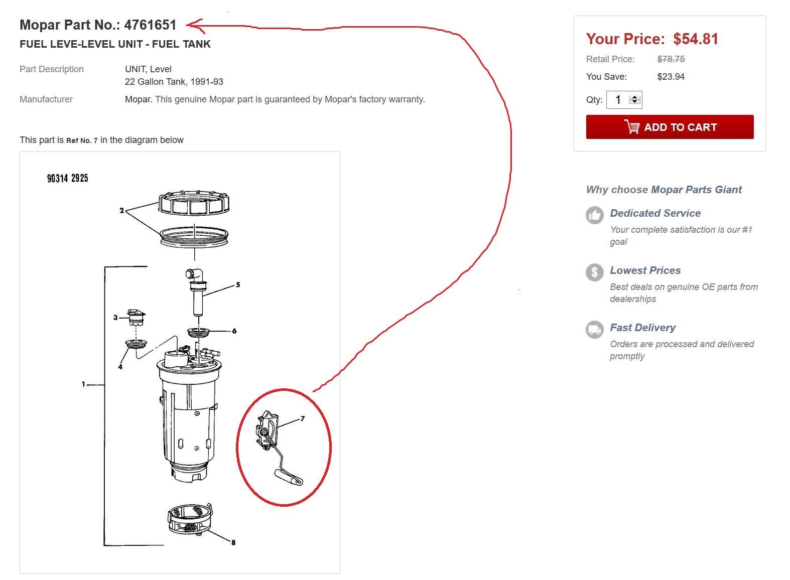

Has anyone here replaced just the sending unit...4761 651? Have a chance to buy a NOS one super cheap

For only about $50 to $70 more you could grab a Denso or Delphi complete assembly, save the roll over (and maybe including that!), and swap it out a lot quicker.
And have a new pump instead of one that may work another 30 years, may die as you're putting it all back together.

denso assembly runs $165 but it doesnt have rollover valve. cut the old one out of the other pump with a dremel, being careful not to damage the rubber gromet because that has to be reused aswell. prying it out with a screwdriver will likely break it. if you have no history of the old pump i would just drop in a new assembly
