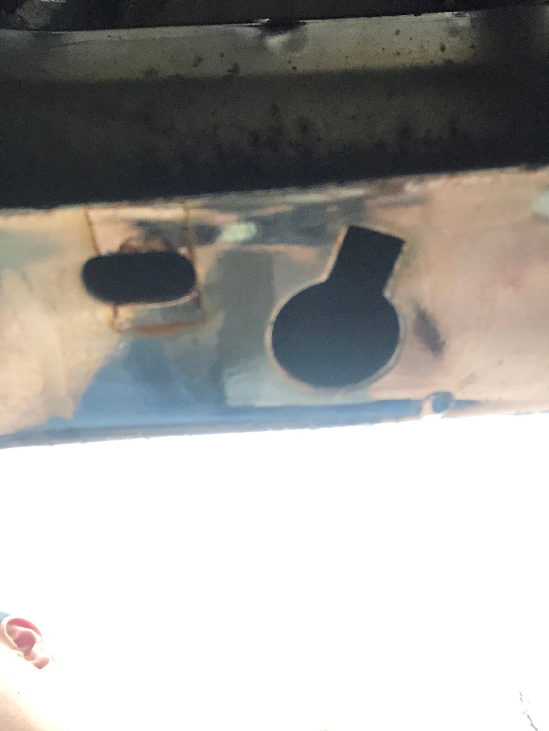

Well my truck didn’t come with a valence on the bumper but where the clip would go into the bumper it’s pretty much drilled and all I did was bolt them in

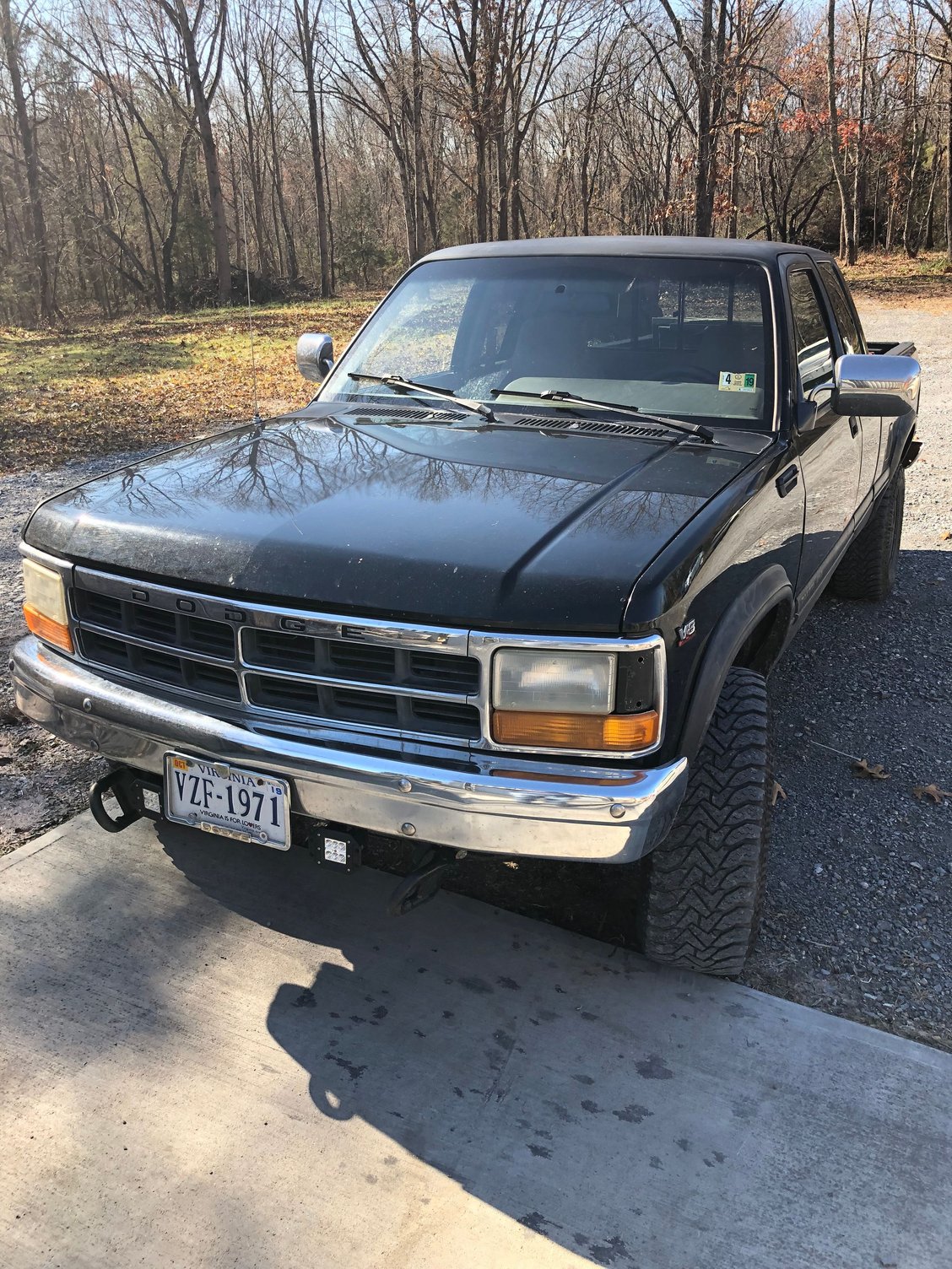

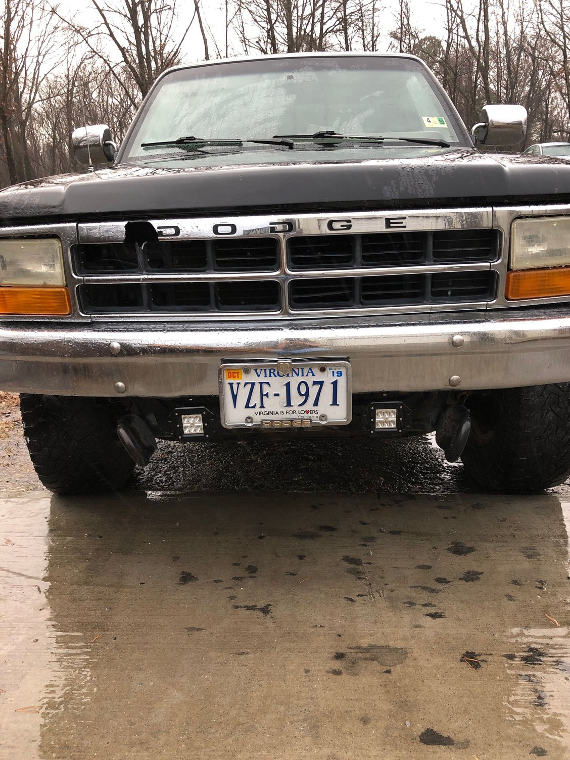

What year truck are you working with? FWIW I have been looking at a 91 S-10 valance for fog lights. Want to measure one and see if it would fit my 87.
