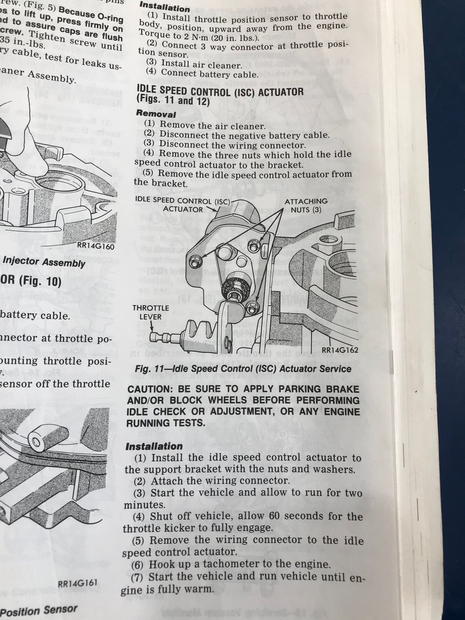

ECT - sorry. Engine Coolant Temperature sensor. You're supposed to disconnect it, which causes the ECU to pull all timing. There's a sequence to it, covered in the FSM.

I figured that's what you meant. Here are two pictures from the 1988 Dakota Service Manual from Chrysler Motors says:
RwP
Old Apr 17, 2019 | 12:14 PM
RalphP's Avatar
RalphP
Joined: Jan 2013
Posts: 4,737
Likes: 374
From: Northwest Louisiana
Yep, that's the method.
