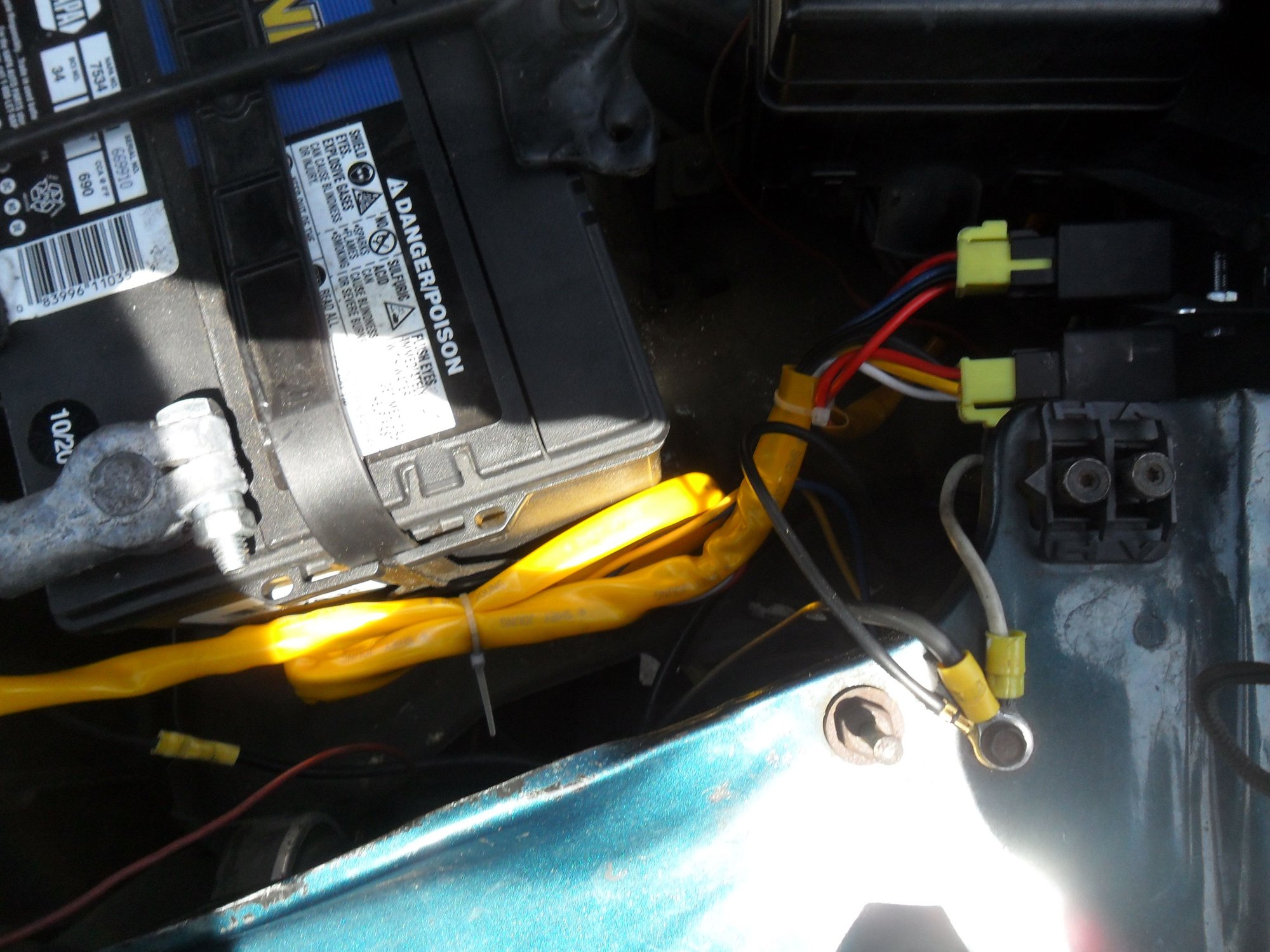

OK I need some info. Does this setup abandon the current plug for the passenger side? The driver side has the socket for its current plug to go into but the passenger side only has the one new plug to stick in the back of the light bulb. I'm gonna go put the Mopar Crank sensor in while I wait for a reply. Oh yea how did you guys route the harness across to the passenger side?
The kit says 9007 on the tag. the selection was for 9004/9007. I may need help with that later to repin.

Yep, only need to hook up one side of the bulb connector, as all it does is control the relays. The relays are what supply power to the bulbs.
I routed the passenger harness across the top of the radiator support. There was a convenient 'valley' all the way across. Dak is likely different though.....

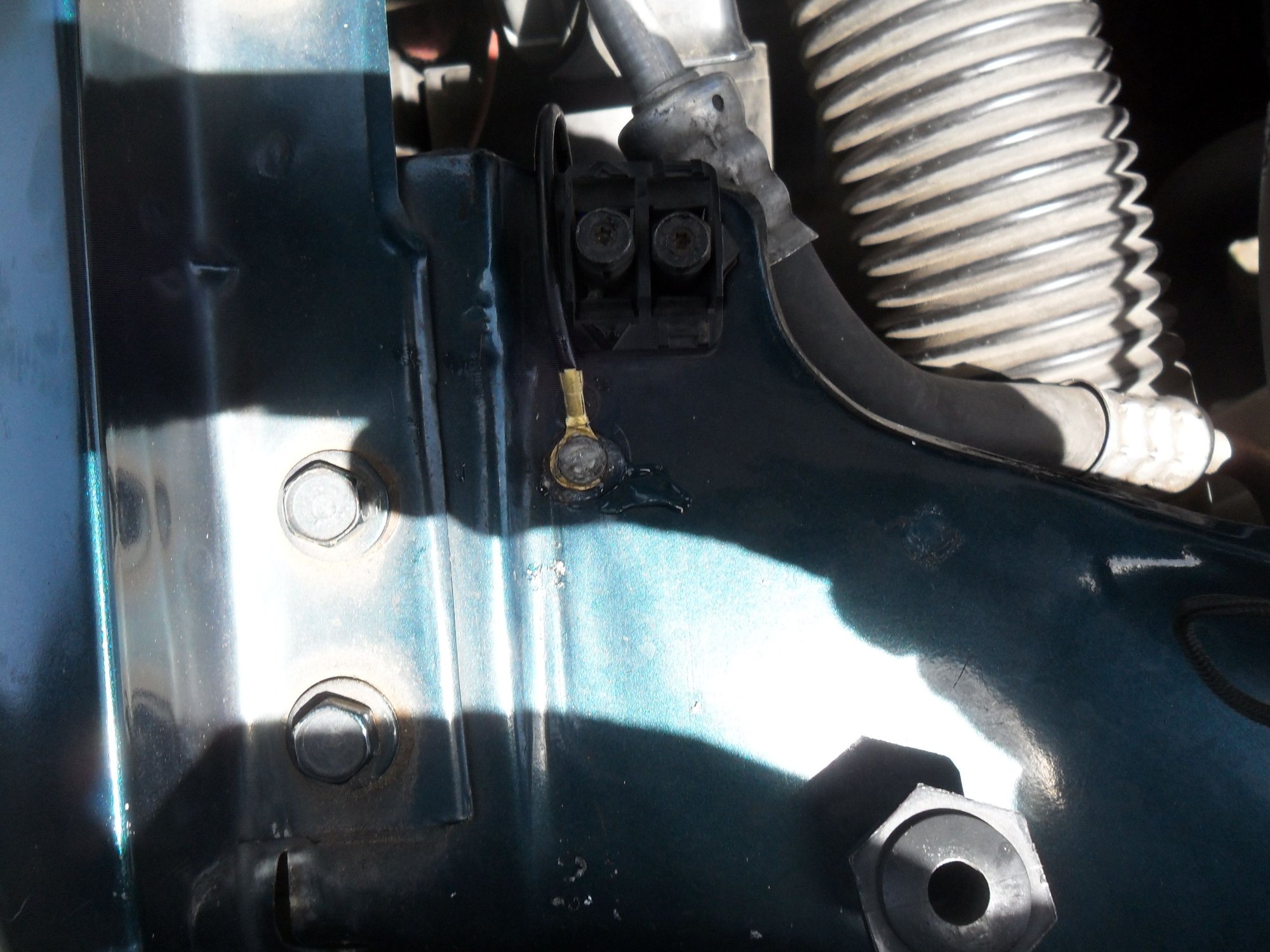

OK lights in. They work. Learned something new. If you over tighten the screw that holds the new switch to the bracket it is attached to the light pull will not lock into place, Here is a picture of how I mounted the relays on the bolt for the relay box with grounds there and the passenger ground I put dilectric grease on it to slow the rust. That's just an old sheet metal screw I found laying around. The harness went right over the radiator slot.
