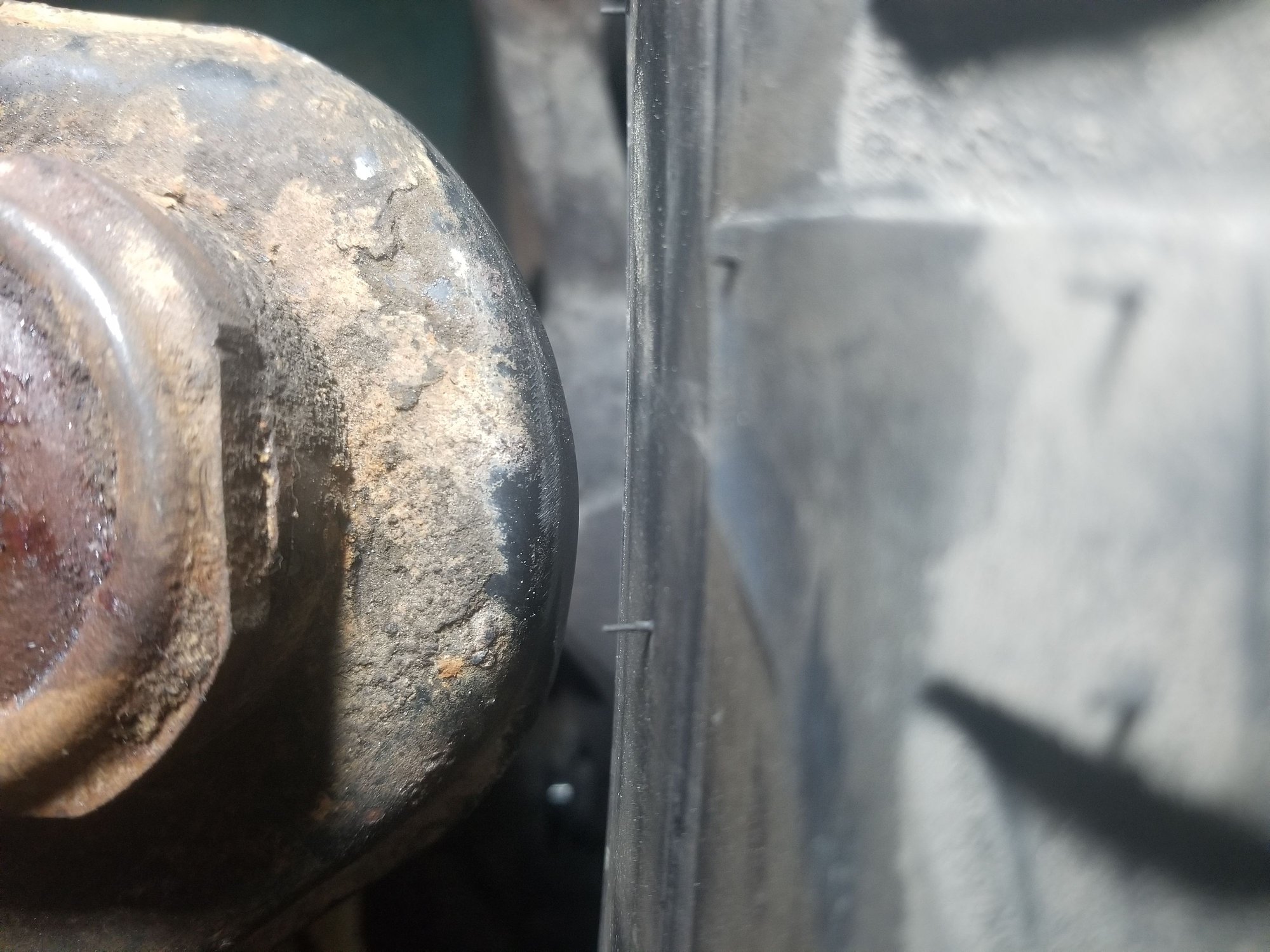

I was referring to removing metal so it doesn't hit the tire.......
oh k, I'd sat minimum of half of that lower lip in the pic with the red circle, and most 3/4, not the angles part, the very bottom

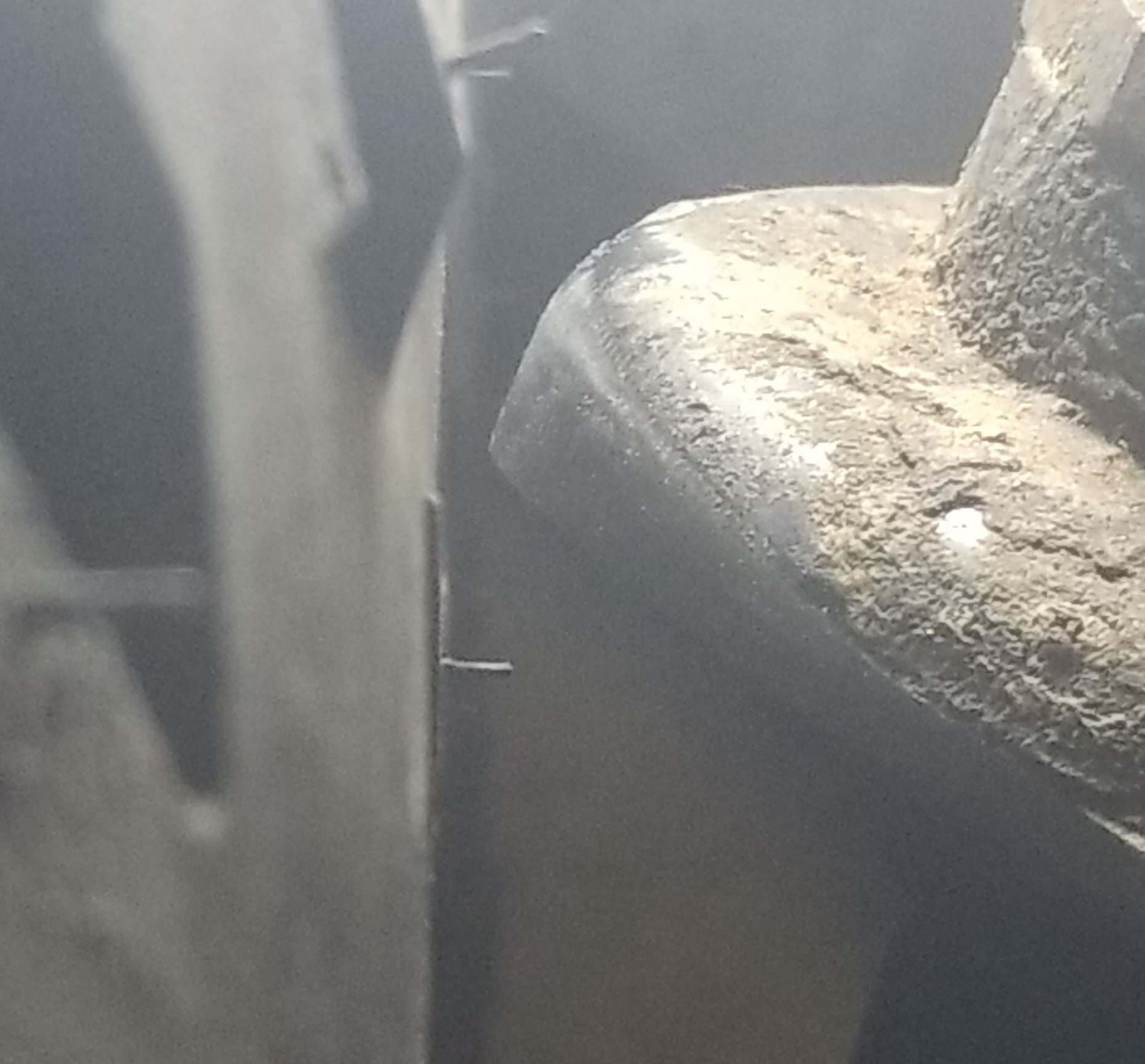

UPDATE!!!!!!!!
I just got home and went out in the
Gonna flatten this out a bit wanted to post teh results asap though
Clarence ( actual
barn and ground one side down it clears the tires now gonna do the other side here after supper, and I'm back in business, here's pics
