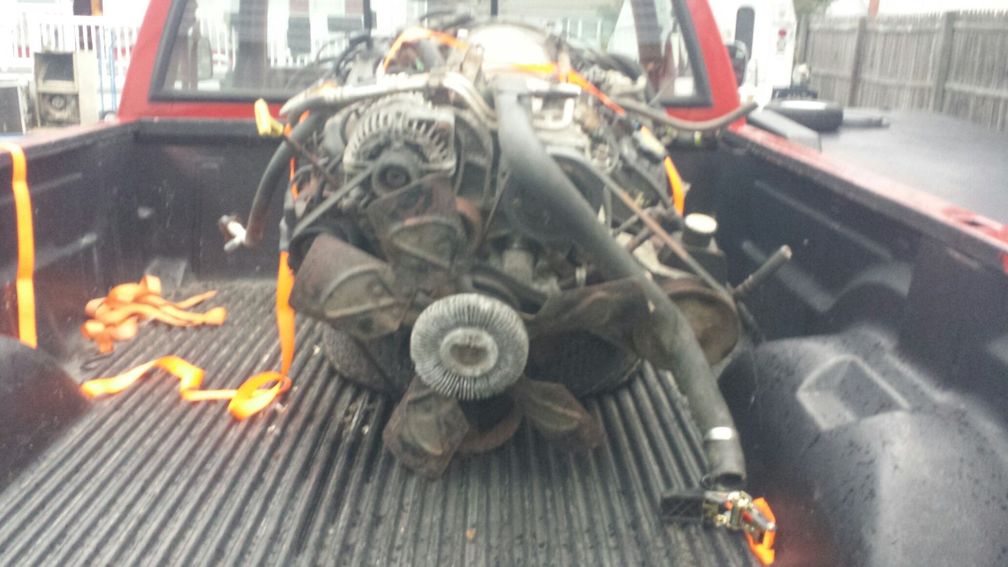

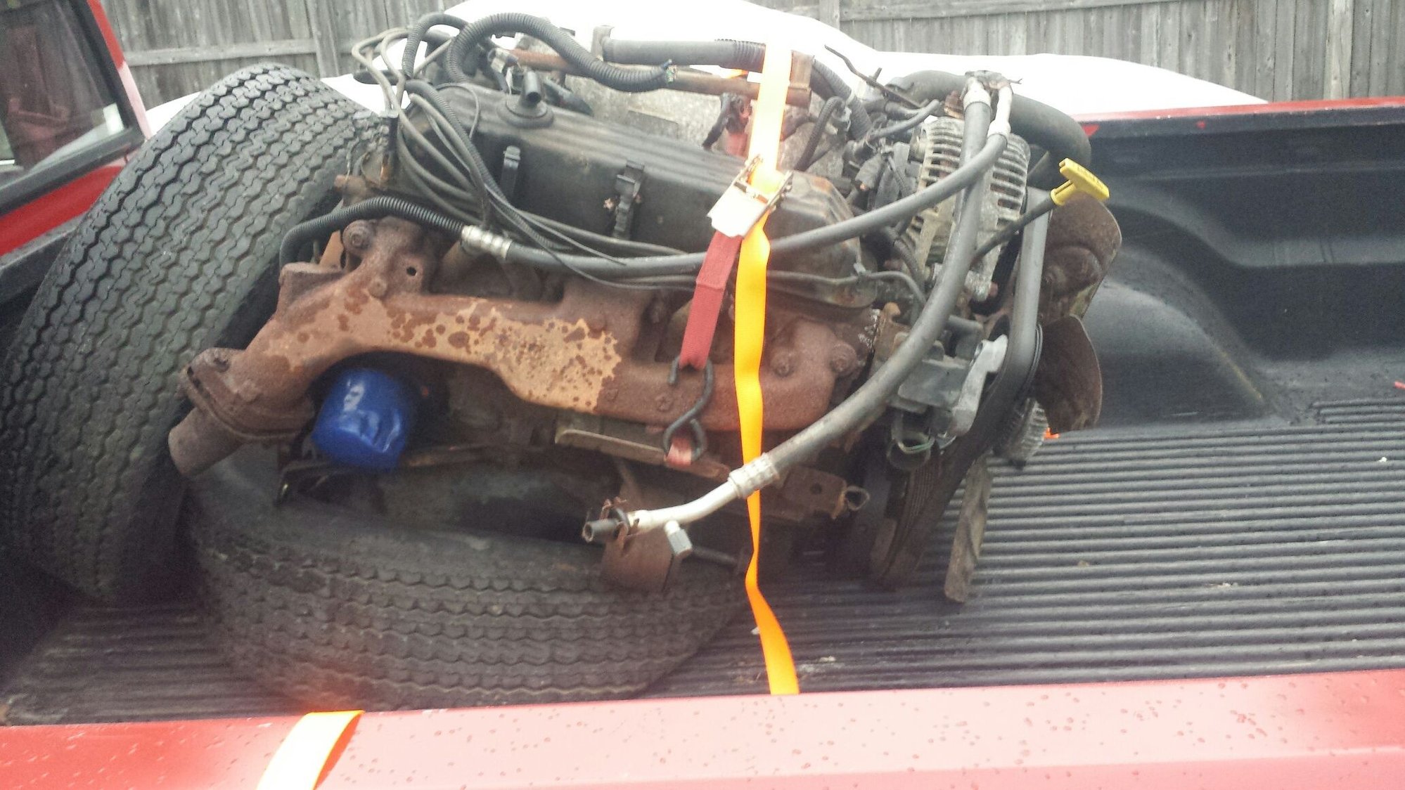

I picked up a 5.9 out of a 2000 ram.... Came from a forum member.
Here are a couple of pictures.
Hopefully will get it stripped down to the long block and then go from there...
Will be putting this in my 87

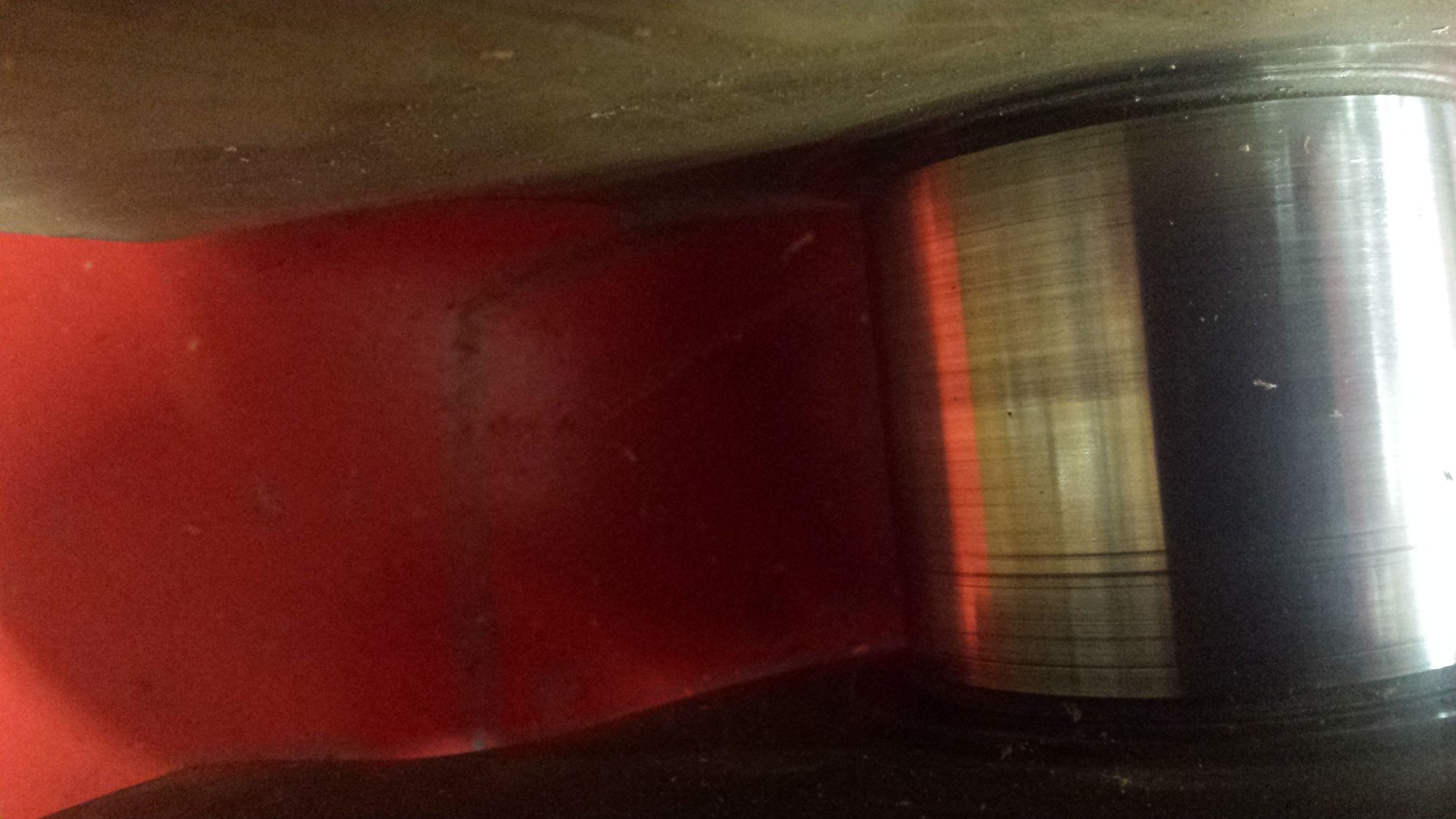

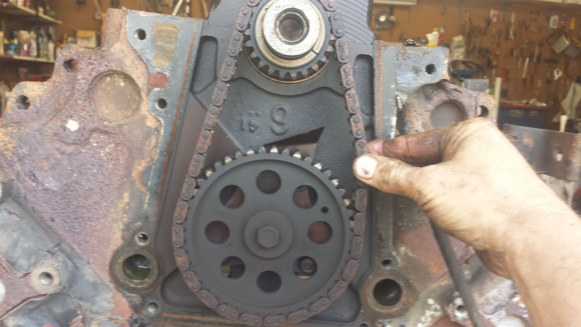

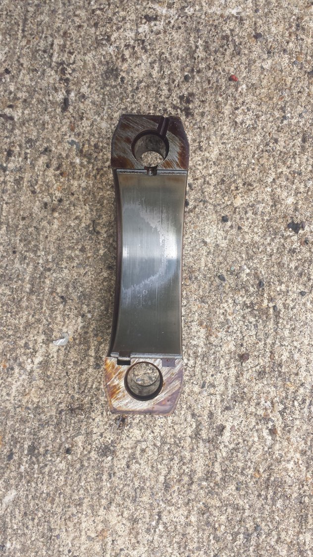

Wanted to update this thread. Stripped the engine down to the long block, pulled the oil pan and then pulled the rod cap from number 1 or 2, cant remember which..... but here is what I found.

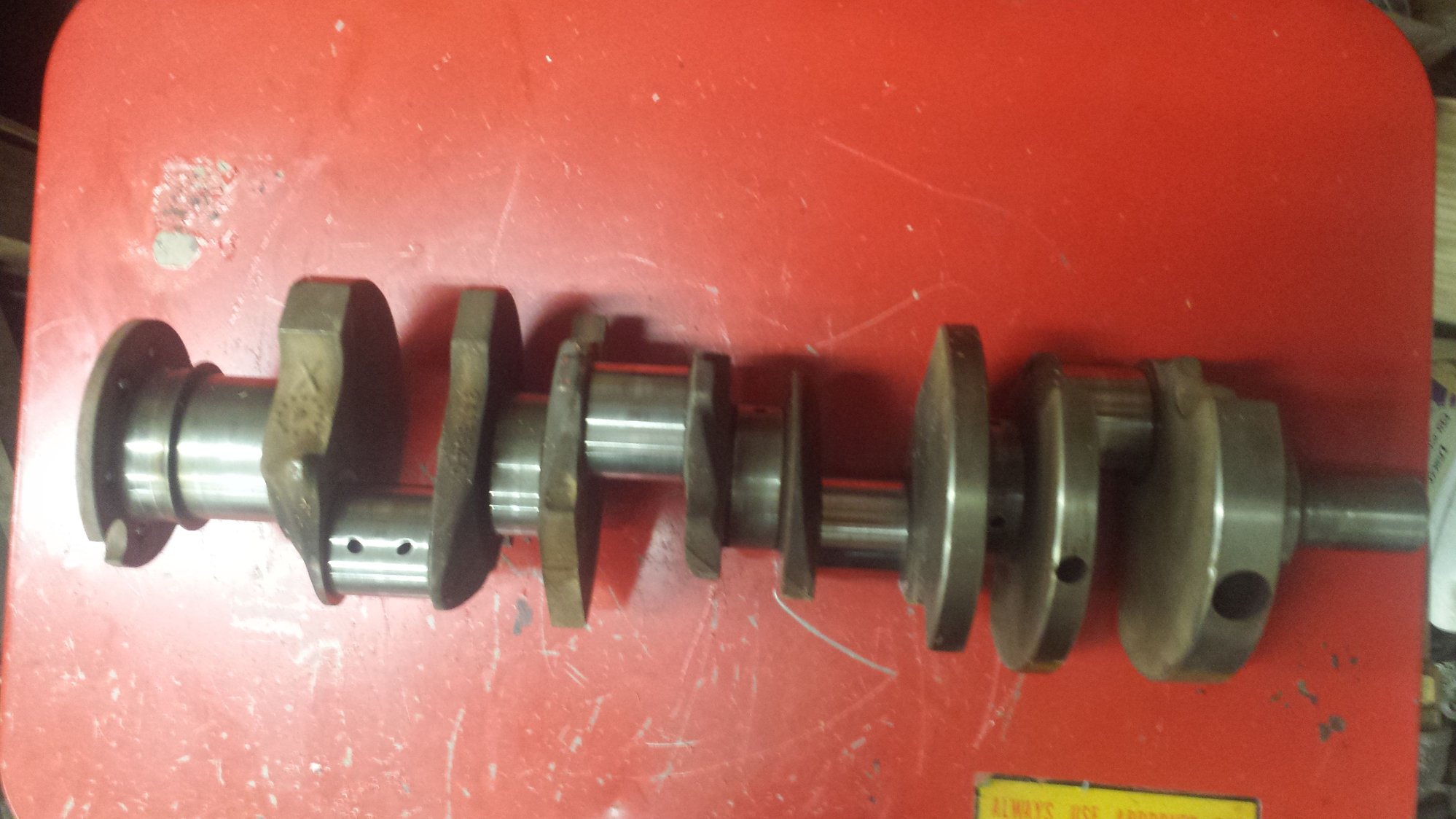

Decided to go ahead and disassemble the motor. Here are a few pictures of the crank.
I ordered a crank through advance auto parts..... getting the crank with bearings for about $155.00

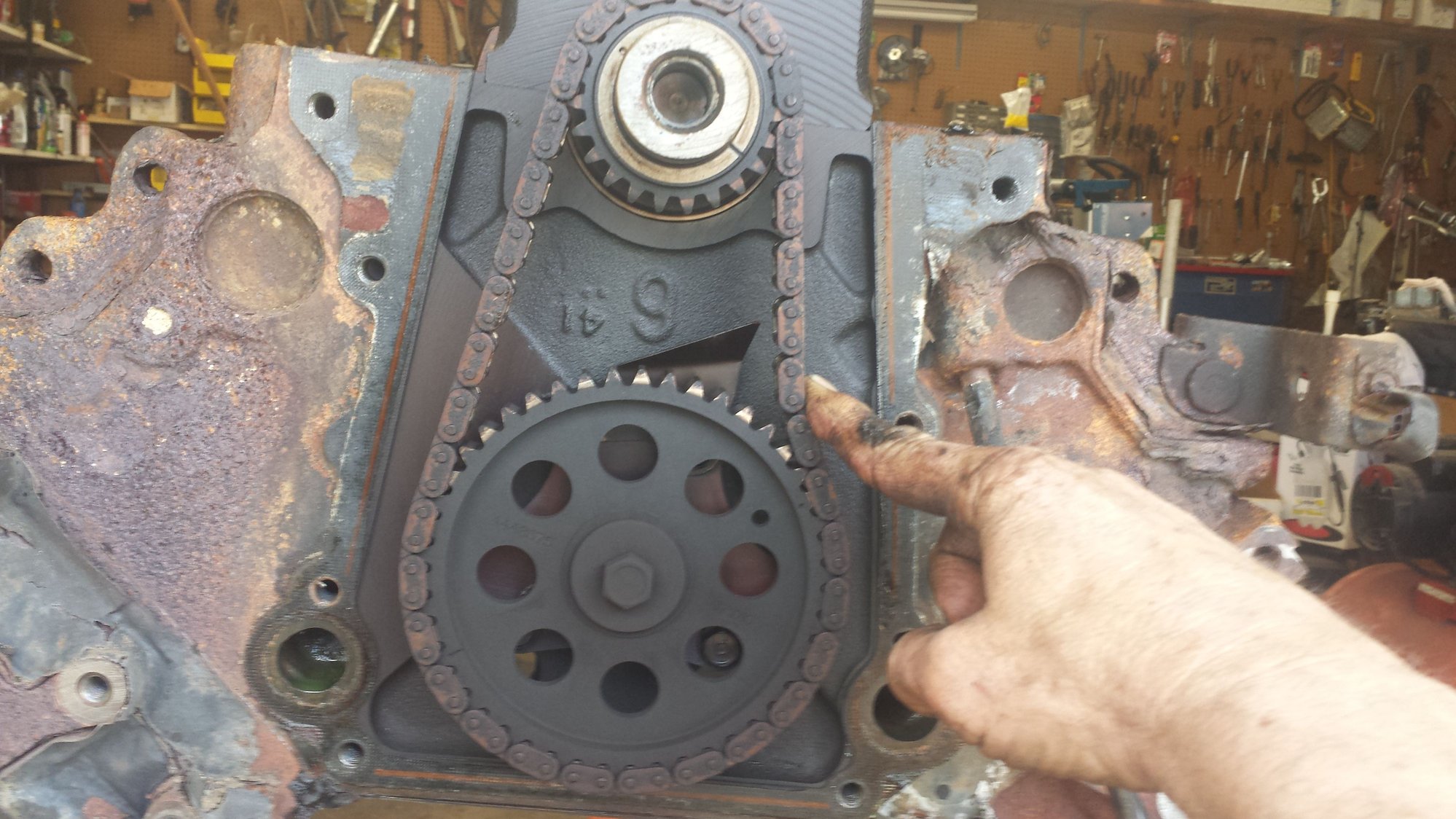

Here is the timing chain, which is to be expected

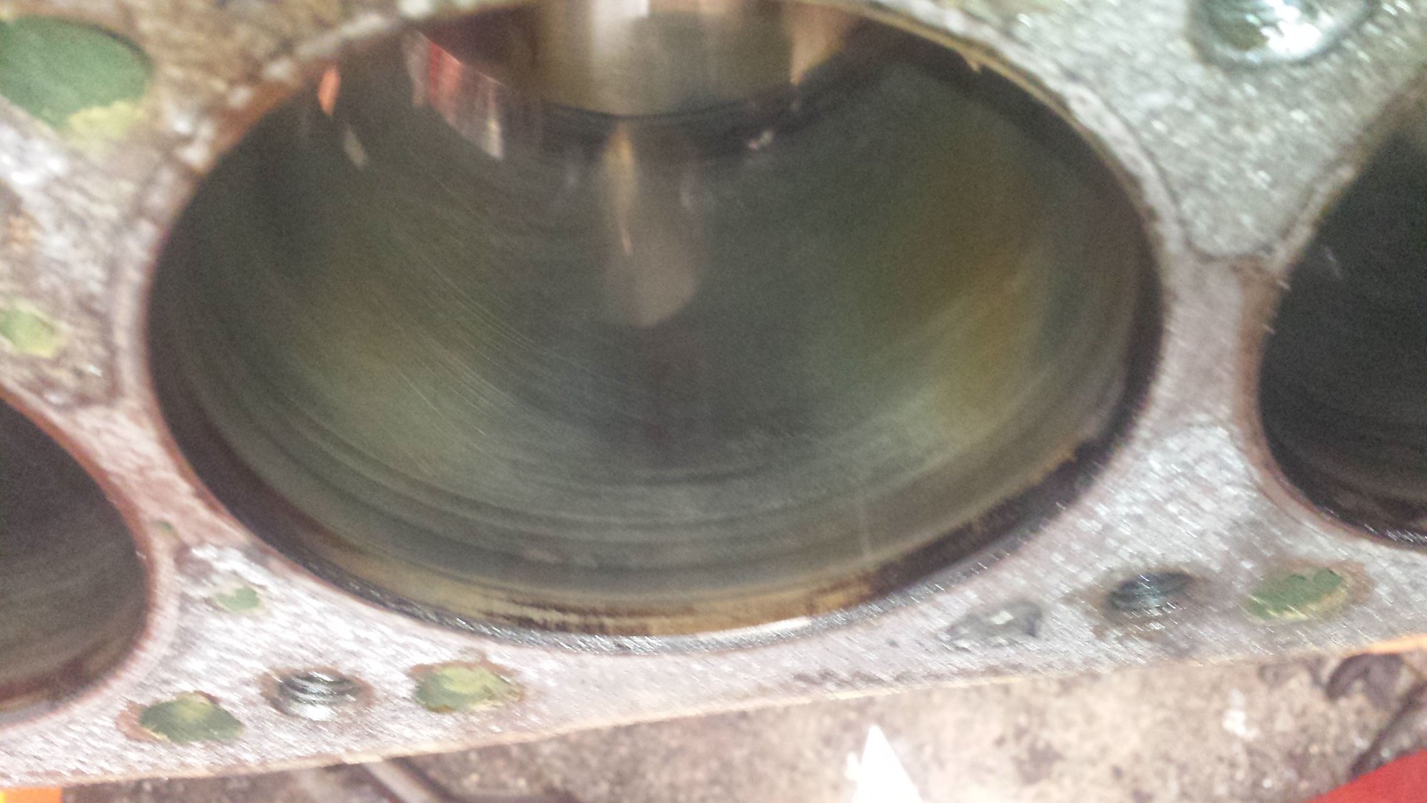

The block looks pretty decent, as far as I can tell. Still see the cross hatch in the hone.

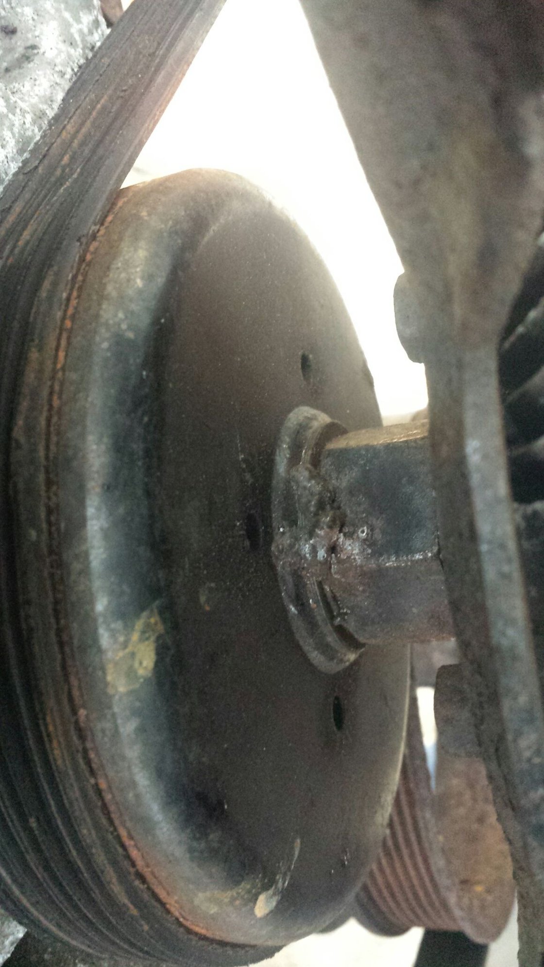

It would appear that someone had problems with the fan backing off!! I ended up cutting one blade off, and then could reach the waterpump bolts.... Not a big deal, as I am replacing the water pump and will be running electric fans.
