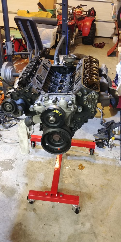

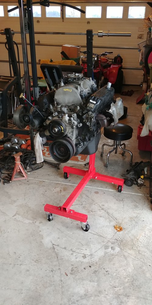

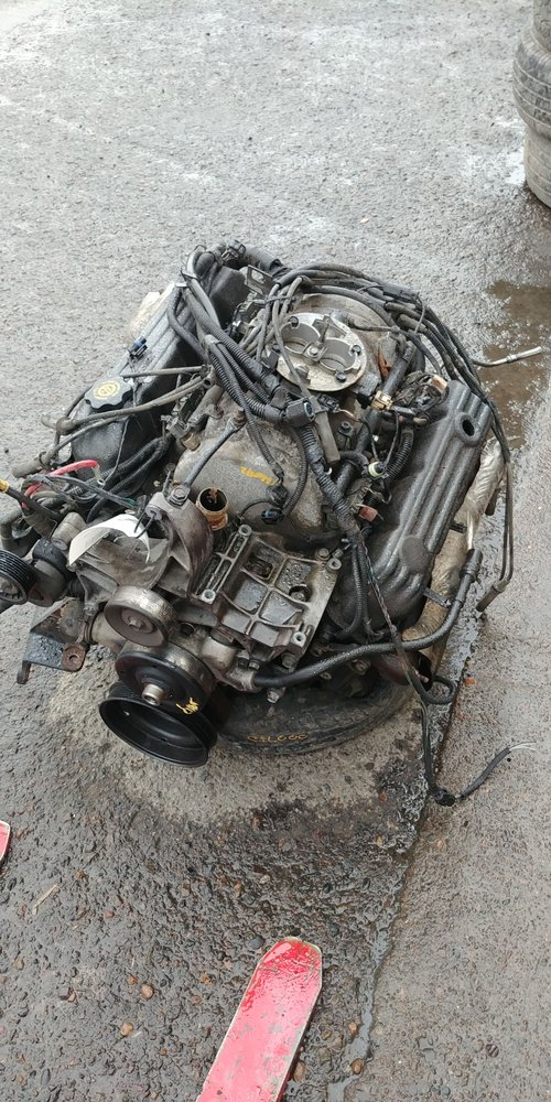

Got the engine from B&R Auto Wrecking, out of a 1997 Jeep Grand Cherokee.
Cleaned it up and got it up on a harbor freight engine stand.

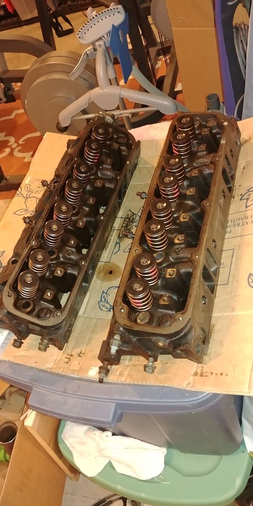

Pulled the valve covers and intake manifold. Everything looks like it's in great condition.

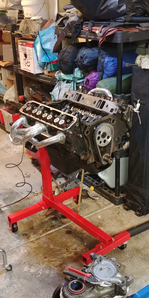

High volume oil pump from Melling. I put it on before I realized I needed a new pickup tube to fit the Dakota oil pan.

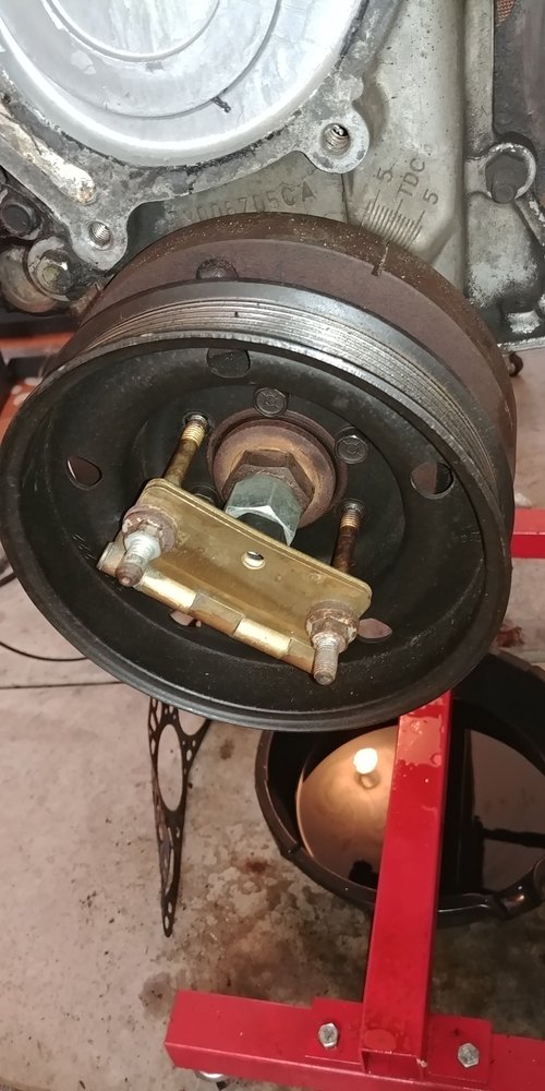

Pulled the balancer with a door hinge and the exhaust manifold bolts.

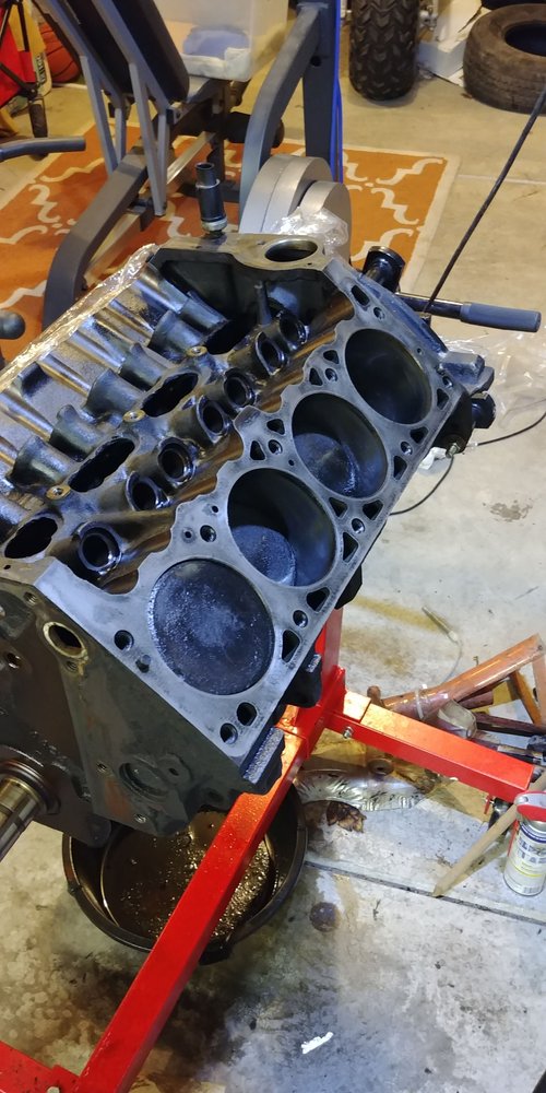

Cylinder walls look great.

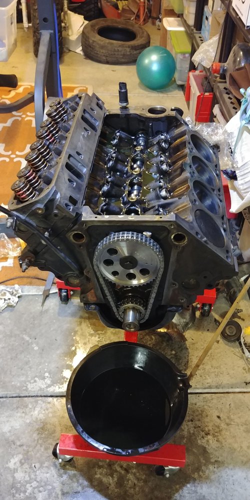

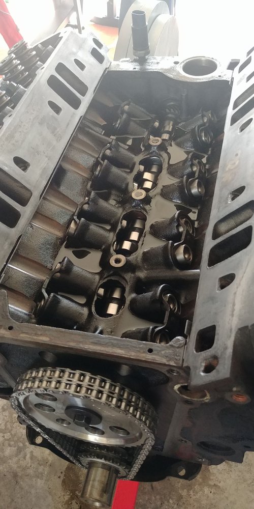

Removed the lifters and camshaft.
Replaced the stock valve springs with Hughes Engines performance springs. (Hughes Engines 1199)
Replacing the camshaft bearings. I messed them up while removing the camshaft...
Soaking my new Melling lifters.
Installed a new Comp Cams camshaft. (20-744-9) (Comp Cams 20-744-9 Summit Racing)
And primed the oil system by spinning the camshaft with a drill, before installing the timing chain.
Heavy duty Fel-Pro headgaskets.
Timing set is billet steel true roller, from Cloyes.
Pacesetter shorty headers, from Rockauto.
New plenum gasket, and I coated the gasket with black RTV as well. Hopefully it doesn't blow out.

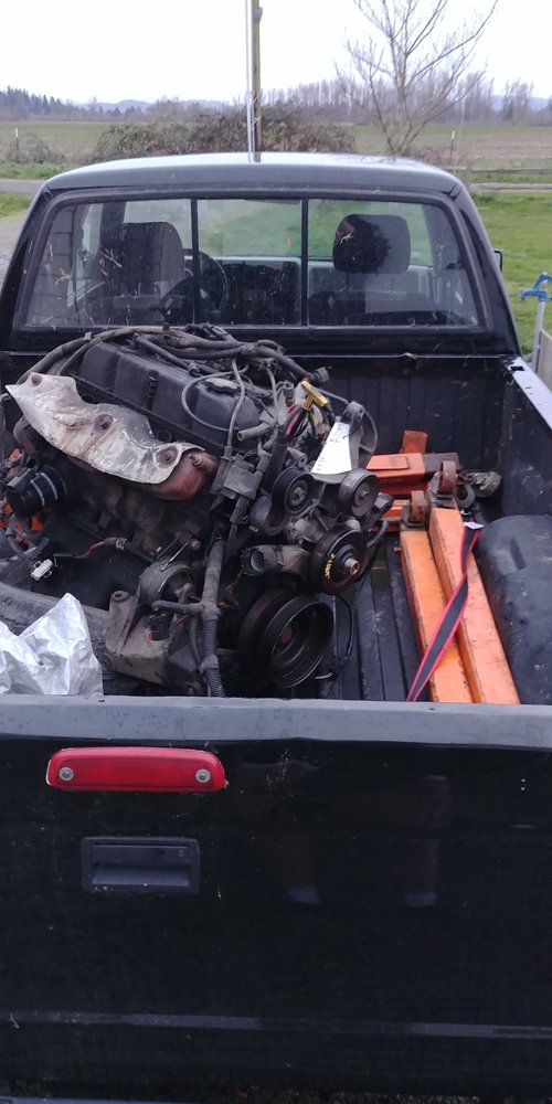

Beginning the process of pulling my old V6.

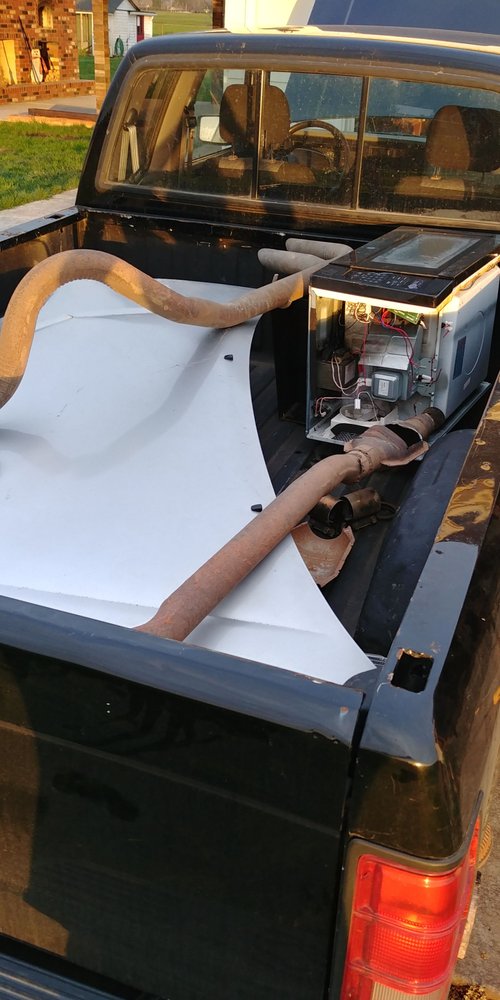

There's the inside of my cat, it blew out last year.
Stripped down the old engine.

1) I'm not changing the crankshaft or rod bearings, or piston rings, they appear to be in great condition. This engine made 180 PSI compression on all 8 before it was removed from the original vehicle as well. This is my first engine "rebuild" so if I had the tools and the experience, maybe I would. I did change the camshaft bearings though, but I sort of had to after I messed them up.

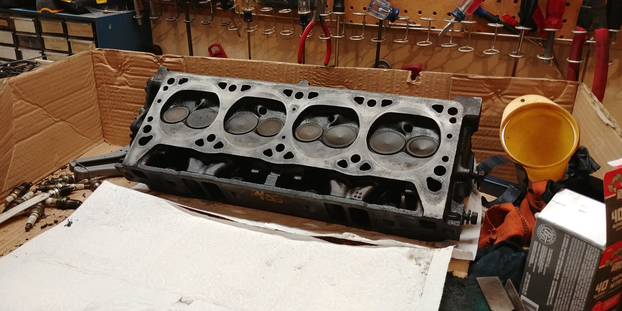

2) I did not get the heads checked. Maybe if I was going for an extreme performance build I would, but I checked them over when I had the valves out, and didn't see any cracks or anything.
