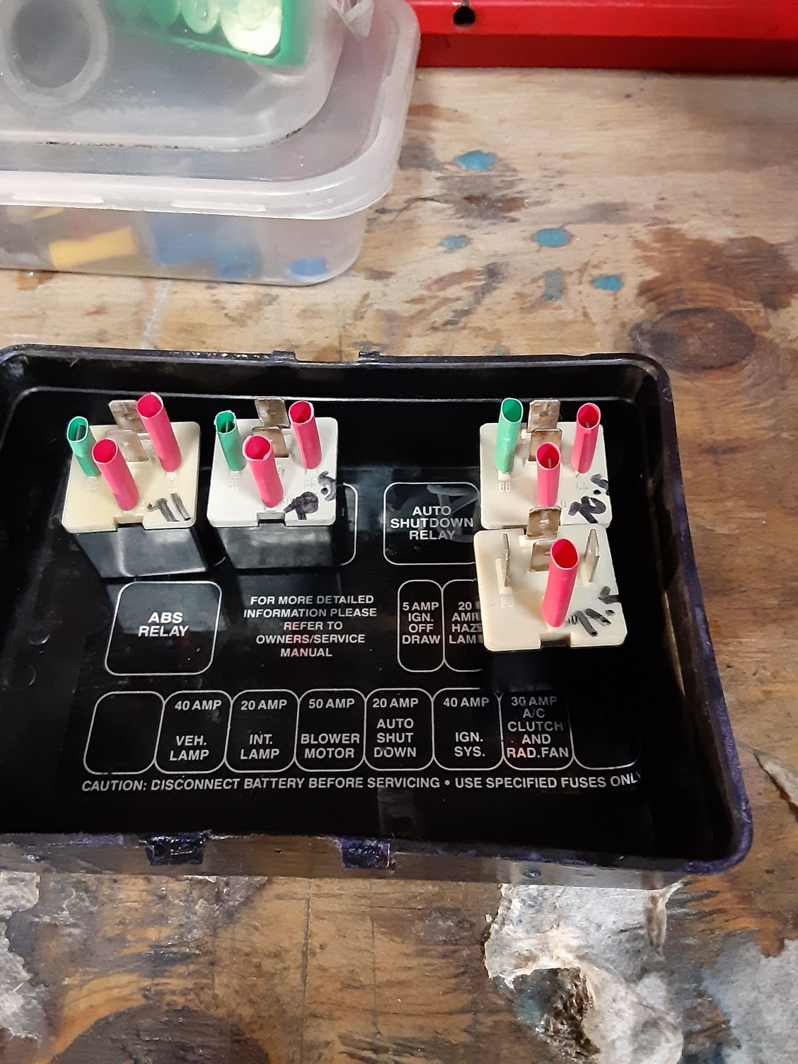

This is pdc test light readings in (run) position @the pdc(relays would be upside down dropping into pdc viewed as shown, colors are of pdc terminal readings
Resistence on relays are. 70.5, 71, 70.5, 71.5

Pdc readings

The coil readings are about right for out of circuit on the relays (they're nominally 80 ohms, but that's a +- 20% reading, according to Bosch.)
