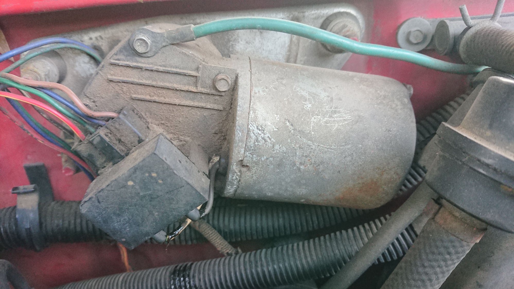

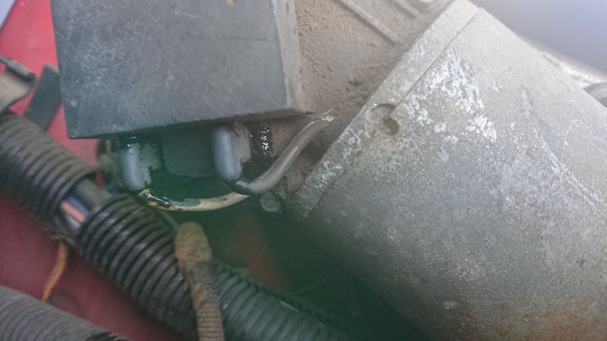

I was out poking around under the hood and ran across some melted connectors on this unit mounted on the firewall, but I don't know what it is. Obviously melted is bad, but what is it, and could it cause the truck to cut out?
Connectors:

The device in your pics is the windshield wiper motor. That shouldn't cause a no start.
