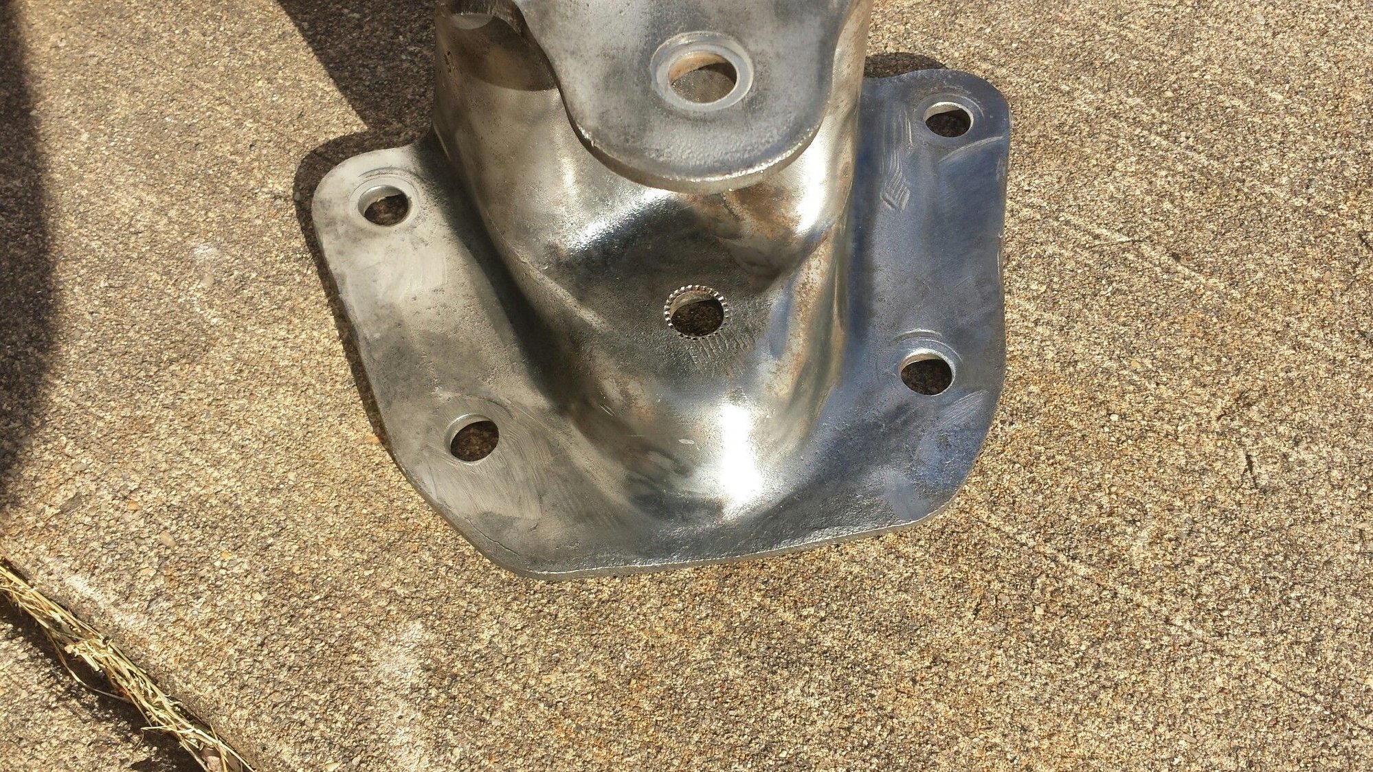

If you dont have any luck finding replacements, you may look at a Dorman catalog for pictures of other vehicles that may be made to work, ie. by drilling new holes, etc.
Attached is a picture of the ones on my 87, and if you need any measurements, let me know.
FWIW, I would suggest removing the bed to replace them. Those things were a pain to get cut off. It was cut the head off the rivet and then drive the rivet through. It took a lot of force, and its going to be hard to do with be bed on.
Here is the picture.
