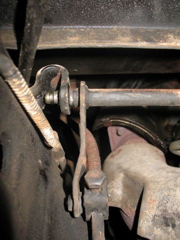

Hello,
My vehicle is having some slop in the gear selection and every so often it won't start until I fiddle around with the gear shifter.
The vehicle has the 5.2L with the 46RH. I went under the vehicle today and found that one of the bushings in the shift linkage is totally destroyed. It's the blue piece in the photo - PN 3575434.
Or item 8 in the diagram below:
https://www.moparpartsgiant.com/part...ub%20Cab%202WD)
I found a part on eBay, but it's pretty spendy for a piece of plastic.
https://www.ebay.ca/itm/NOS-MoPar-19...IAAOSwqoxcOMo~
Also shipping is outrageous to Canada and it's gonna be a long time to wait.
Does anyone know where I can find these in Canada or is there an alternative part number that someone has come up with? Says discontinued at the dealer unfortunately.

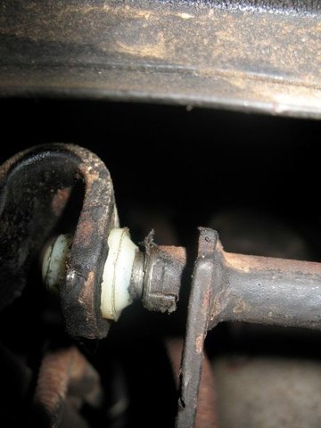

Had the same problem Wolf except the white bushing toward the outer part of the truck failed. My dealer found the replacement part (after a long search). He found two and I bought both of them (they were inexpensive). Kept one for backup. Not sure about the blue bushing toward the inside of the truck. Try to replace it all if you can because it's just a matter of time before it all goes. This seem to be a fairly common problem with these Dakotas.
After fix....

Wolf, the Dodge part# for the white bushing I discussed in my previous reply is #5211845131E (maybe 5211845 131E or just 5211845). This might help you or a parts guy trace it back to the blue part you need.
