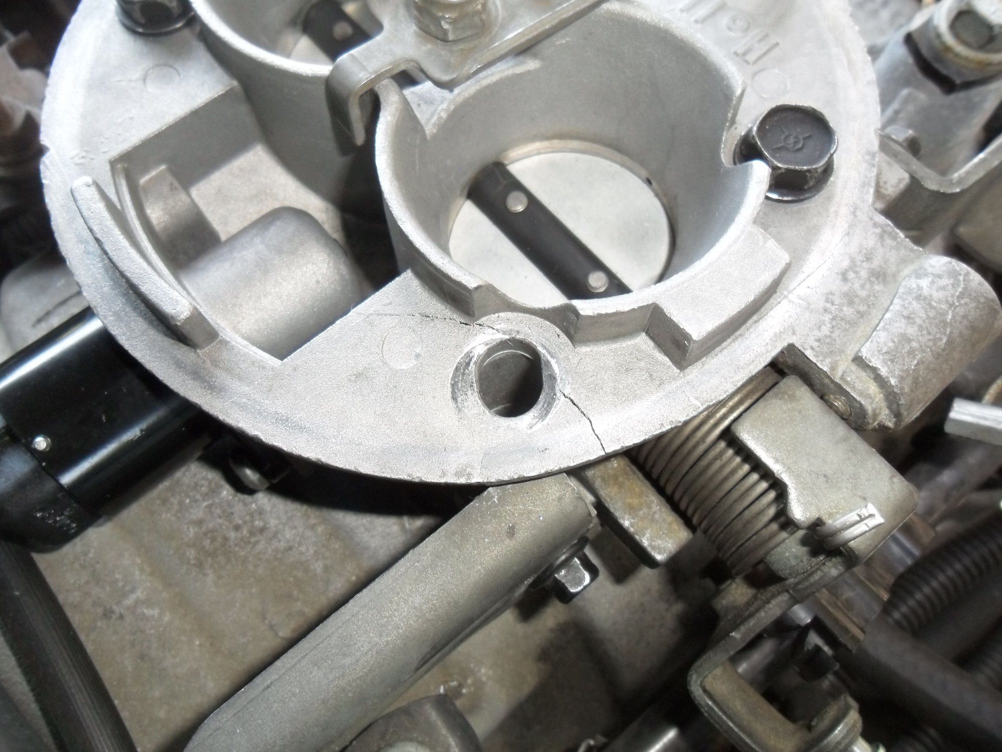

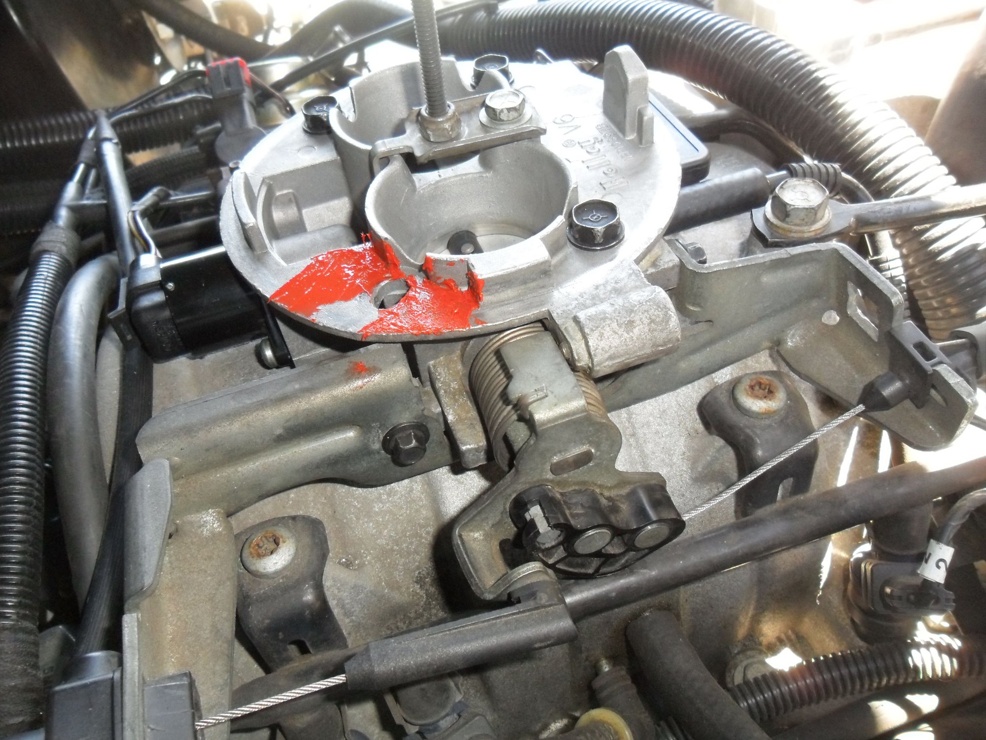

As I was putting it back together I noticed the crack in the TB. I have a temp fix going with some gasket maker. It is drying now. Look at the picture. Is that crack going to affect how it runs? AFAICT it does not run down into the galley for the IAC but I coated it with gasket maker anyway. I guess I am asking if I should replace it.

I'd consider replacing that throttle body, yes.
But I bet it wasn't hurting anything there.

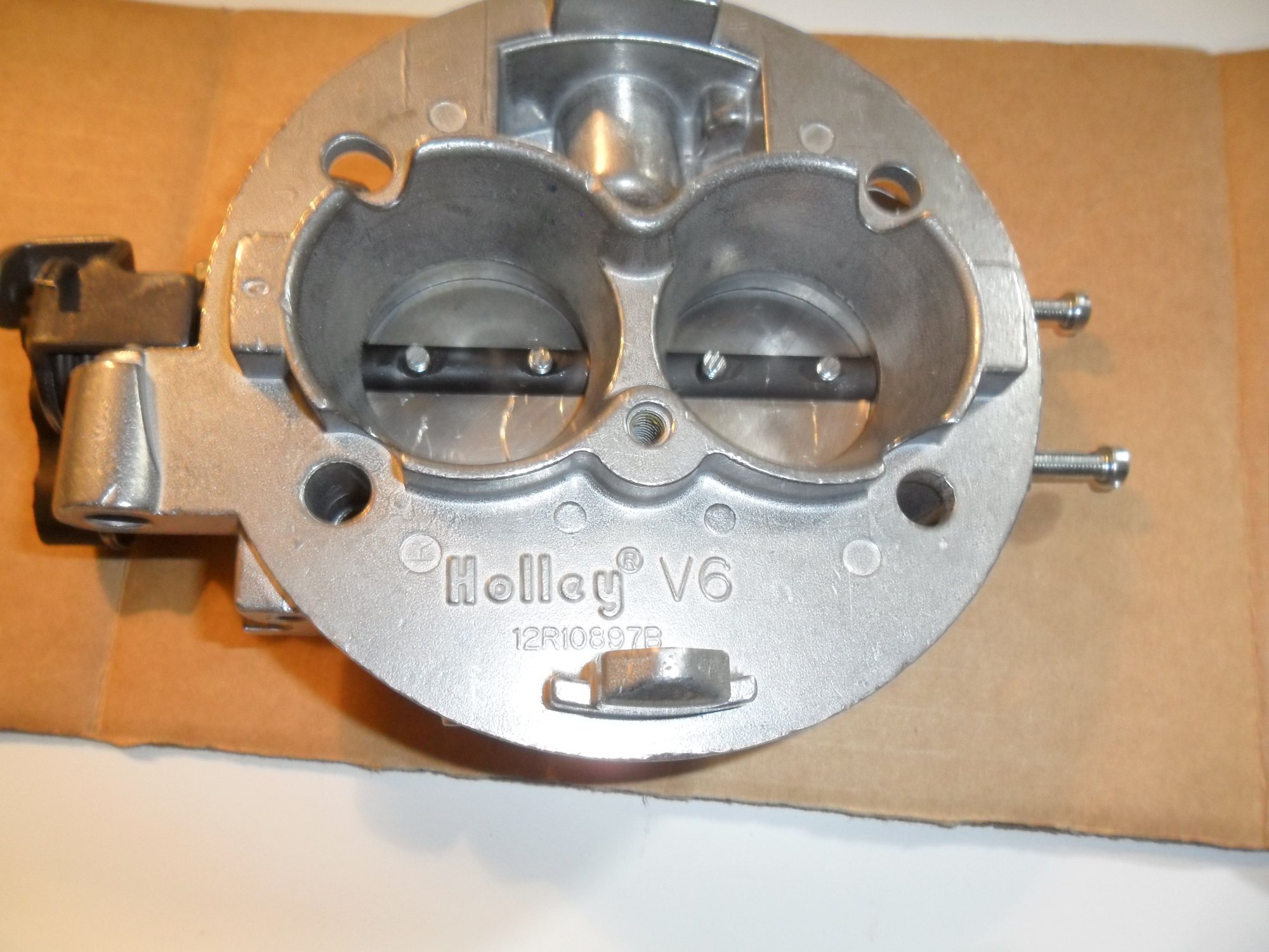

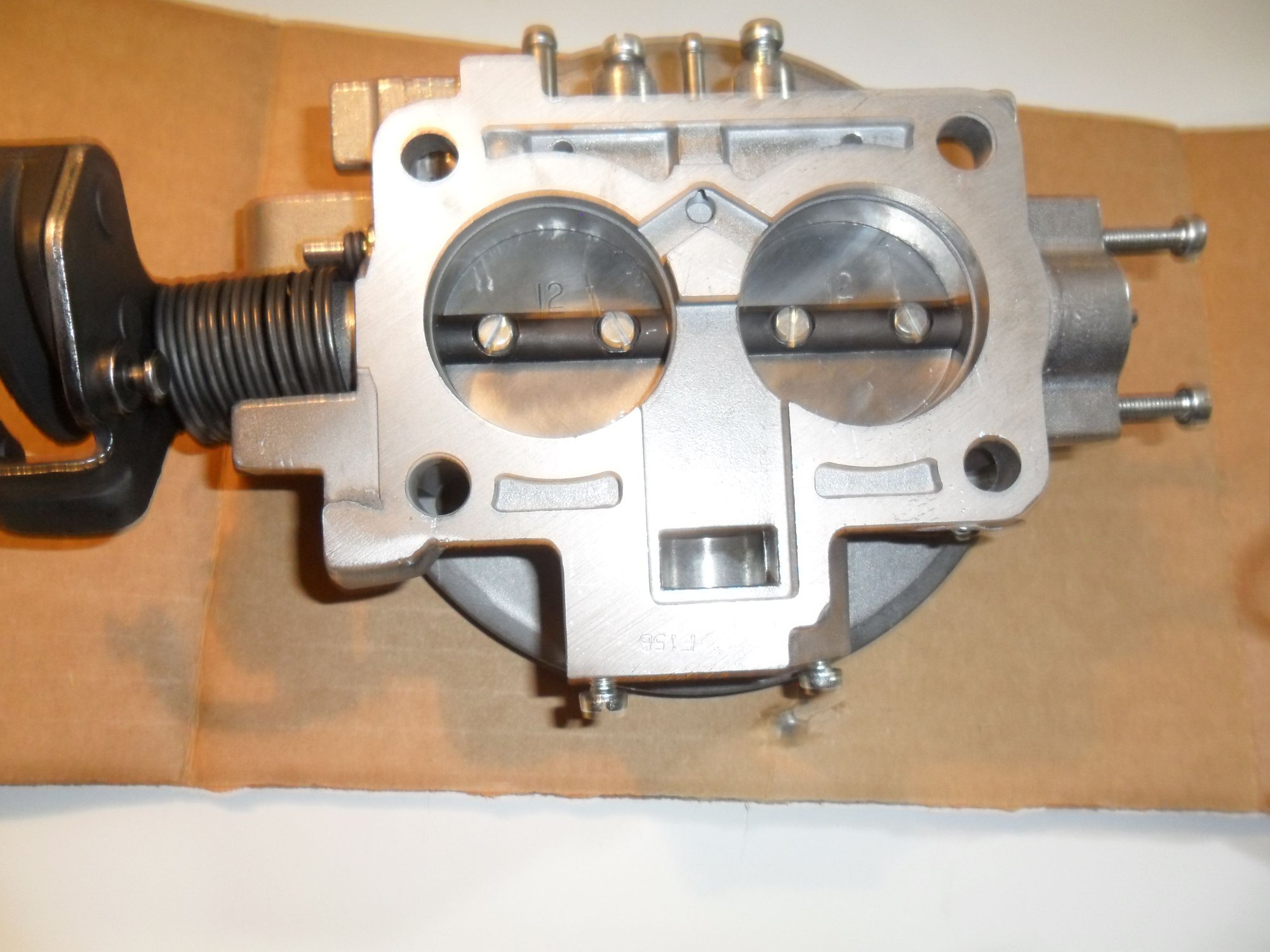

The reman Throttle Body is in today. It has all the bolts for the sensors that mount to it on it.
The butterfly is scratched on top :/ But it looks OK. I will probably get to it on Sunday.

I installed the new TB. I had to cut one TPS bolt on my old TB with my grinder as none of my drill bits would cut it. (Had it off and in the vice then clamped to a table) That left it looking iffy so I grabbed the OE one it had when I bought it and used it. Got the new TB on went through the MT2500 no code.
Weird thing when I checked the set RPM it increased the engine speed then indicated the RPMs were correctly at 800. When I went to another test the engine speed slowed down again. ????
Drove it and it seems like it is better. Tach went up to almost 4K when I was getting on the Hwy that is unusual. It didn't hesitate or feel like power was being drawn away somewhere.
I think that nagging feeling of power being lost before the TB change was the TB sucking air. I guess I'll see over time if it continues to perform better.
