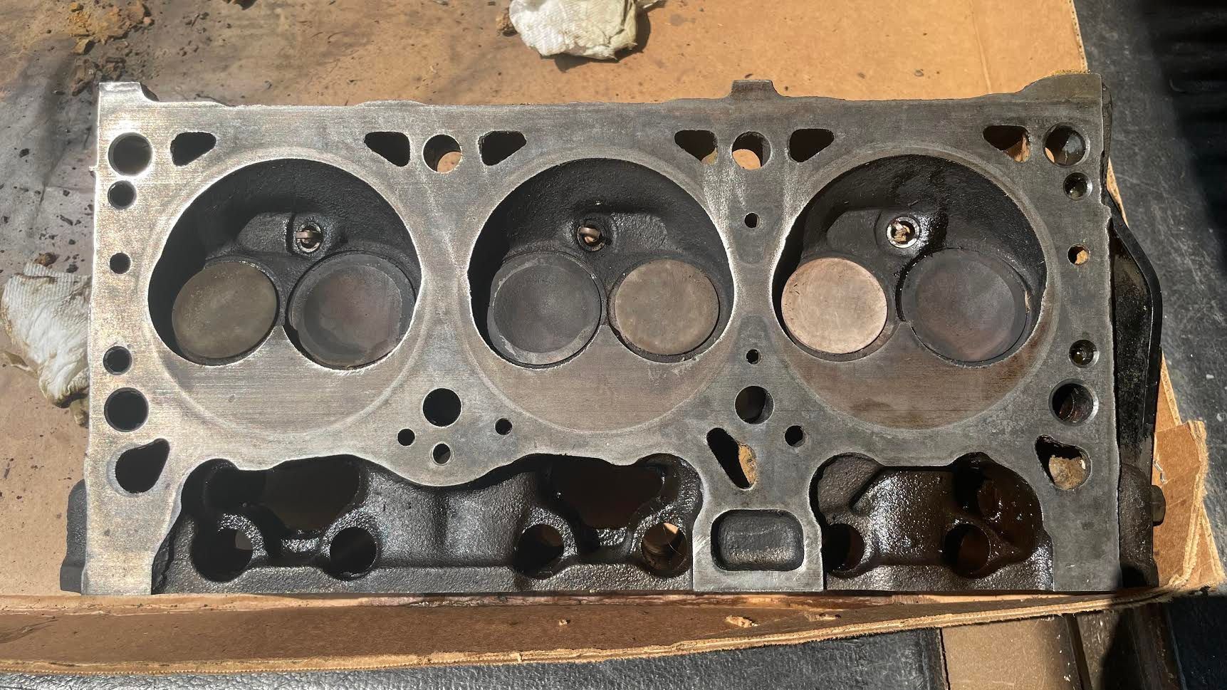

I was having some problems with the engine consuming coolant, oil/coolant contamination, and an intermittent leak at the front intake manifold gasket, along with intermittent warm surging and stumbling at startup, suspected loss of power, and poor fuel economy.
With these symptoms, I disassembled the engine, discovered the driver's side head gasket and intake manifold gaskets were bad, and replaced them with new gaskets. (Fel-Pro Head Gasket Set HS9111PT).
Driver's Side Cylinder Bank - Blown Head Gasket

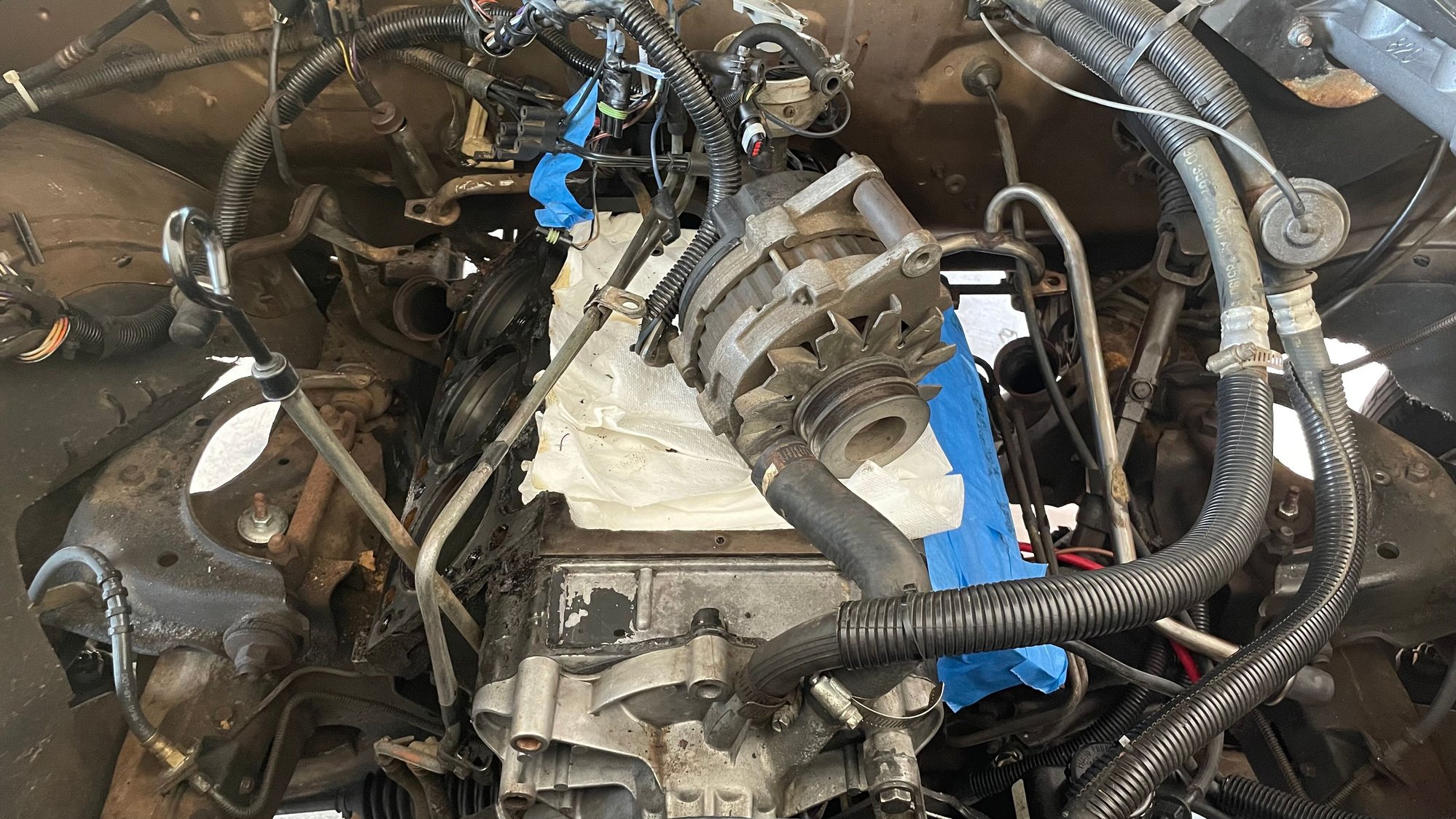

Initial Engine Teardown

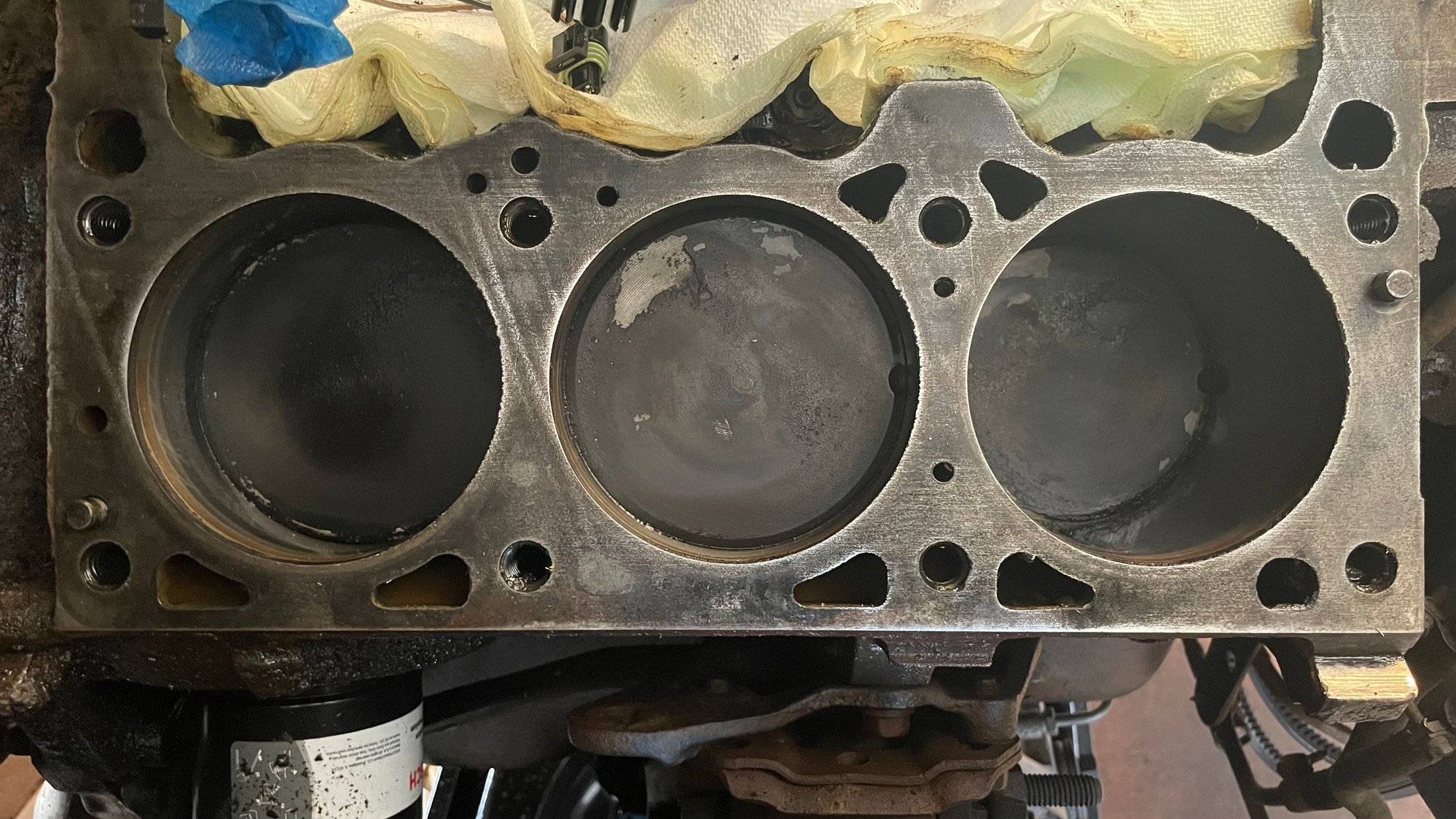

As I've said in multiple other posts, the truck was not maintained in any way, shape, or form, and the engine's condition certainly does not reflect the odometer at just under 71,000 miles. Unfortunately, I am moving in less than two weeks, making an engine swap not immediately possible, forcing myself to spend the time and effort (seven 8+ hour days in the Georgia heat with a heat index of over 100) to repair the original 3.9L LA. The vast majority of time was spent cleaning both heads, intake manifold, all gasket mating surfaces, and sludge buildup with a razor blade, parts cleaner, and degreasers. At some point, I'd like to drop the oil pan, give it a good cleaning, and replace the oil pan gaskets as they are cracked, but not to the point that they are leaking. In the meantime, I'll be increasing the frequency of oil changes as after 2,400 miles, the engine oil was black and smelled burned. I opted for Rotella T1 SAE 30 for the late summer to fall months, a change from the FRAM Conventional 10W-40 I had used last oil change. All cylinders, aside from Cylinder 5 where the head gasket was leaking, had heavy carbon buildup, and I'd imagine there is a good amount of sludge remaining in the areas I could not immediately reach, so I plan on adding Sea Foam or Marvel Mystery Oil to the fuel tank and crankcase. I'll need to find a good coolant flush as the coolant passages within the block are restricted from buildup. I discovered the exhaust manifold gaskets to be missing and have since installed new ones. Being short on time, I didn't have the ability to get the heads checked and cleaned by a machine shop, and even so, I'm not sure it would have been worth investing any more money into this engine as that money would be better spent on a rebuild and swap of another engine. I am, however, interested to see how long I can extend the life of this engine, and depending on the condition of the transmission (leaks from bellhousing and rear seal, harsh engagement), the original drivetrain.
Passenger Cylinder Bank Carbon Buildup & Preliminary Cleaning Results

Engine Reassembly
Left and right intake manifold gaskets are reversed in this picture, but were corrected before further assembly.
