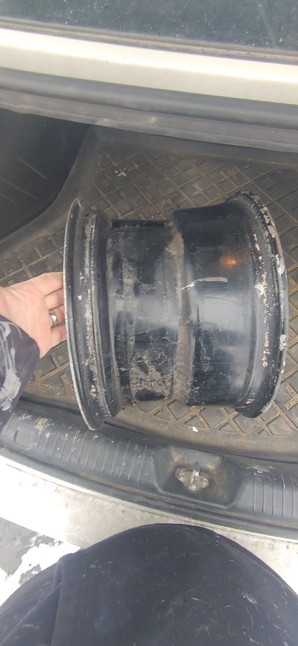

i have been searching for a set of original rims in my area. Southern Wisconsin. Have struck out many times. Either wrong bolt pattern or finding out the rims came off a ram of that era. Is there adapters for a ram to dakota . or anyone have a set of rims that would either trade or sell? Looking for original if possible.
Ram 1500 rims
Ram 1500 rim
Ram 1500 rim

The Dakota should be 6x4.5 unless its been modified. The rims pictured on the Dakota look like the ones my 92 had but it wasn't a sport. I'm not familiar enough with Dakotas to know what yours would've come factory with. Ram 1500 rims will be 5x5.5 until 2016 or so then went to 6x5.5 I believe, and if you go older into the 80s ram 150's had 5x4.5 pattern.
The star wheels pictured for a 1500 don't look factory either, aside from maybe an SST package
6x4.5 to 5x5.5 adapters should easily be had on ebay or your favorite aftermarket parts outlet
I hope the pictures aren't exact as the pattern looks offset , but adapters come with the price of having a spacer if that bothers you

I don't think I've ever seen those type of rims on a Dakota. I think I have a set somewhere, but since I haven't seen them in years, they are probably fairly deep in the pile I call a storage system. They are aluminum though from a mid 90's Dakota.
Ok . im really looking for a spare rim full size. Even if you had 4 of a set that was different that would be fine. The 1500 rims i posted are just the set i got in a trade . the 1500 rims came with the tires i needed for the dakota, i was just misinformed that the rims would fit my dakota since they are universal pattern.

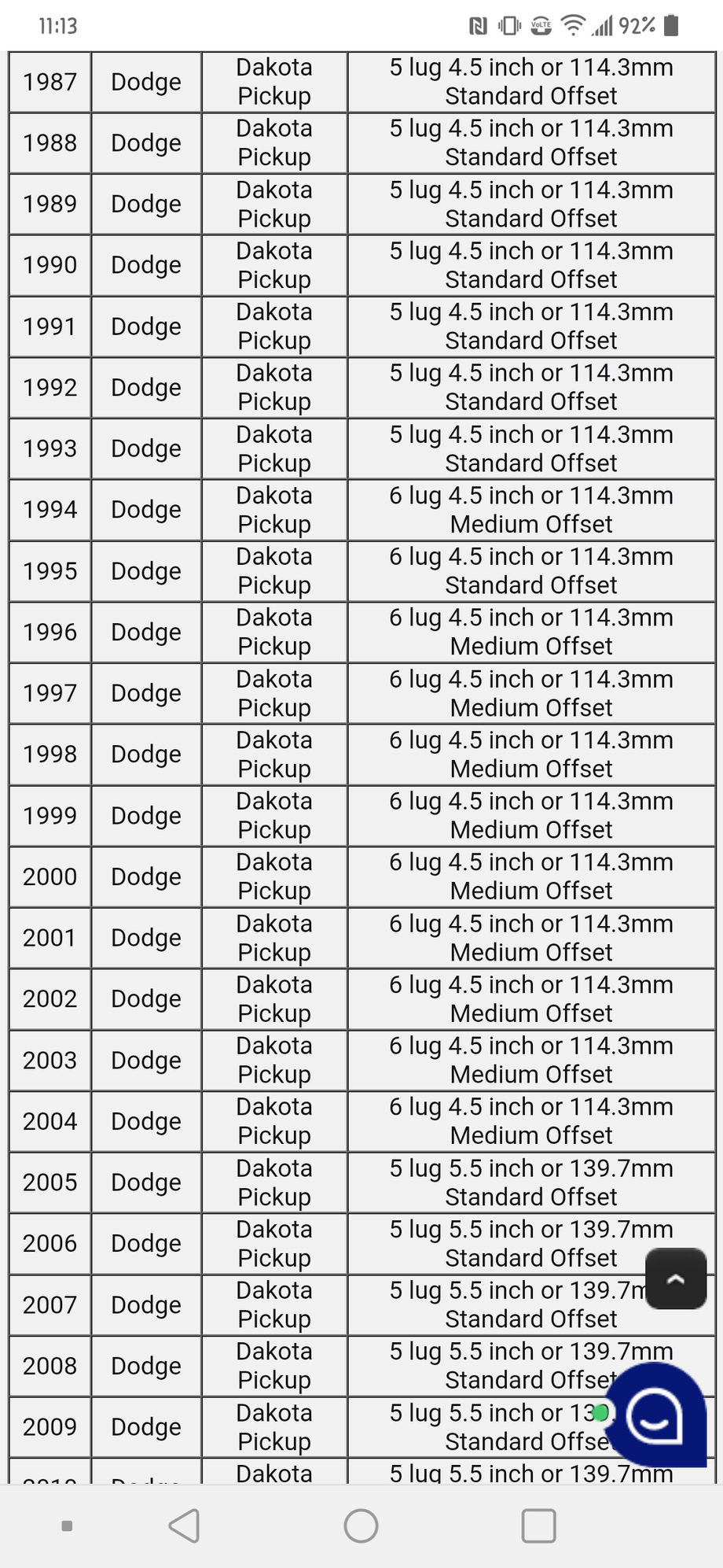

my research found this little page .

Originally Posted by Clarked90
I just received these on a trade . later i found out that the pattern was wrong for the 1500 rim. For the rim on the dakota i was told they are original from a couple different people.
i will look into the link you sent me. Thank you
The list is wrong. My '93 Dakota Sport that I bought new in 1993 had 6 lug wheels. I believe the 6 lug wheels were used starting in '92 when the Magnum engines were introduced. 1991 and earlier did have the 5 lug wheels and I think the 3rd generation Dakotas went back to 5 lugs. I think I've got a spare steel wheel wheel around somewhere. I got 4 spare wheel take offs and painted them to match my truck and ran dog dish hub caps. They were still on it when I sold it but I had one extra. I know it isn't in the pile in the garage.
