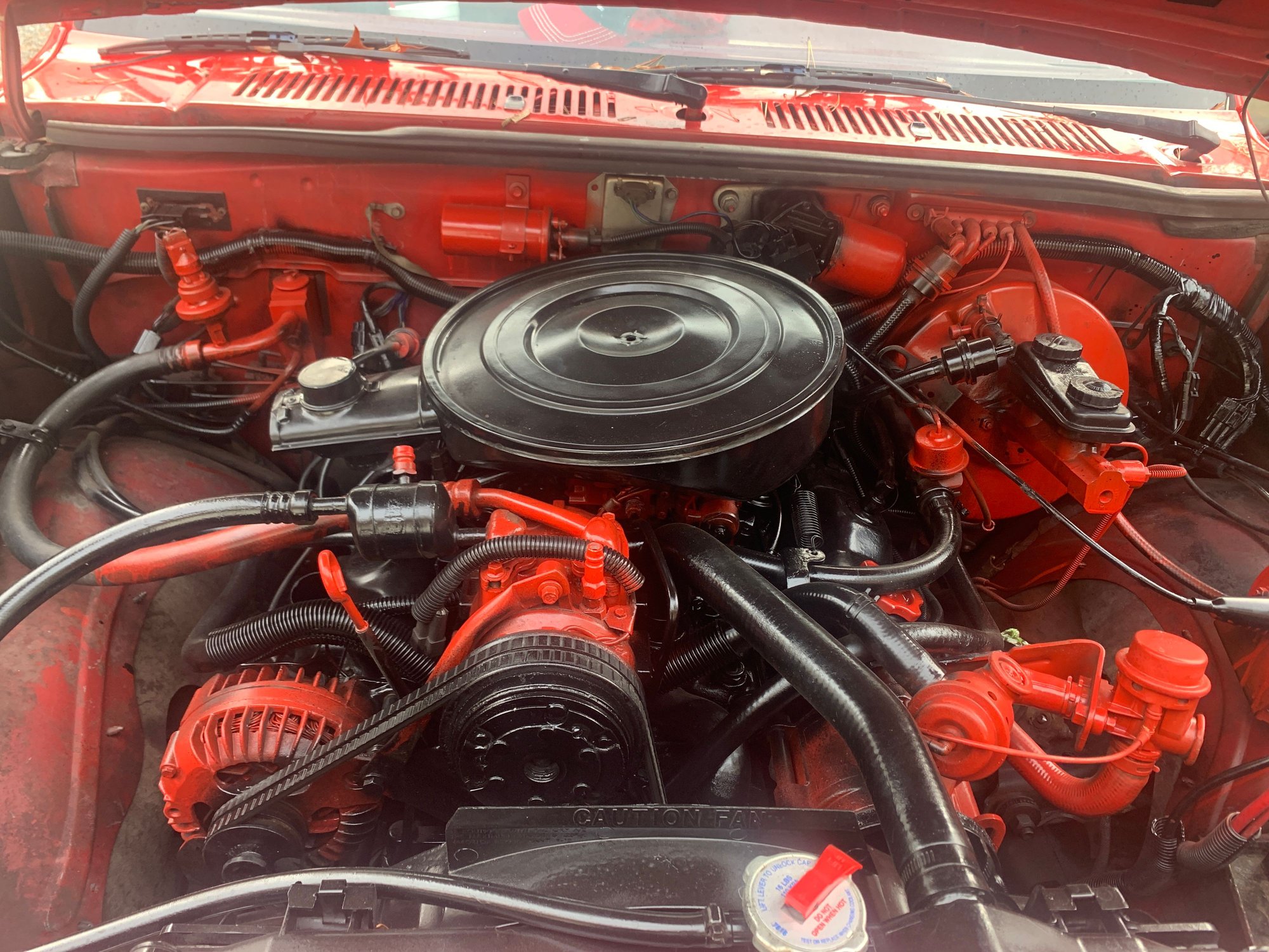

This is my 1987 dodge dakota carborated

Holy smokes, that is in NICE shape. Where do you live that it isn't just a pile of rust?
That looks like someone took their time to restore it, sort of. I wonder how lang that alternator will last with the windings panted.
