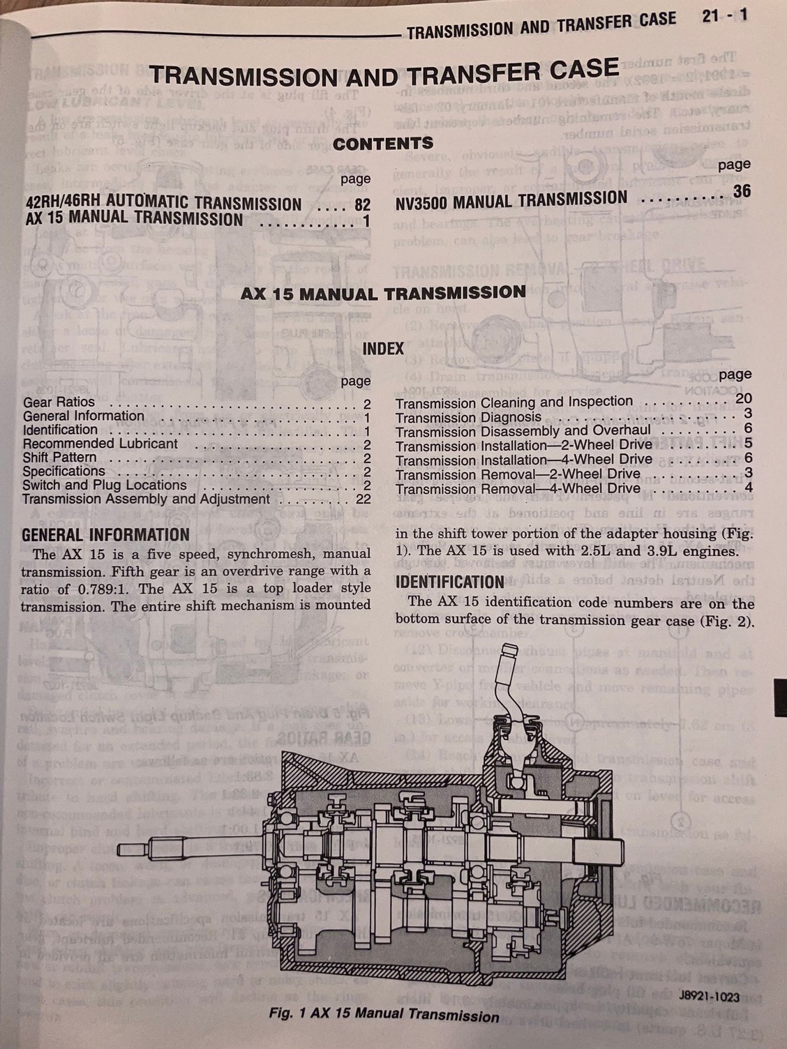

The A518 was a Chrysler 4-speed automatic transmission, also known as the 46RH, which was an evolution of the A727 transmission.
• 46RH (1988-1995): A hydraulically controlled version.
• 46RE (1996-2003): A electronically controlled version
4 Transmission are listed. The AX15 and 42RH are for (four-cylinder) Engine’s. While the 46RH and NV3500 could be paired with either (V6 or V8)
