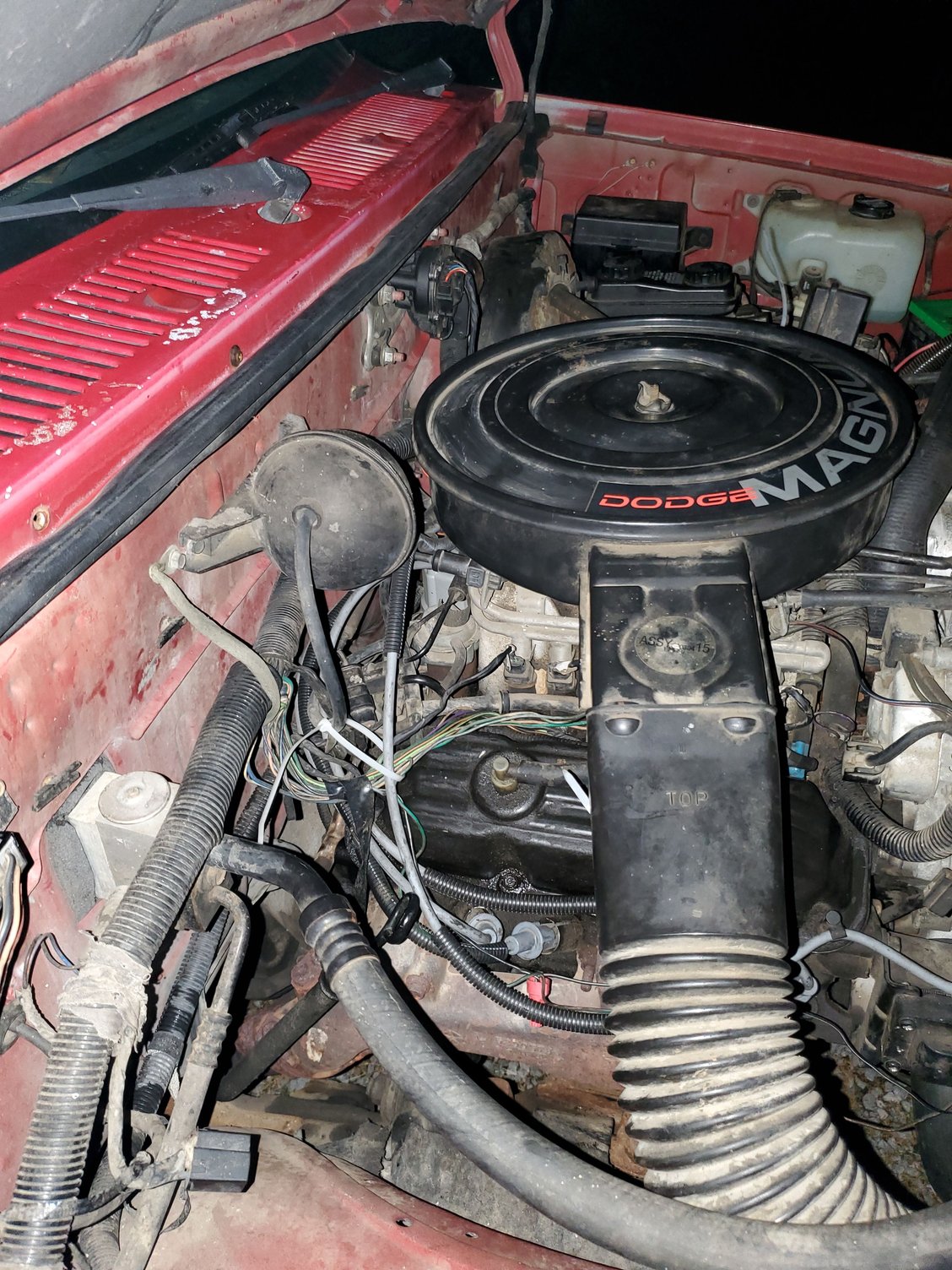

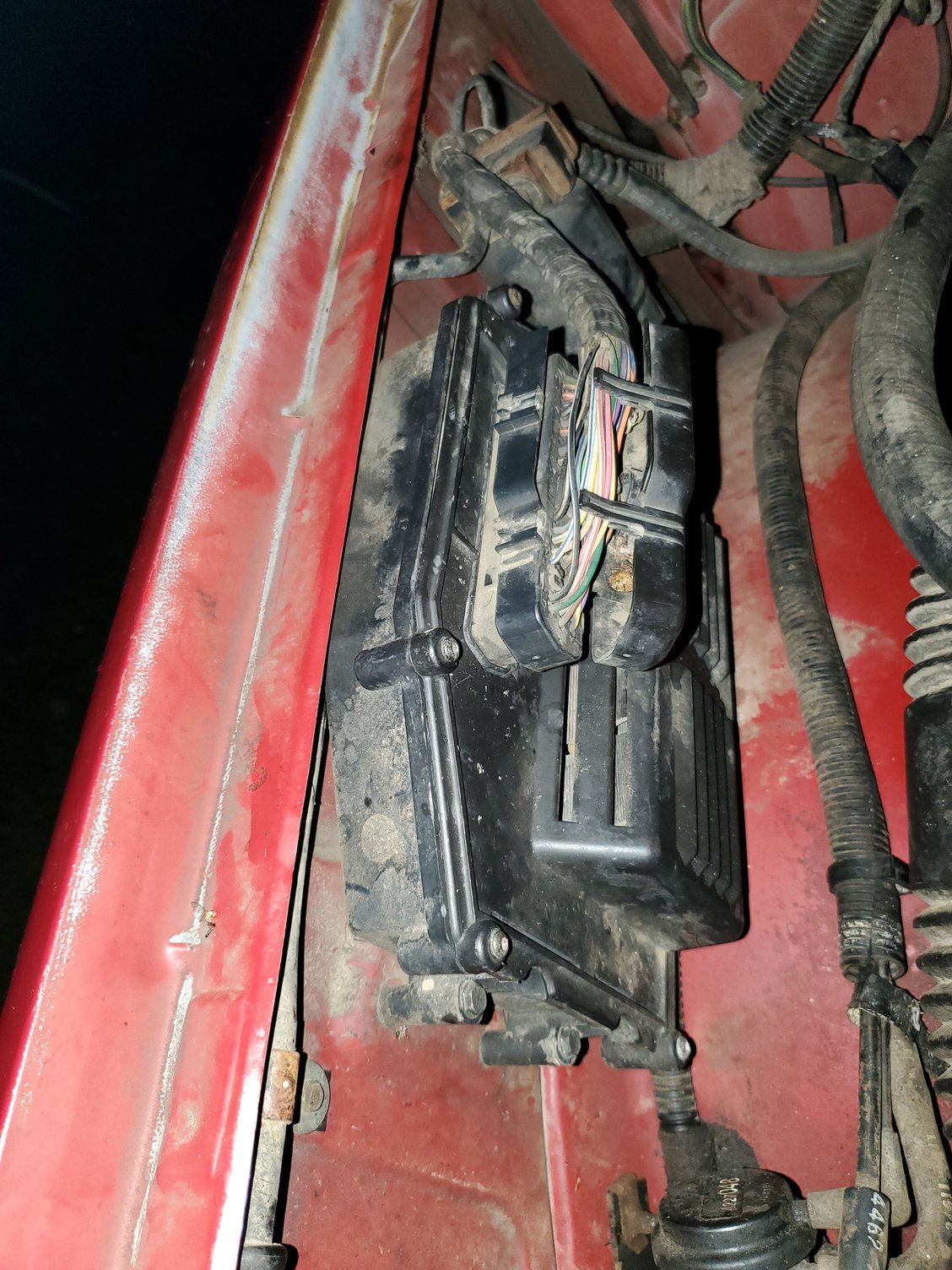

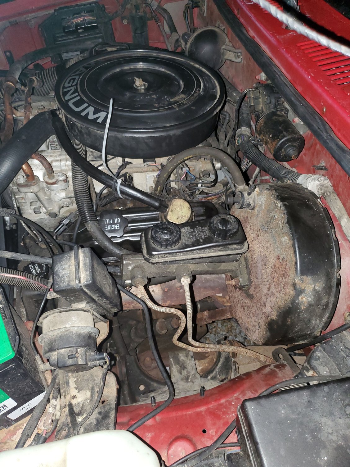

Appreciate the help honestly I guess ima have to take another look at refurbs or have mine refurbished this should be interesting being that it's my daily an im bout 95% its my pcm going wonky I did an obd with my key an check light an If I read it correctly it's telling me it's a module malfunction on top of that my truck not shifting out correctly and randomly died on me leaving the gas station for no reason but it turned over an drove home just fine on restart that's happened 2 times few other minor things Google says is prolly tcm/ecm issues which makes it a pcm issue of me in my 92 but ima go through all my wiring later today see if there's anything wrong cuz it's a jumbled tanglely mess
V6 pcm
V6 Under the hood
Passenger side
Drivers side
