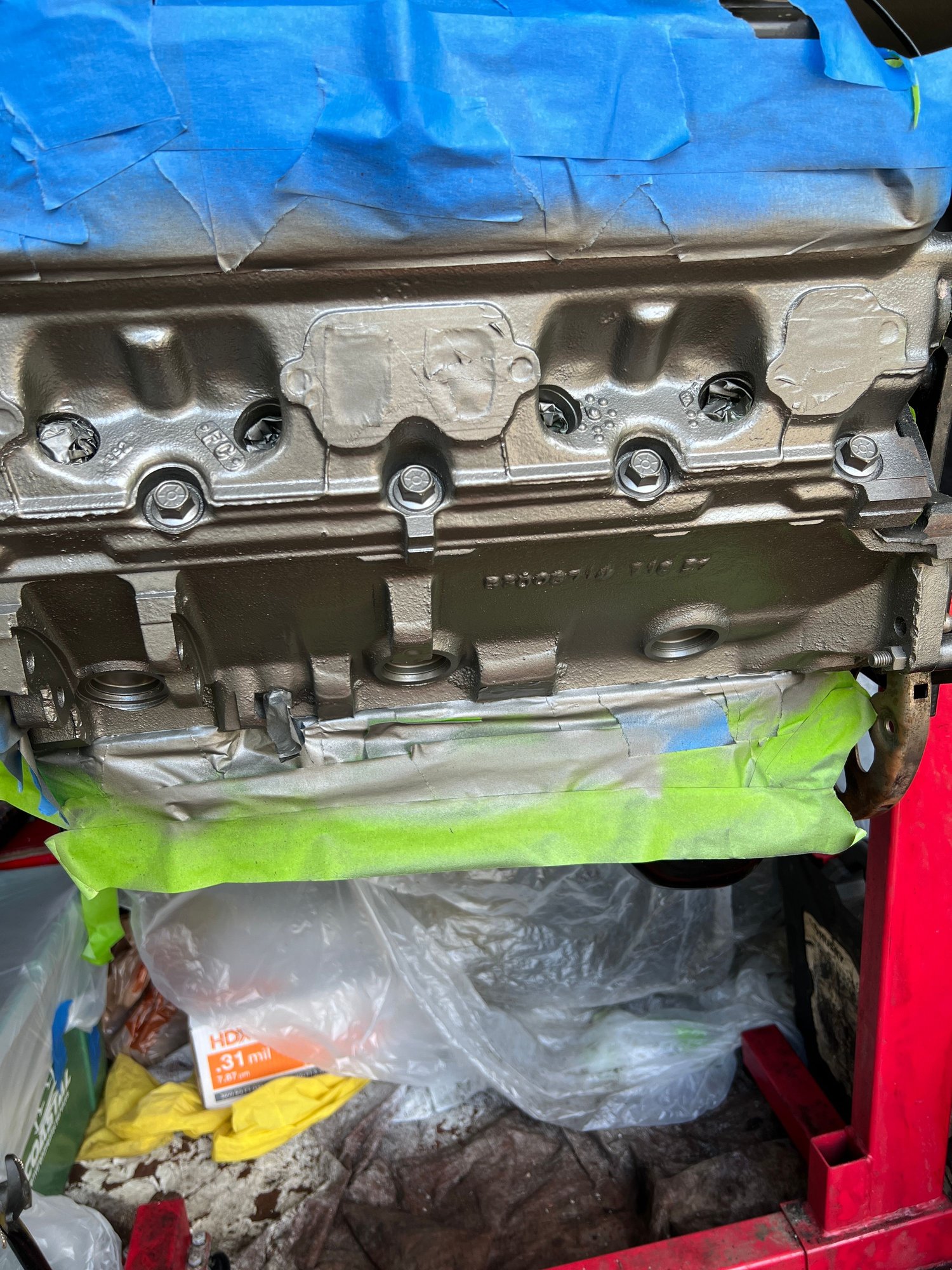

No ports in the heads only area is on the bottom part of the block and I believe it’s a drain plug it’s taped up at the bottom theirs 2 on the block one on each side
