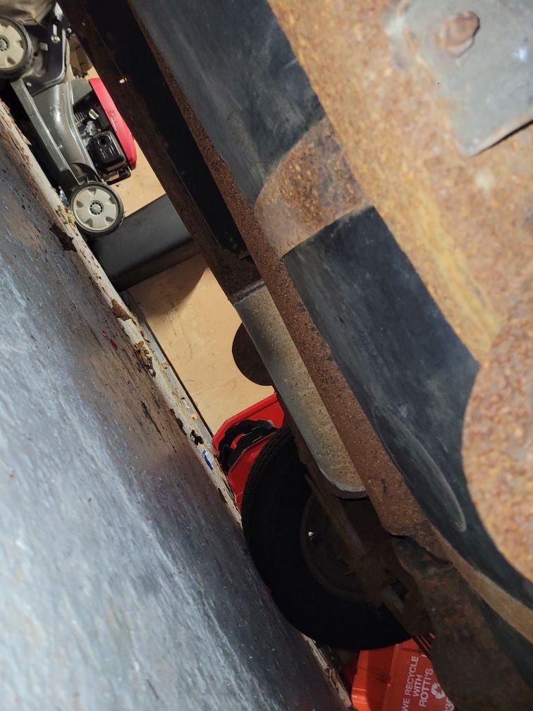

My '89 has rust holes right where the box meets the cab on the frame. Right where the frame curves upwards. That's where it's the worst. Mine used to be a farm truck in KY so it's been abused and the front of the frame must have scooped up plenty of dirt driving onto steep hills. It rusted from the inside out due to the actual SOIL I found in there. There must have been 5 handfuls of living moss I pulled out. Anyway it seems solid still. I watched a Youtube video of a guy that bought a way newer Nissan truck with a crack of rust going all the way down the frame on both sides and he beat the crap out of it (and himself) driving through a farm field, making it go airborne over and over again and there was no catastrophic "break". He even ran it into a tree and that's when the engine blew. So my train of thought is that truck frames were made of thicker steel back in the 80's/90's. I'm really 100% not worried about the rust holes in my frame, unless I had to haul something really heavy. I'd just put as much of the weight as I could over the rear axle.
If you buy the truck, a needle scaler with a rubber band and some Surface Shield should do the trick. You can't buy many decent trucks for 3500 these days! Old trucks can be money pits, you'll be nickeled and dimed by RockAuto for years to come. But that's nothing compared to newer trucks that still need repairs because they're all made in Mexico. The parts are all hundreds a piece too!
