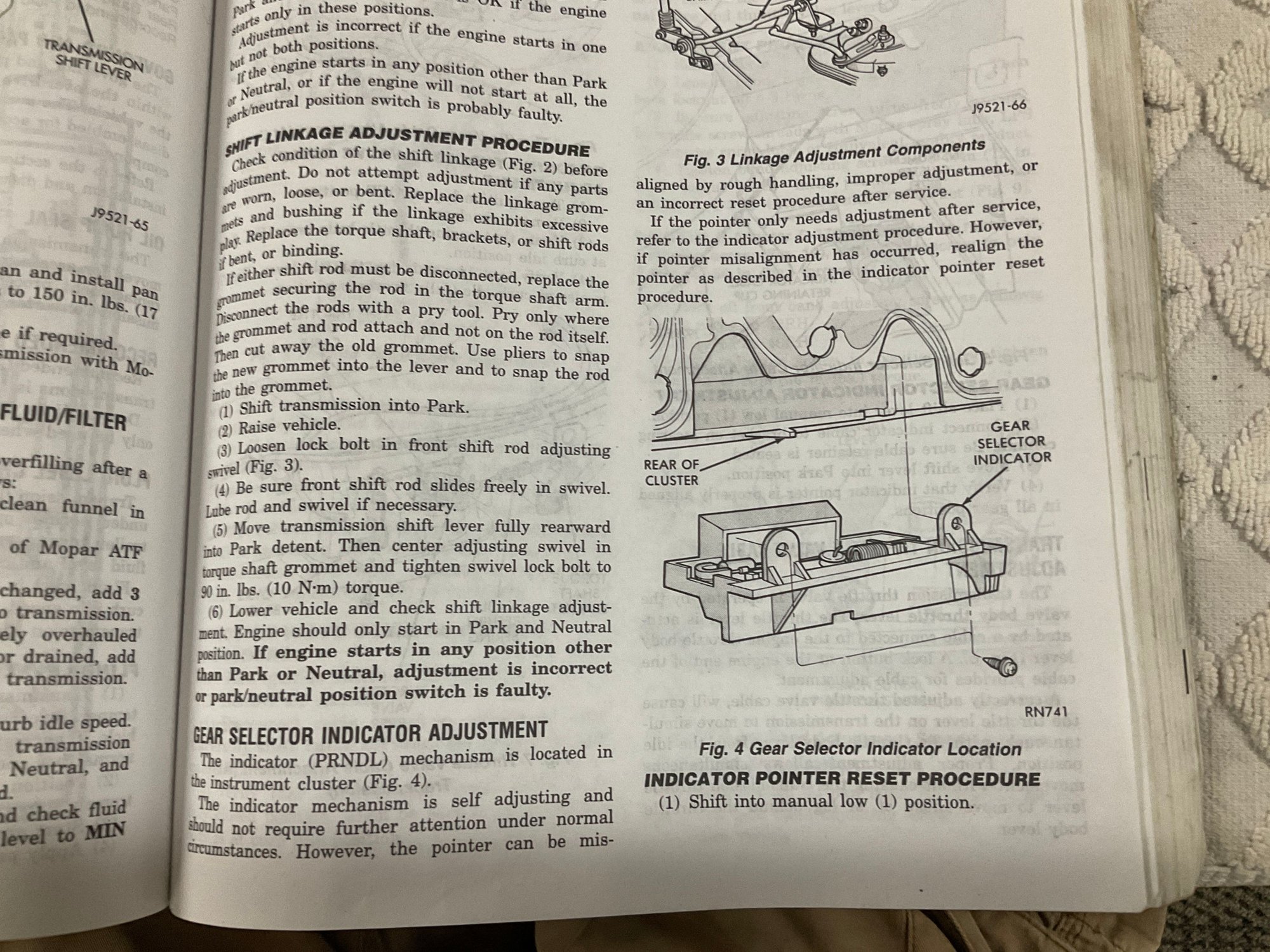

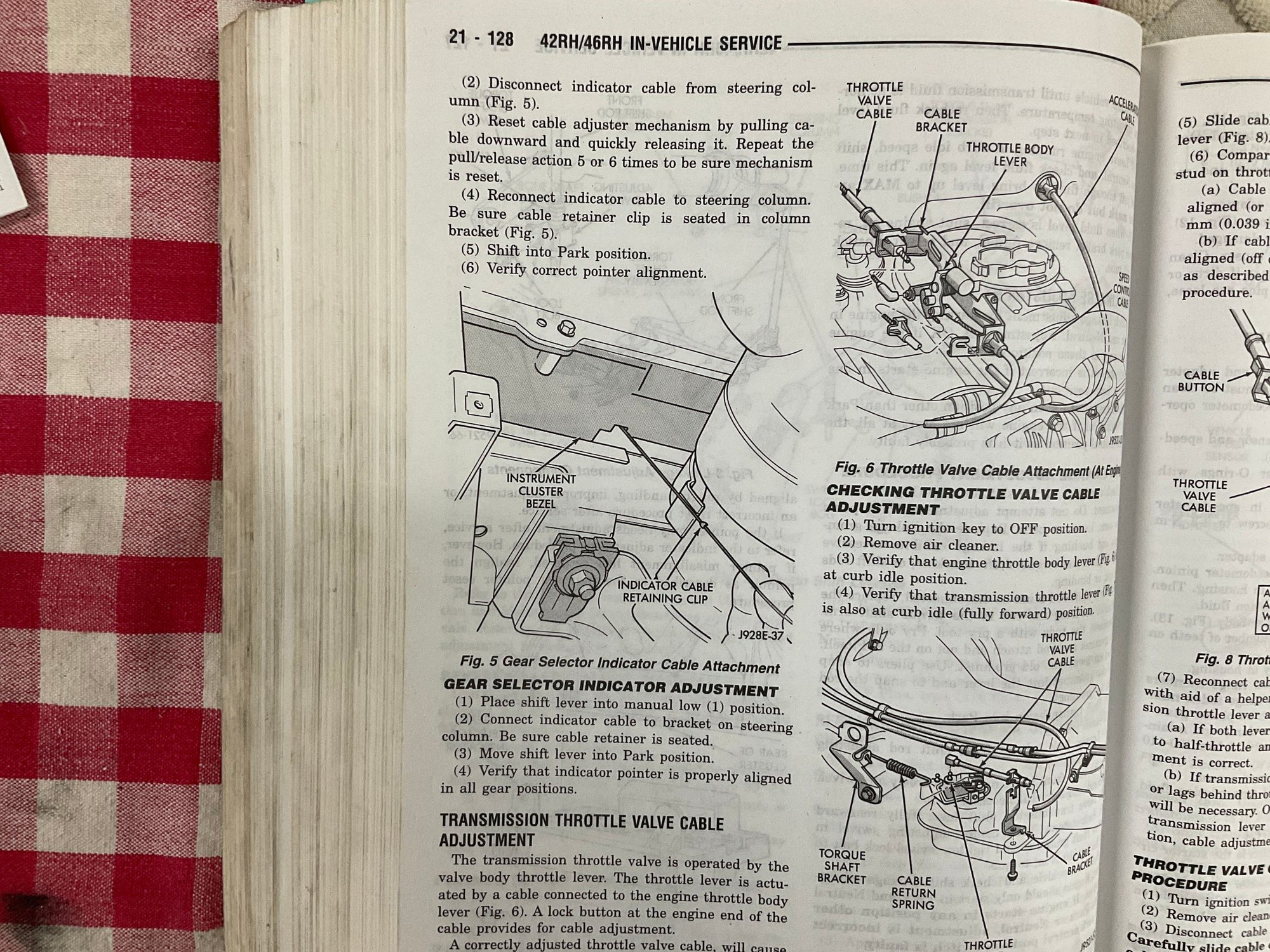

If your gear indicator is not moving, but the lever does, be sure to reconnect the wire from the instrument cluster to the bracket on the steering column.

Hello Flonderguy, we hooked the cable back up, but the cable system seems too simple. There does not appear to a guide for the cable to run on after the cable drops down from the PRND. Does the cable float in behind the steering wheel assembly for the last few inches of the cable. I can take a picture.

The cable slides into a bracket on the shifter, on the left side of the steering column. I think you need to take off the kick (knee) panel to get to it.
The first time I dropped my steering column, I didn’t disconnect that little cable and broke the wire. I had to graft on some wire to make it long enough again.
